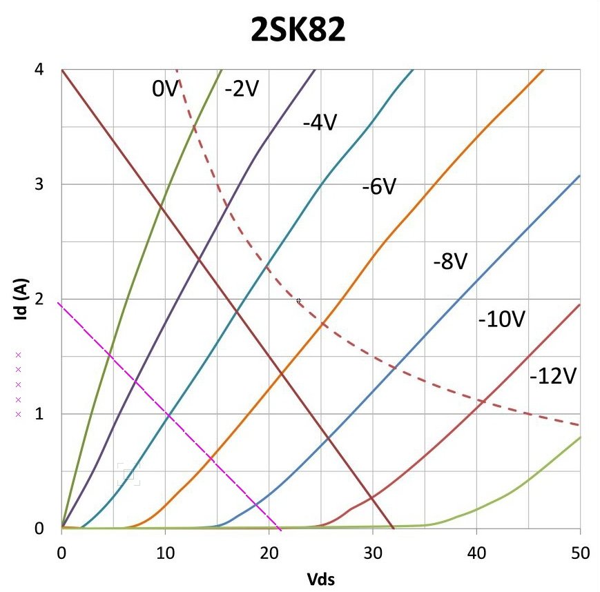

I have found a 1Henry 1A Choke that id like to use as an inductor for this amp. With the restriction of 1A current can someone help me establish an ideal operating point and the approx. output power in watts this point would produce. I just don't know how to work out the output power and gain i could get from the 2sk82 curves.

Max unclipped power due to inductor current is 0.5*(I^2)*R, so for 8 ohms you'd get only to 4 Watts max.

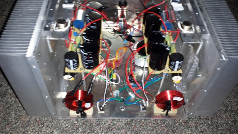

2.5 mH inductors 18 gauge .7 ohm.
It's a bit of an improvement to an already great sounding amp.
It's more quiet over all. Small details come out better.
A bit of bass added to small drivers.
The highs are more smooth now.

Power = I(rms)^2 * R, I(rms) = I(peak)/sqrt(2)
Hence Power = 0.5 * I(peak)^2 * R.
Take note that with a real 2SK82 curve and Id constraint of 1A, THD will go to the roof for power approaching 4W. I did a quick SPICE simulation, with 1A THD is around 2-3% at 1W, and around 10% approaching 4W.

Geez Thats not so good, Was the spice model if i set the device at this operaing point , Mine is the dashed loadline

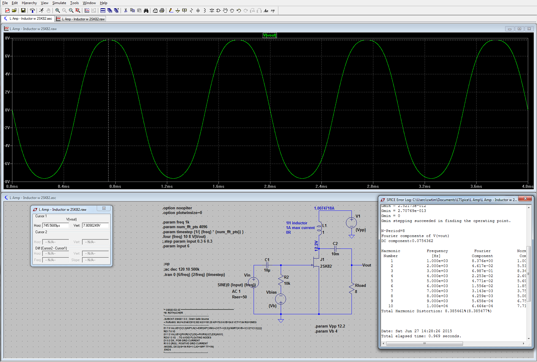

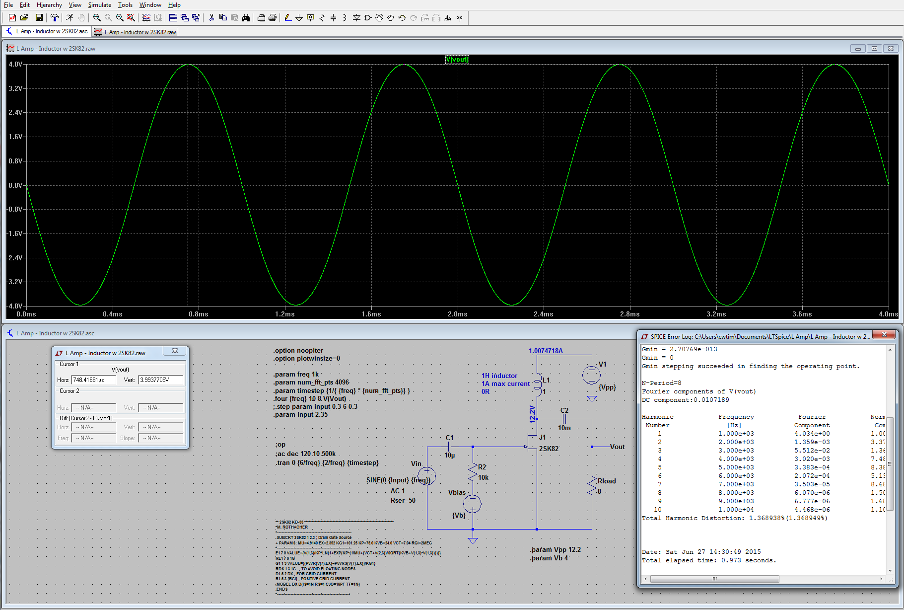

The model I used was downloaded from audiohobby.com, I set the condition closer to the operating point you chose (still not the same, as the model seems different from the curve you showed), and it performs better:
0.2W 0.26%
1.0W 1.37%
3.8W 8.38%
Attached the screenshot and the .asc file I used for the simulations.
