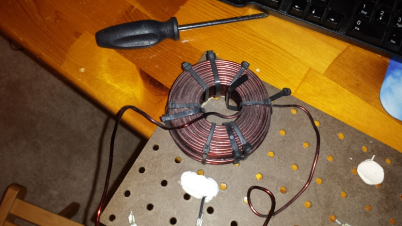

Thought I had one on hand but it's only 1.0 mH. Yabba! :D
1mH will have 0R75 reactive at 120Hz; in 240Hz is already superior to 1R alternative, so maybe is worth testing them. One alternative is: mantain the 1R resistor, in series with inductor (if dcr from inductor is not much high to loss so much voltage), and will got good results.
Alas, since LC circuits tend to resonate, damping them with an series resistance, reducing the Q factor, removes oscillatory possibilities (this is not an problem with CCS loaded amp, because SIT do not interact with supply).
The 2mH coil I used have an #12 gauge wire, and warms with the 3.2Adc drained from stereo SIT amp, reminding cooper have resistance, too:D

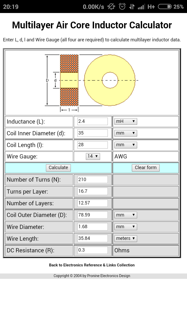

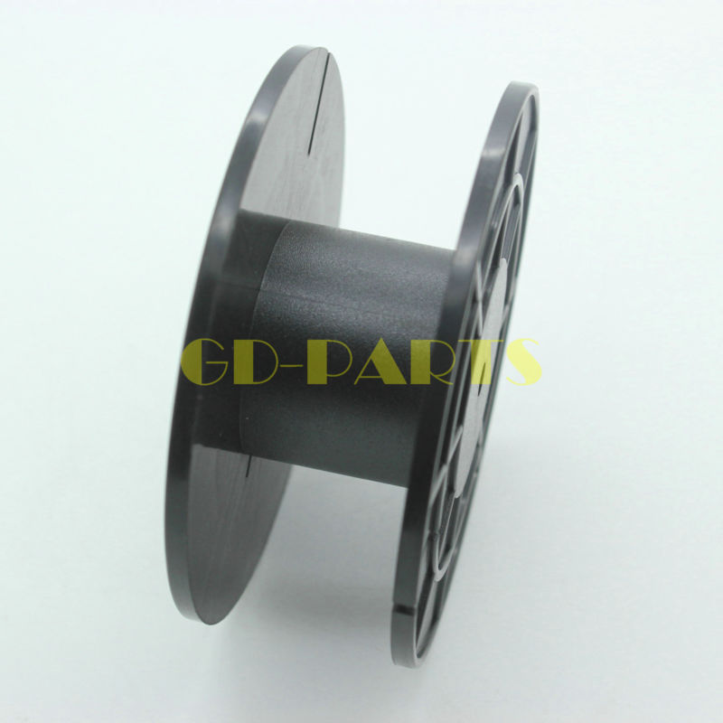

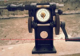

air core inductor is nice topic, i think that is the easiest compenent/part that can be build compared to resistor or capacitor.
i just ordered the machine for handwound, also plastic bobbin 80x32mm. it seems that i can get 2mH with 14awg, it's time to play with it
