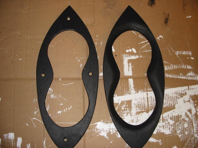

In the last couple of days, I have sanded, filled, sanded, filled, sanded, filled and sanded. All this time using the straight edge and whatever else to keep things under control.
Then I painted, sanded, painted, sanded, painted. Things were going well.
Then I made the mistake of bringing them into the shop, under the lights where I could see the finish in there rather than under natural light.
Uh, oh...
Now I see why you want to put a piece of 1/8" over the curve.
Good lesson for the big set.

I was wondering when you would discover that all that edge grain has its problems. I was going to say something earlier, but decided to let you find out for yourself.
I had similar problems with "Stacks", I tried a smooth finish on them, and no matter how many layers of car body filler I used, you could still see the layers underneath once the gloss went on.
They are now finished in a hammered metal paint that does the job beautifully. This sort of finish is one option you could consider.
Have you considered a veneer, or very bendy ply? Those curves are going to have issues if you try to put on a layer of 1/8"ply.
Three more coats of paint and I'm getting closer Andy. Them there edges are starting to disappear.
I think by the time I'm done it'll be close to two litres of paint on these puppies. I noticed they're quite a bit heavier now.
The finish I will use is called Stone something or other and is a just a boutique version of truck bed liner. I've used it on the last few sets and it's good. It helps look after my woodworking skills. Only problem is it takes about two weeks to dry.
I will strongly consider a cover piece for the edges on the next set.

The entertainment industry has three grades of luaun available. plain, primed and paper faced. The plain has the interesting rotary sawn grain which might be interesting in a project. The primed was neither here nor there in price or performance. The paper faced, a thin sheet of paper laminated on the good side, though more expensive, required the least prep getting into paint. I also have had end grain showing through finish coats. I'll have to do an experiment with paper laminate and get back to you all...
Without lots of gap filling glue, any laminate rigid enough to not follow every peak and valley the belt sander carefully laid down will be sitting on the peaks bridging the valleys. Though acceptable in built ins and some furniture, I would think these to be the worst form of voids possible in a speaker. This isn't an indictment of laminate or veneer. Just an observation that laminate or veneer shouldn't alter the contours of the substrate.
A large diameter dowel with a cut fine beltsander belt glued to it (cut on the pesky seam in the belt), or two half sheets of fine paper glued on, should make a sander long enough not to dig in and still follow the curvature. The sander should reach front edge to back edge of the speaker. Okay, we're hand sanding here, but you can here the music as you work...

I love epoxy but I didn't think I needed it. I painted on the glue with a brush so it kind of acted as a filler for the rough plywood. Worked like a charm and oozed everywhere. The two cabinets used almost two litres of the stuff. I just didn't think with all the glue and screws used to laminate it that I would have to worry about strength of the bond.
I think I would use epoxy for high strength stuff like good wholesome Canadian made canoes. (right Scott?)
All sanding is now complete. Two texture coats applied this afternoon. Grilles have been clothed. Will post pics later.
