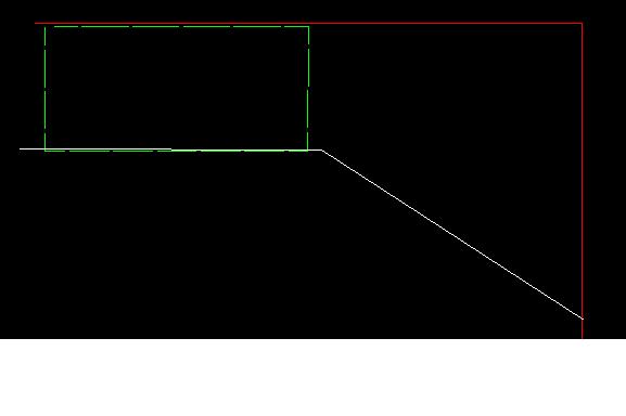

mono bass off centre
> Why not use 1 'normal' lab with a flare extension mono up to 80 Hz ? (Same amount of drivers, less woodwork)
Good idea ~ but my wife has just vetoed putting it in the centre of the back wall (1/ 4 loading).
So how do people feel it would be, having a single Lab over about 30 – 90 Hz, firing into a corner on one side of the room? Ie mono (should be no problem) but off centre.

> Anyway, seems to me that a folded corner horn that runs from ~floor to ceiling would be the way to get some semblance of WAF and 'stereo' subs. The top of the mouth could be designed to be the mounting shelf for the other horns.
I was about to write, ok, interesting, but have you thoughts on any of the designs I mentioned (I’m interested if you do)
– then I thought, mmm the horn could be sited with wall height of 10 feet/ 3.2 m.
Maybe that allows a horn with a few less foldings than the “box” folded horn designs I was considering? Or other benefits (eg go a little higher)?
I keep thinking of Pass’s El-Pipe-O, but that’s I recall a transmission line.
Anyone know of longer (eg 10 feet/ 3.2 m) bass horn designs on the web?

GM - you are a
Again you’ve triggered me rethinking the room layout , with either a long straight horn in the centre (1/4 loading, but no bass offset), or as you say in the corner behind a door (that I’d thought oif as almost dead space) - I think I can squeeze about 300 mm ie 12”, but height and depth are pretty well unrestricted.
A straight horn would still I think be simpler to build, though a two fold design can’t be too hard.
Do you know any links to a two fold or triangular design?

an earlier delay compensation comment got me thinking.
If delay due to very long horns becomes a problem and the electronics might have difficulty correcting it, might it be better to shorten the horn?
My sub base horn project is just about to start and the flare doubles in area each 1.4m along the centre line. If I put in 2 drivers then the throat is twice as big and the horn is 1.4m shorter but if I put in 4 drivers then it will be 2.8m shorter.
I do not need the power requirement for a domestic system so this seems wasteful but maybe the pay off will be reduced delay and thereby better sound.
Comments welcome.
Comments welcome.
