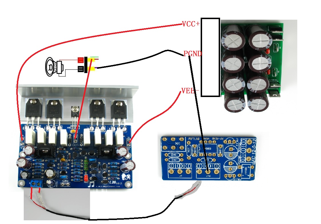

Connection diagram
P7MINI + L20VER9

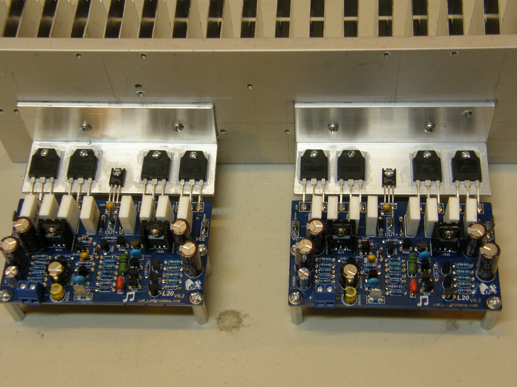

Can you please advise on this issue? I finished putting together the L20 V9.2 boards, and only one channel works. The right channel, without any load, heats up very quickly, even though it's only powered by 36 volts rails, so the board has some fault that I can't detect. This is the second board that's doing this, so I'm having a lot of trouble building a stereo set. This is my 5th amp, so I know how to solder and build amps. I don't know what type of quality control goes into your process, but I had to buy 3 L7 boards to get 2 good ones, and the same crap is happening with the L20 boards. By the way, I got these from zoe_tsang.
L20V9
Make sure there is no electrical connection to the heat sink bracket as in transistor legs touching or missing/punctured heat sink washers. Watch out for long DC leads and speaker leads dangling close to the PCB. Having built several of these I have had similar problems and it usually indicates one or more of the output devices has fried. Once you get them going they sound very good. I have used 73V DC rails but settled on 56V's. My PCB's were purchased already assembled, all I needed to do was fit to heat sinks and connect PS etc.
David,
I do religious continuity testing after mounting the MOSFETs on the heatsink, so I'm quite sure that they don't touch at all. The legs are bent so there are at least a 2mm gap from the heatsink. I may have to resort to buying assembled boards, but this is upsetting me to no end, when you can't control what is sold to you. I can see from this thread that people are working around the problems, when ljm_ljm should be providing the solutions. Thanks for your help.
Hong
I bought one unassembled and after mounting to a heatsink I used a multi meter set to short test and tested all transistor legs to heat sink to make sure there was no contact.
Are all the transistors getting hot at the same time or just one?
Before assembly I tested every transistor to make sure none were duds.
