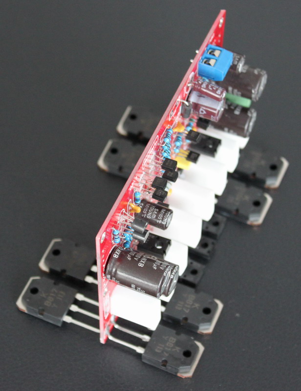

This was asked early in the thread and you can probably see that extra devices can be fitted below the board - as required. See posts #1-14.....The schematic kept showing 3EF with 4 pairs of output transistor, but the picture of the pcb kept showing two pairs...
Ha ha!!! I must be blind!! I still did not see it reading 30 posts from the first.
Anyway, you mean they just parallel another transistor onto the original 4? If so, won't that be dangerous of oscillation and/or current hogging as they share the same base stop and emitter resistor.

No simple parallel connected transistors. There are 8 emitter resistors on the PCB. So the special mounting is only for space savings.
Sajti
Sajti
B: yes. This is a very simple structure.
It can make the transistor, closer with the voltage amplification signal pipe.
A shorter distance of wire
This higher frequency more stable work.
