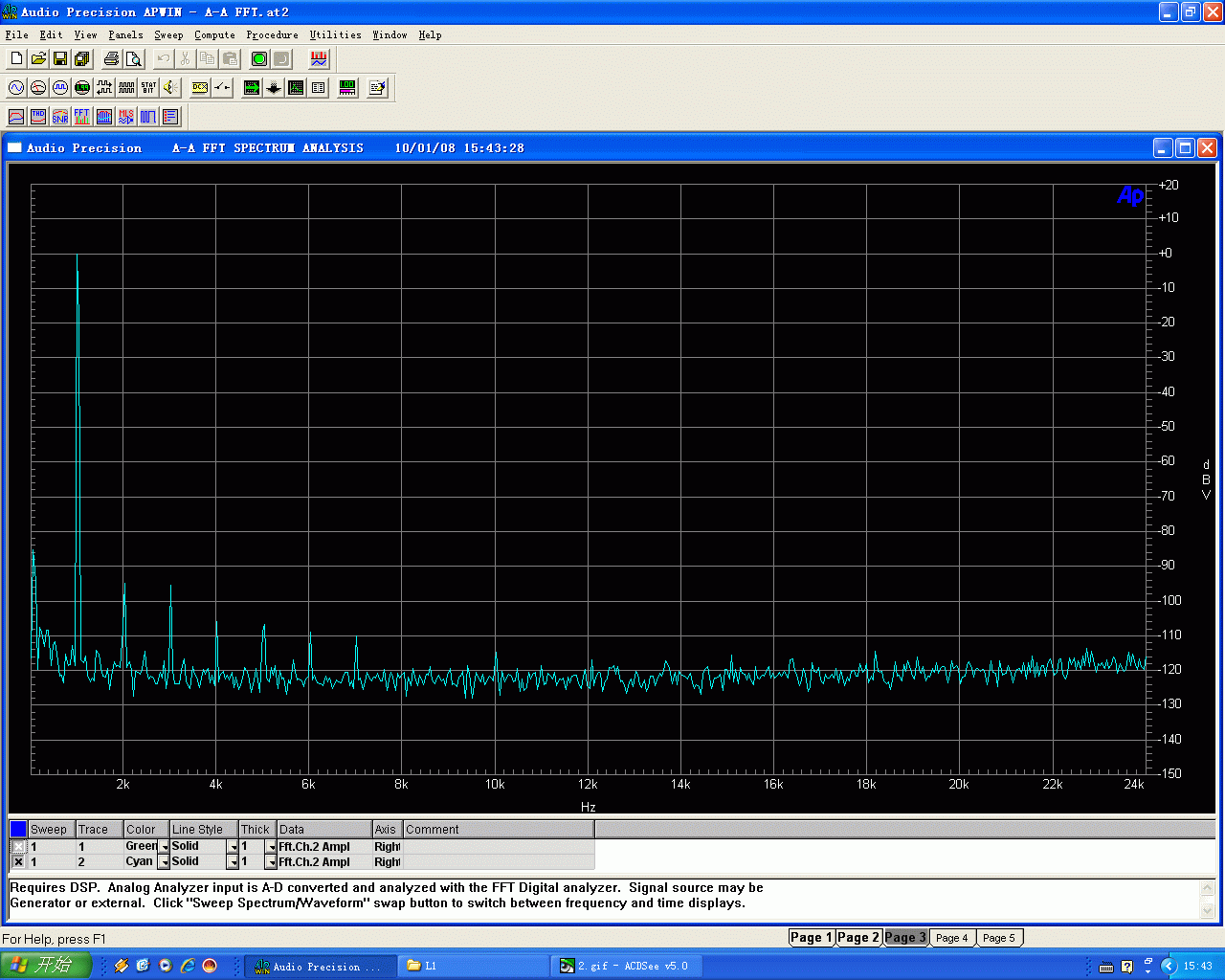

When a good CRC power supply is used, the result changes signifficantly. (Just look at the graph below, provided by the seller himself). It is true that the boars can achieve relatively low THD values, but one should observe the entire frequency domain to find the reason for bad low frequency response. To illustrate this, I have shown the sellers own measurements. The seller slylly has shown frequency response in a linear graph, but the deficiency is still obvious, though, hidden. Just look at the region below 1KHz, very small but still revealing the problem. Noise is prohibitively high and +N component is not shown fair enough. Why?

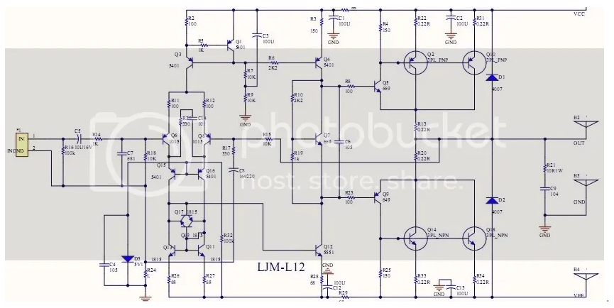

can you see the schematic and wiring of the board itself?
P.S. at the beginning of the topic there is a diagram, there are also comments by the author that contradict the diagram ...

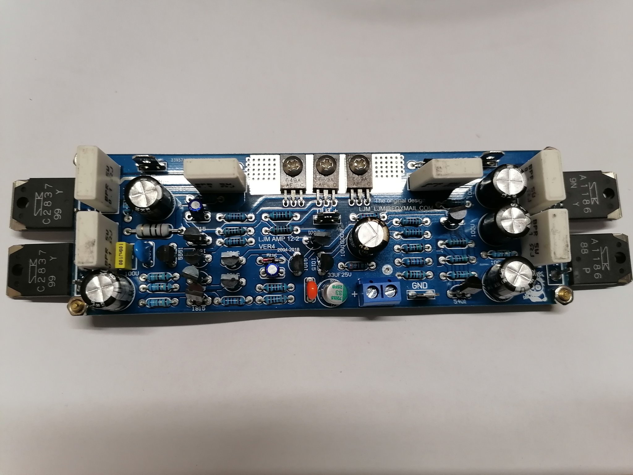

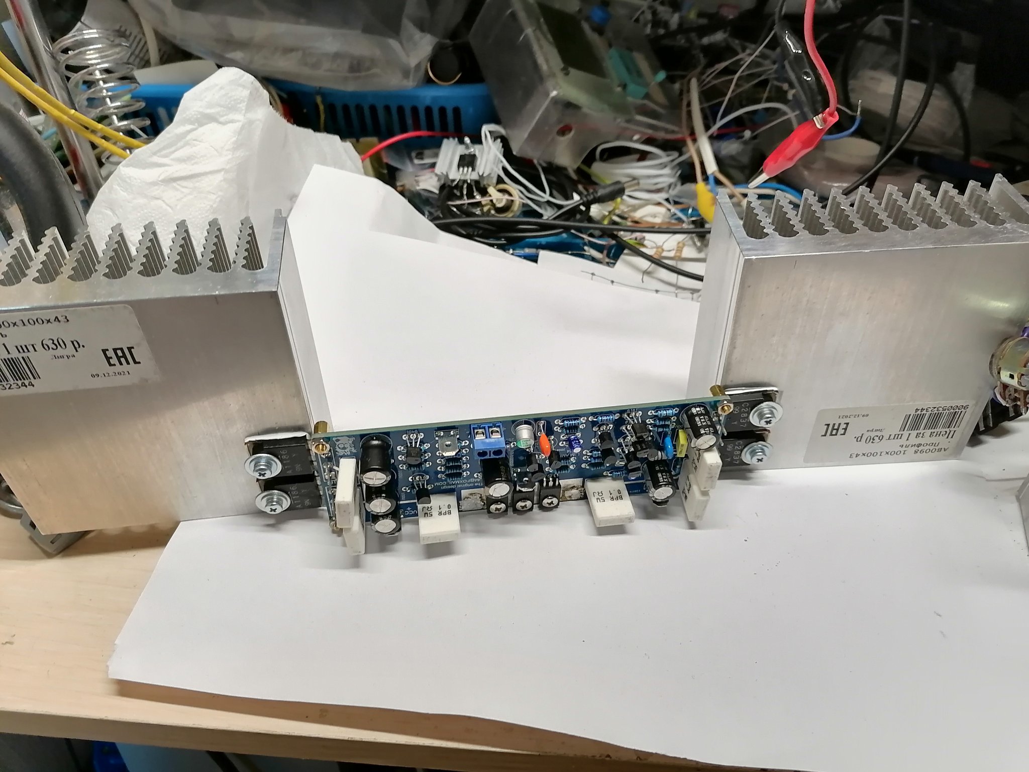

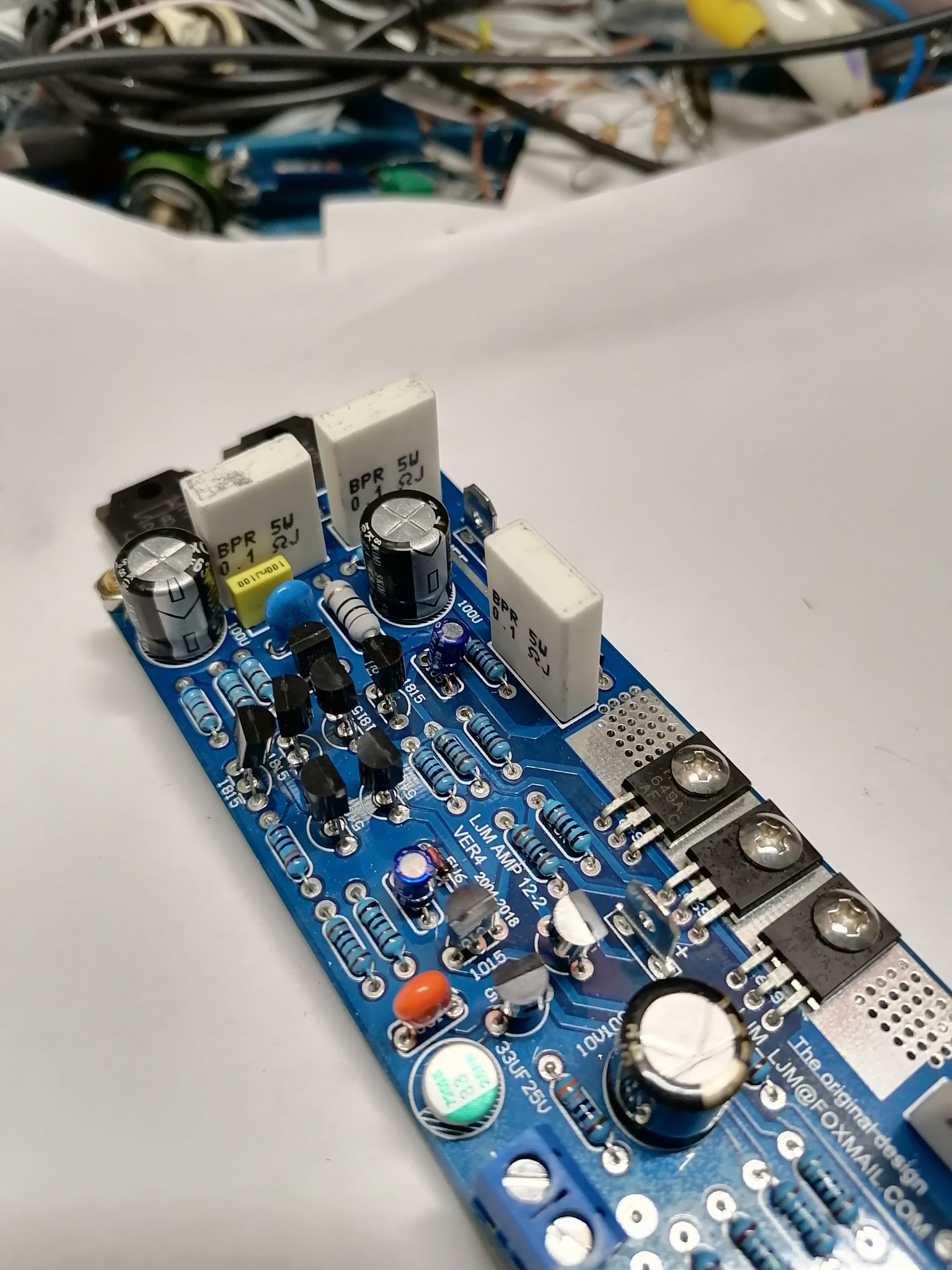

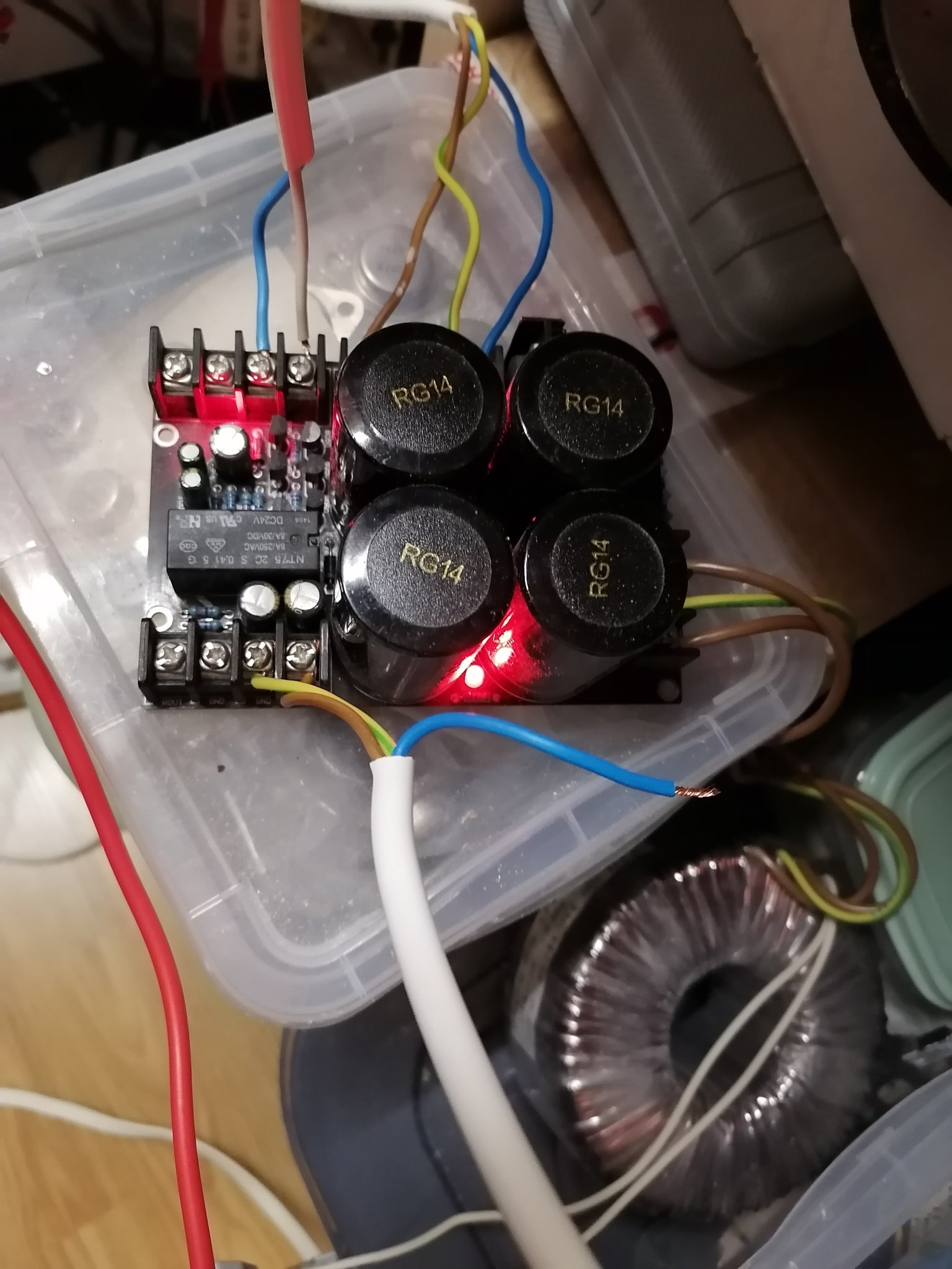

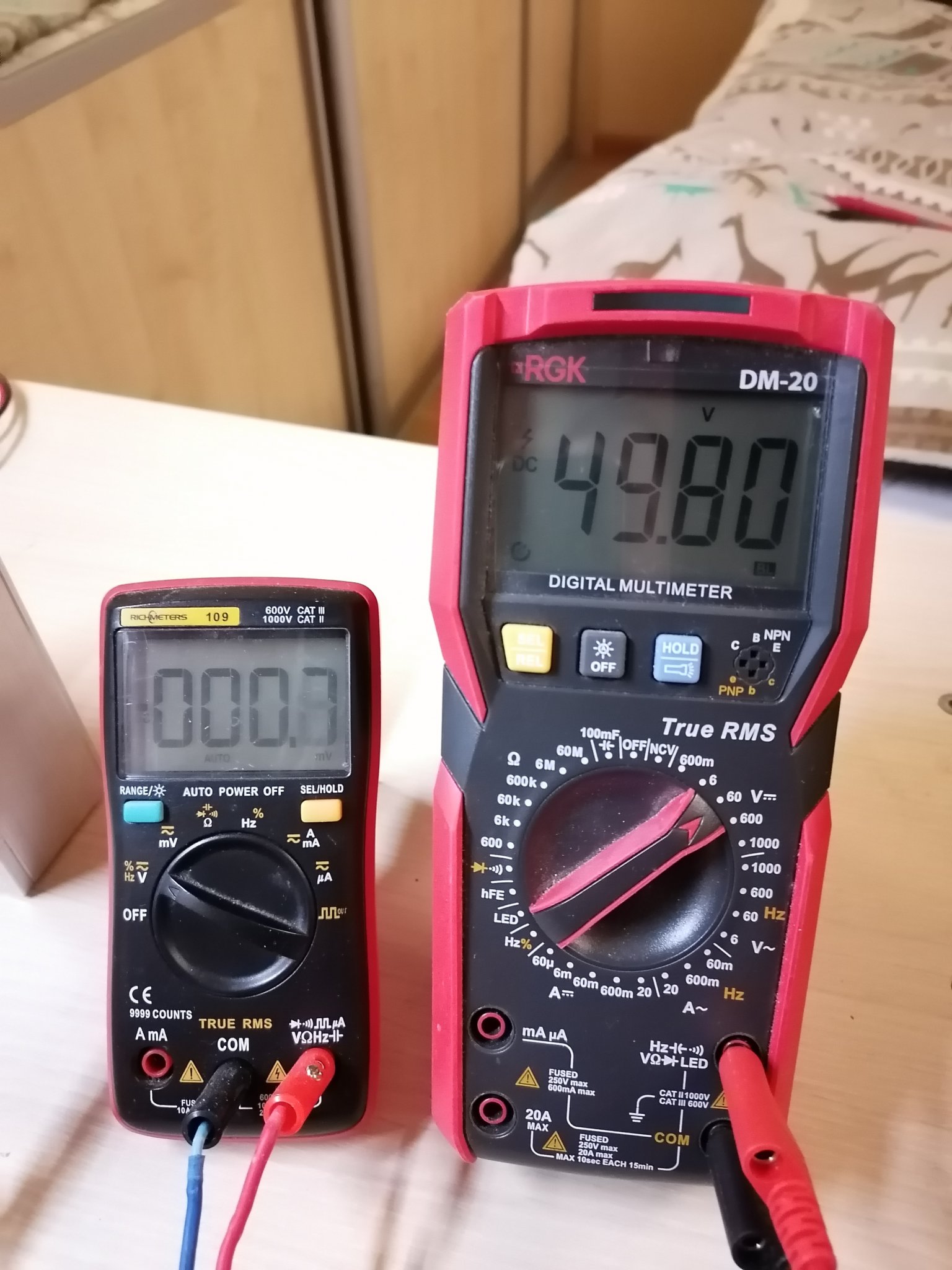

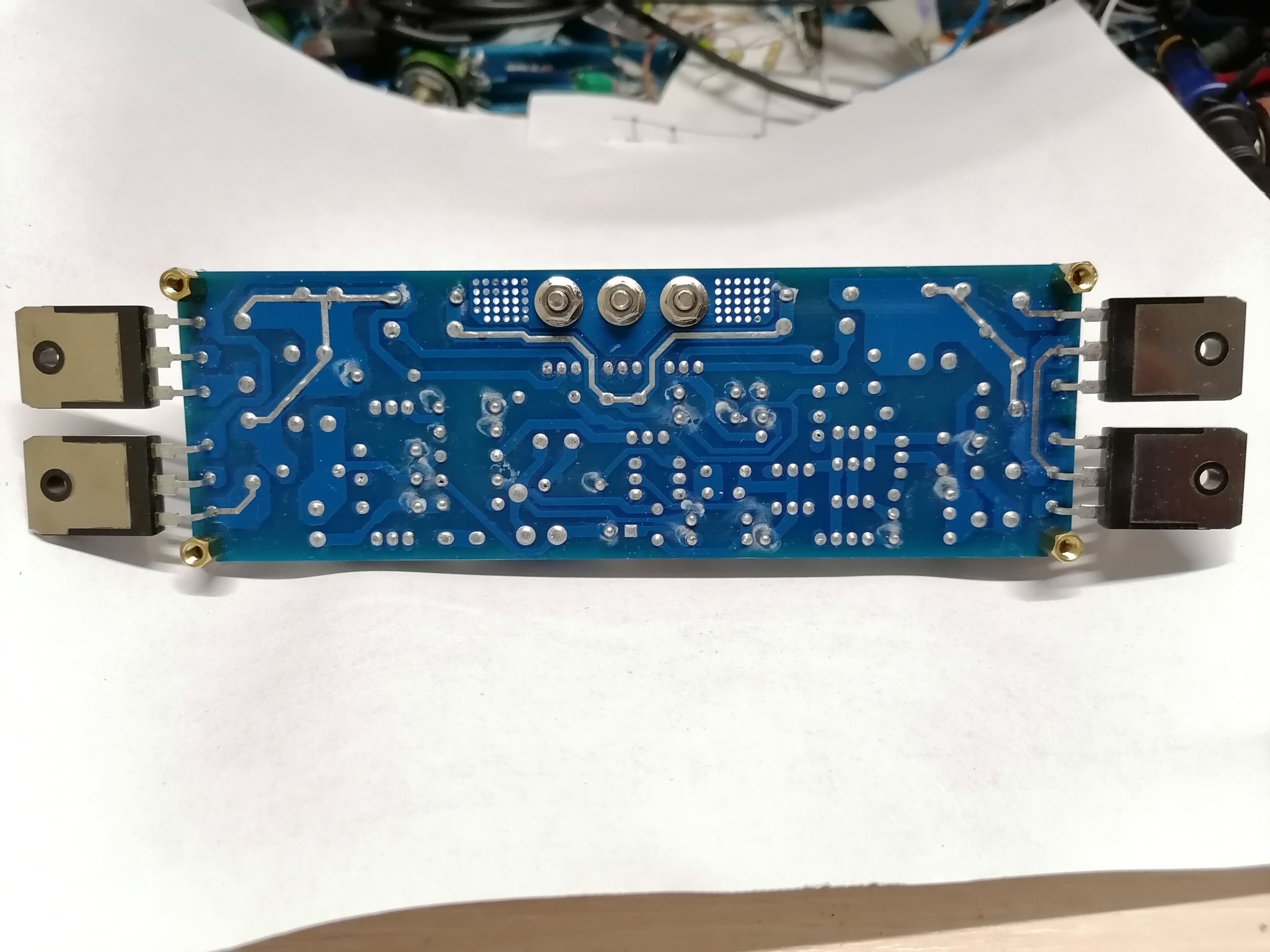

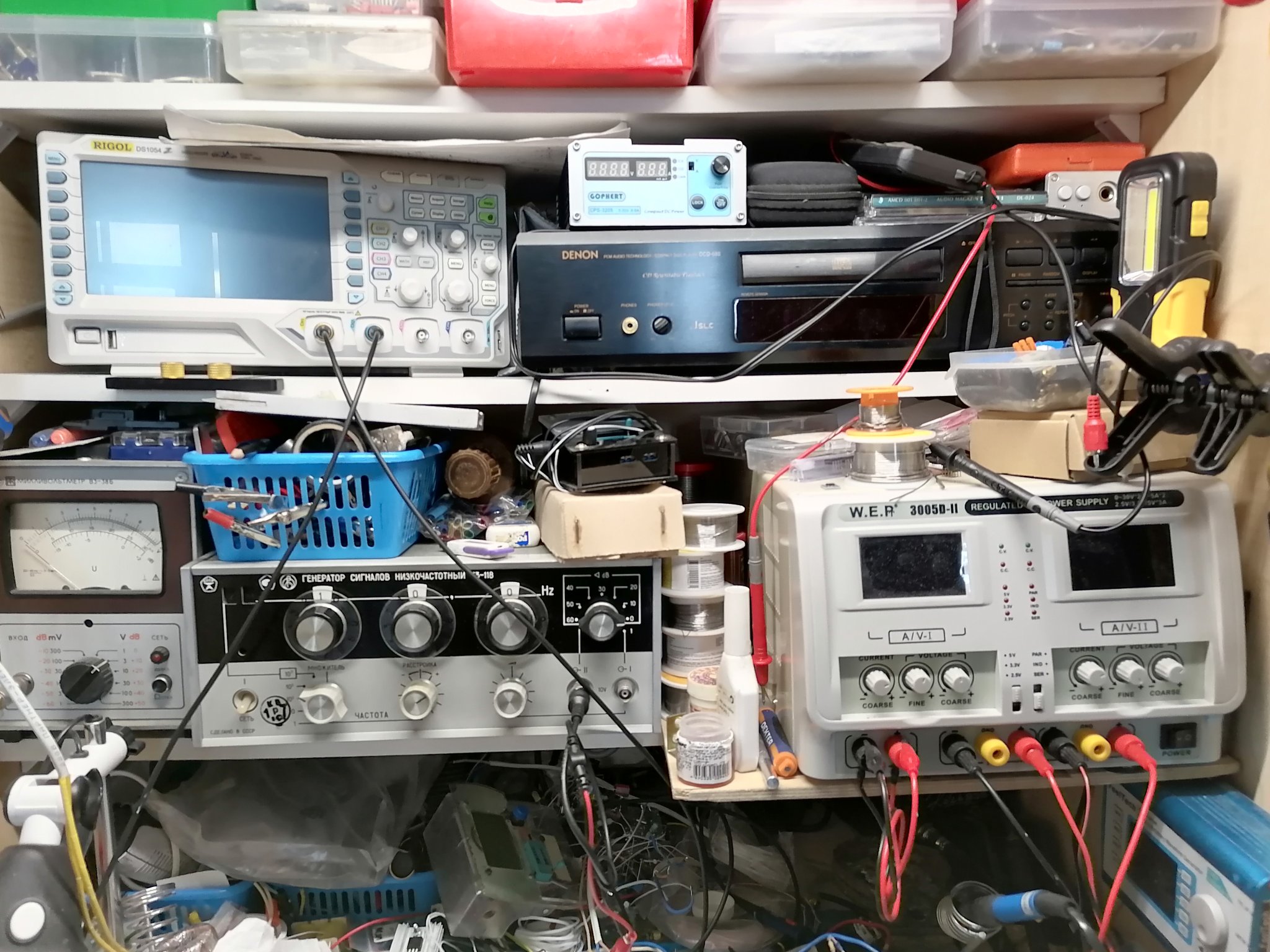

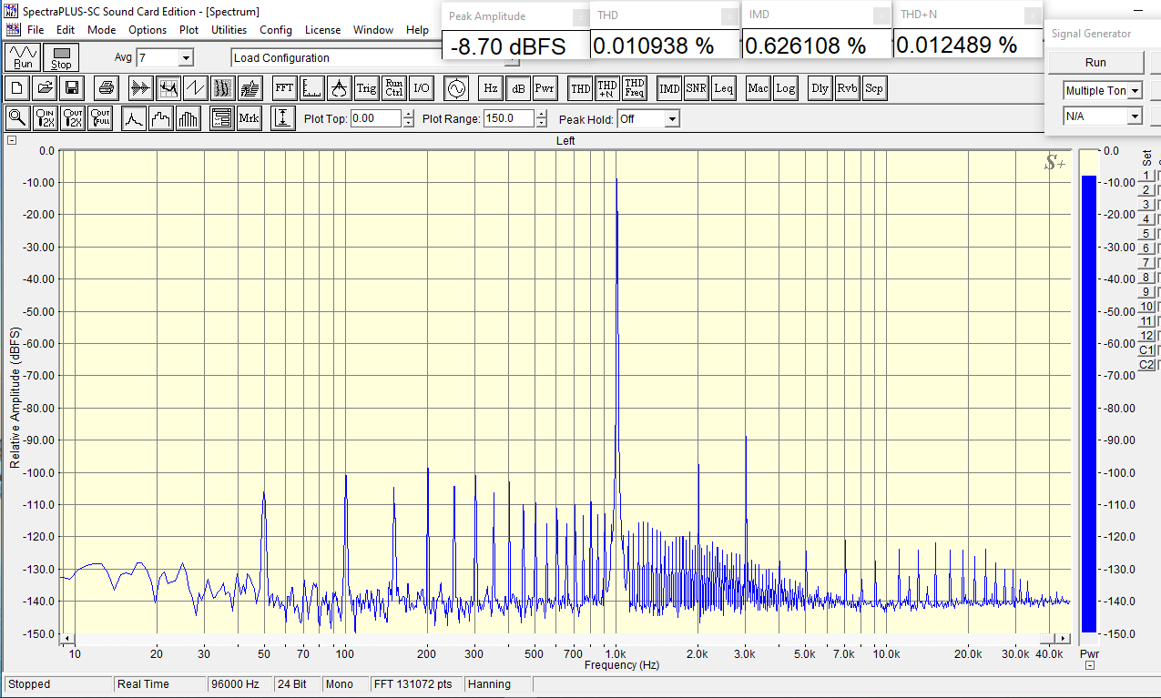

Now part of the answer to the question: the first 3 pictures are not yet tested board. The 4th picture is the tested board. Next is my minilab (#5). #6 is the 36V bipolar transformer and the power supply itself with load protection. #7 - instrument readings: DC voltage at the output of the amplifier (left) and the positive half of the power supply (right).
What surprised me: with such a large power supply and small heat sinks of the output transistors, during a long enough test, the heat sink of the load resistor = 8 Ohm/100W was red-hot, but the heat sinks of the output transistors, were warm and not even hot! The output power measured with an oscilloscope = 100 W/8 Ohm/bipolar 50 V supply. A little short of the claimed 120 watts... I still have a lot of pictures, so I'd better put some of them in the second part of the answer, so as not to bother with Pdf...

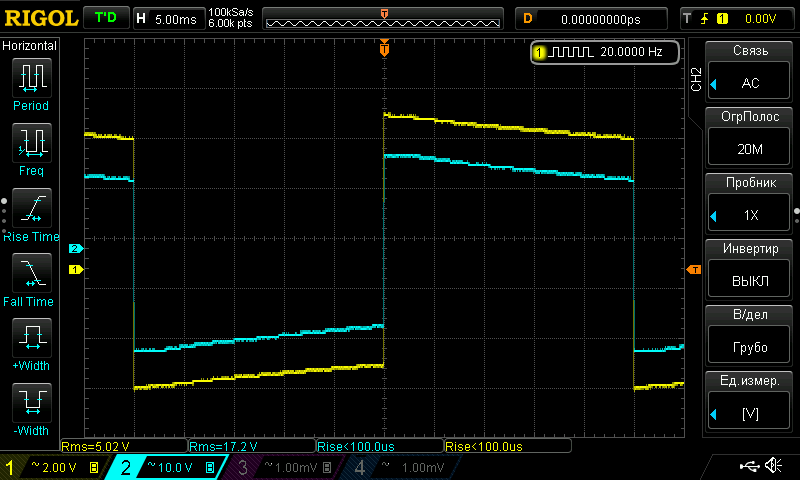

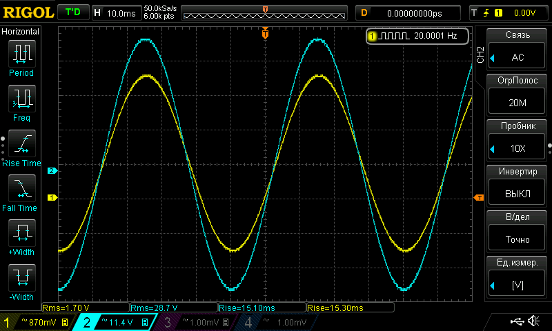

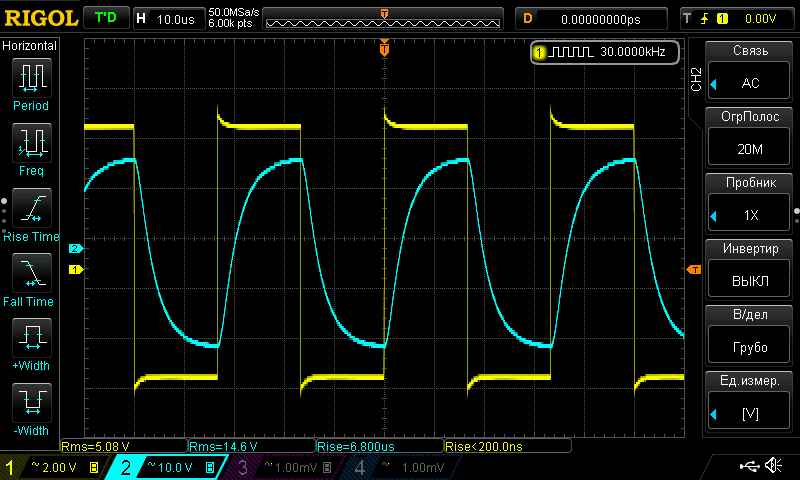

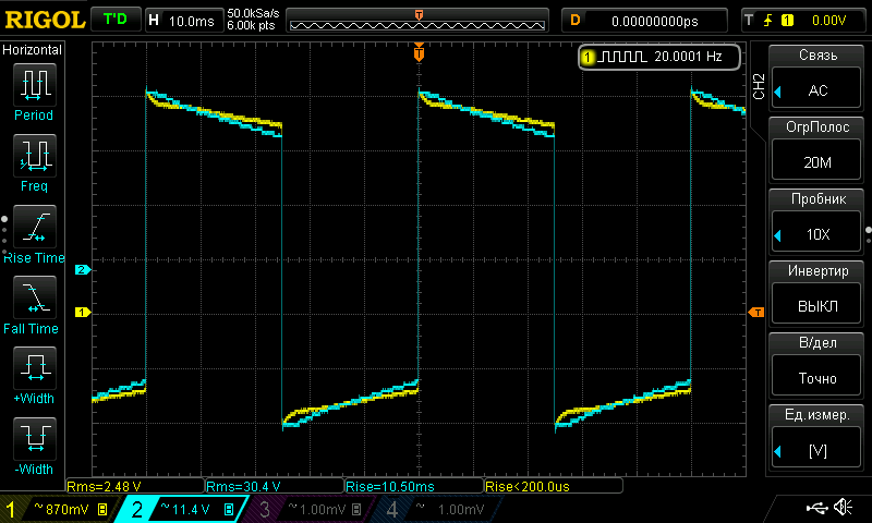

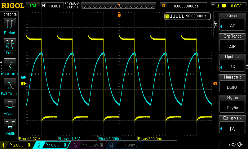

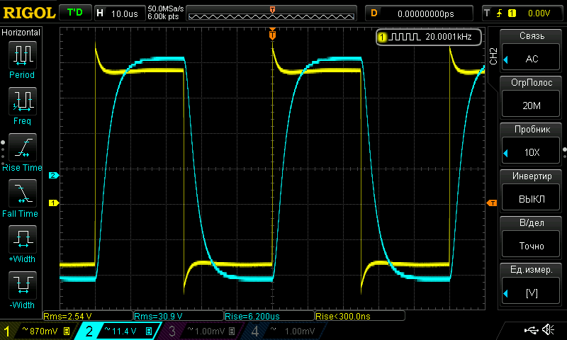

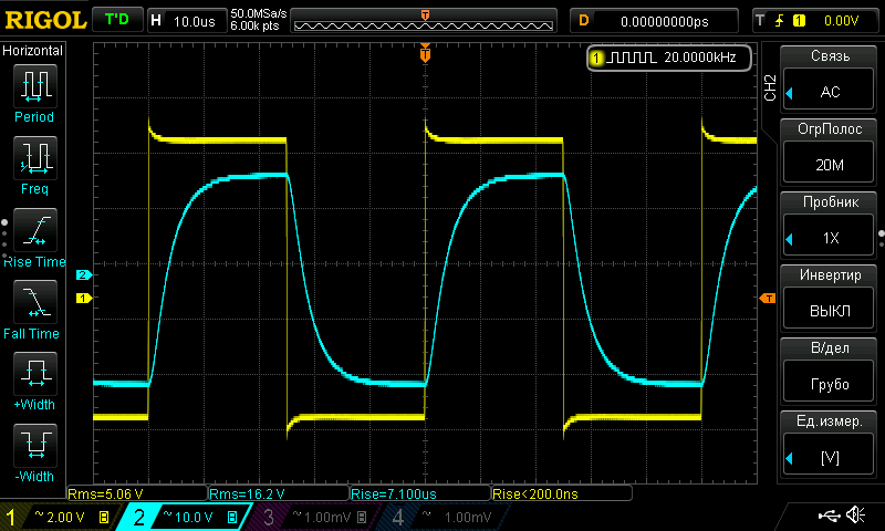

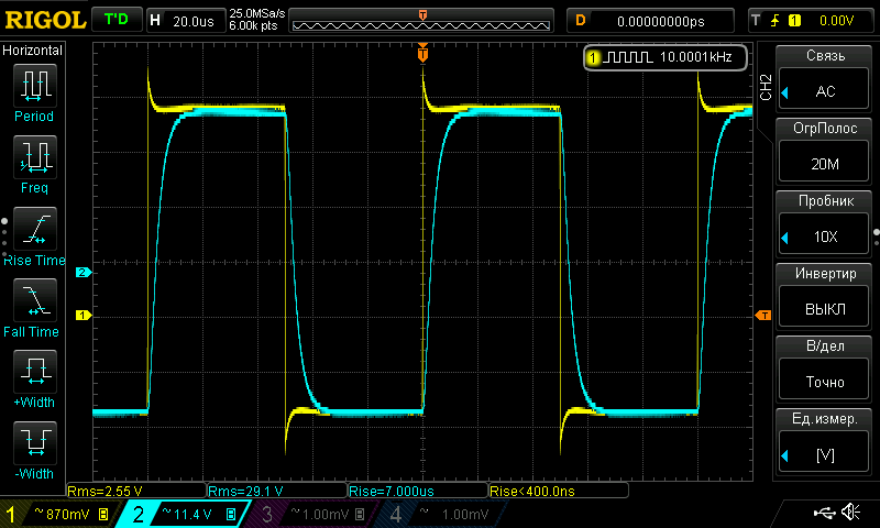

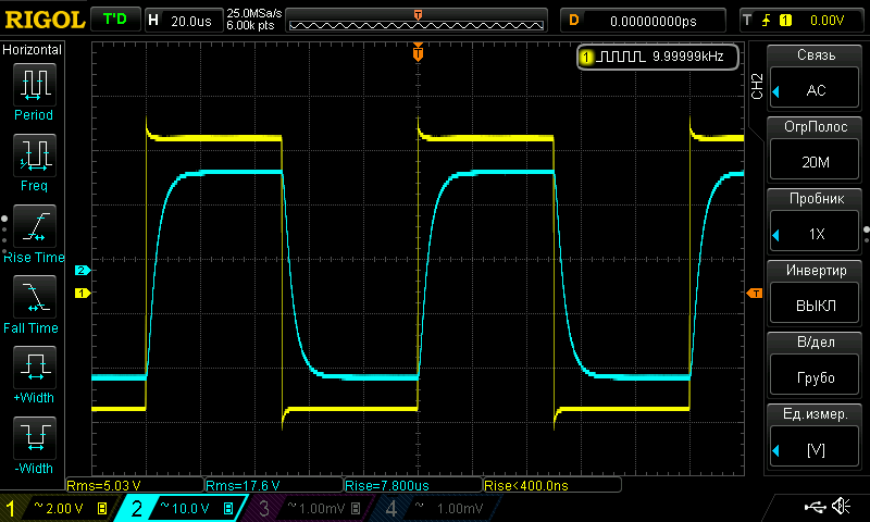

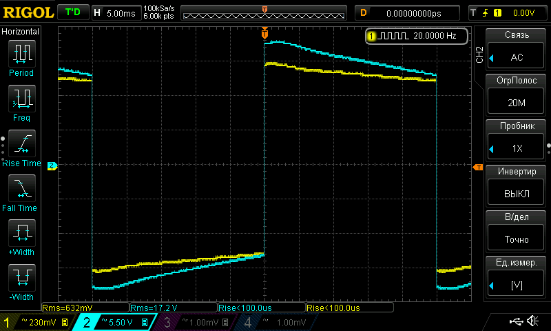

So, the test with bipolar power = 50 V.Recall that in blue is the output signal. The signal before the clip pic 1, then, remembering that they talked about a rectangular signal of large amplitude and low frequency, I did it: pic 2. The stylus was switched to x10. And the input signal = 0.7 V:
pic 3-4. Next, signals of different frequency and amplitude: 5-10 And at the end, test Spectra at 1,5,10 and 50W. The board after the test is working. Nothing happened to it... As you can see, according to Spectra's tests, with unstabilized power supply, the harmonic noise grows sharply and the actual noise shelf turns out with the level of -100...110 dB. On the one hand it is not much, but there is a narrowing of the dynamic range and such a forest of harmonics can be heard and can interfere... That's why I prefer stabilized power supply - absolute silence in the speakers!

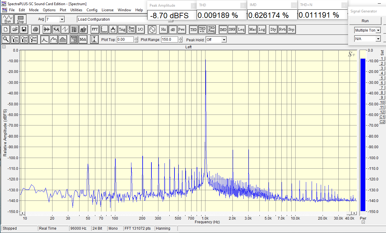

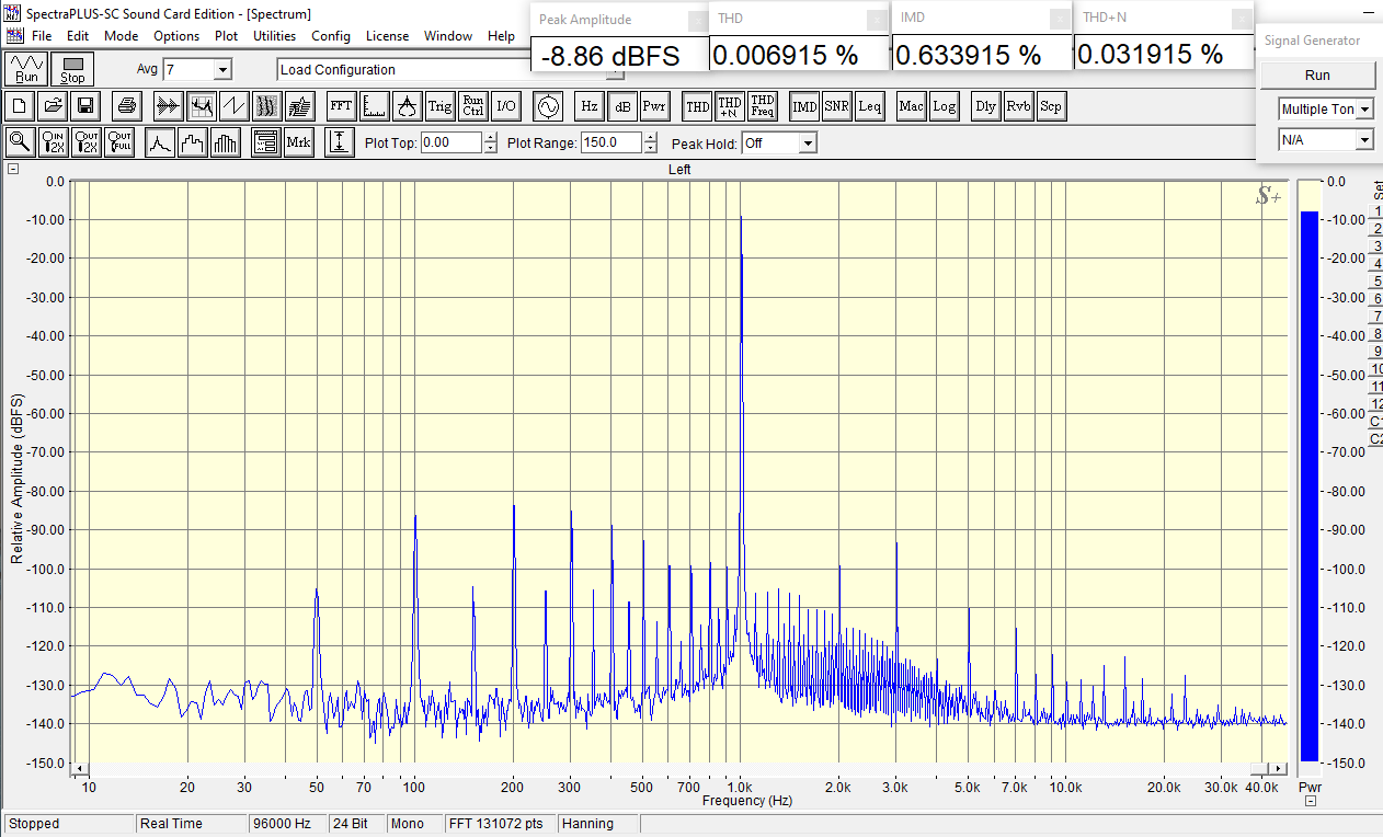

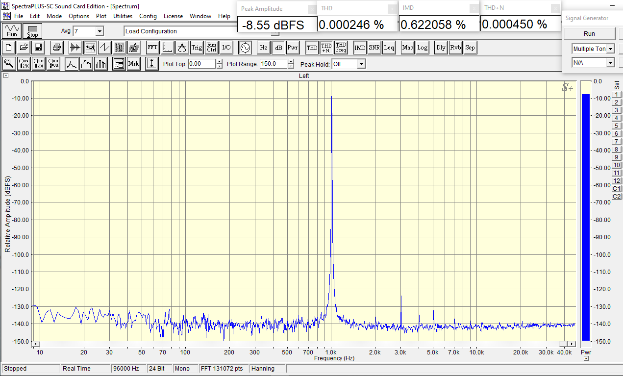

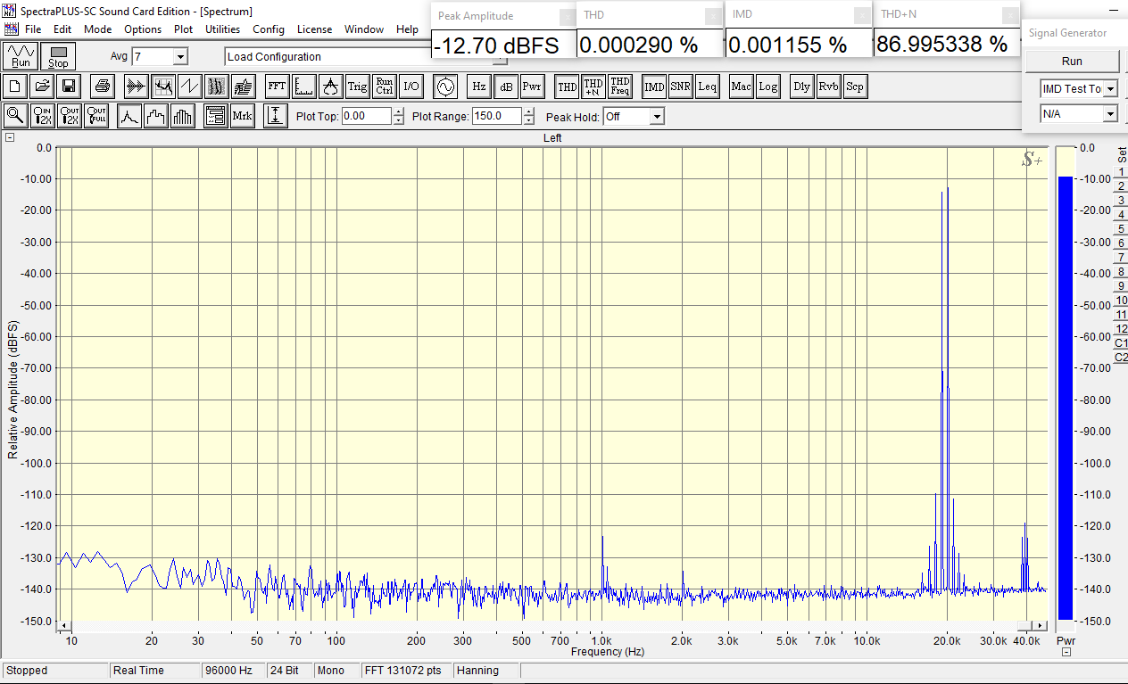

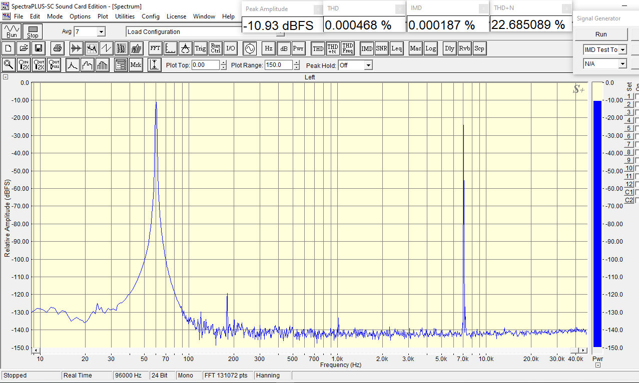

Hi! I use an improvised audio card consisting of a high quality DAC and an Olivin ADC. The description of the Olivin is here: https://forum.vegalab.ru/showthread.php?t=67983&page=4 Author's website: http://www.altor.co/products/test-equipment/olivine
Parameters of the DAC+ADC loop:
From the pictures:
1) THD test
2) IMD test standard
3) IMD test hard

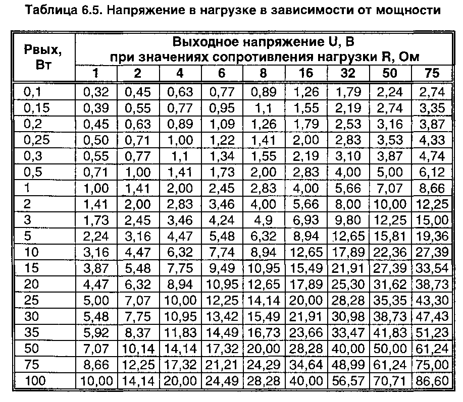

Here's the table I use: The upper graph is the load resistance, the left graph is the power on the load. Very convenient. At 1 kHz Spectra, after calibrating the loop, you set on the load 8 ohms, with the volume knob the desired output voltage, taken from the values of the table (measured with a multimeter) and automatically get the output power from the table. You don't need to count anything - everything is already calculated. Very convenient. And after the load of 8 ohms, I also have a divider, which I use to adjust the voltage at a given power (I take the values from the table) to a level of -8.4 ... 8.9 dB close to the value of -8.5 dB obtained during calibration. This is my procedure when measuring. One last thing. If the circuit board corresponds to the picture of the author's thread, so does the circuit. It is posted at the beginning of this thread. I did not check it thoroughly, I have no time. But the output stage is correct. I hope my explanations are clear...
I forgot to say: at -8.5 dB, by Spectra, when calibrated, the DAC output: 1.68 V rms
The DAC was bought ready-made, I don't know its circuitry. The chip on the board is 4394 (Or maybe AK4493? I don't remember anymore...). If interested, I can take a picture.

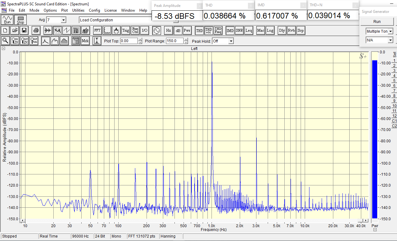

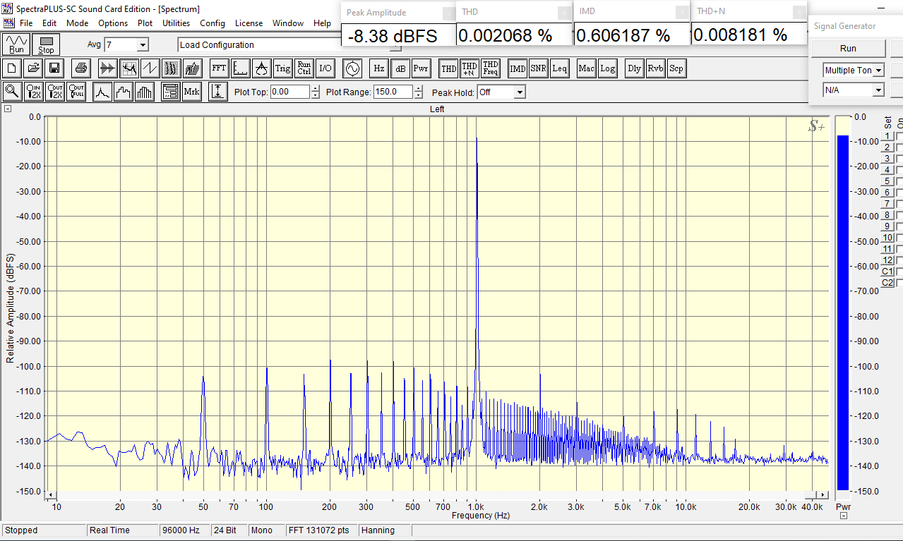

Yes, as expected, there is a faint background in the speakers if you lean your ear very close. But the sound is not bad even with unstabilized power supply... And even at low volume - powerful bass. It's nice. I expected it to be worse. But even the faint background is bad. On faint sounds, in silence, will interfere. I will listen to it tomorrow at normal volume. Stabilized power is better!
But when I started researching the spectra, I realized there was a problem. Raising the quiescent current also raised the gain of the output stage. The harmonic spectrum became shorter and went more to the low frequencies. That's why the low frequencies played better... Here clearly showed the disadvantage of this solution of the output stage: the amplification of the entire noise spectrum... So it turns out that for this variant stabilized power supply is preferable! This was most apparent at 5W (50 V unstabilized power supply) output power: the low quiescent current:
The quiescent current is 0.2 A: It turns out that for a non-stabilized power supply, the option with a small quiescent current is preferable! So the original version is designed specifically for unstabilized power and that's right!

mama mia... ((((To be clear, I used the diagram from response #6:
How do you have so much free time to occupy with nonsense?But when I started researching the spectra, I realized there was a problem.
In this scheme, you first need to remove all children's mistakes, and only then analyze ...
Interesting, interesting... How do you think, Gennady, should the scheme look like, without "childish" mistakes? And what do you consider "childish" mistakes? I am a simple amateur, and I am interested in a different opinion. Or, what answer shows a diagram without "childish" mistakes? I would be grateful for a more detailed answer.
