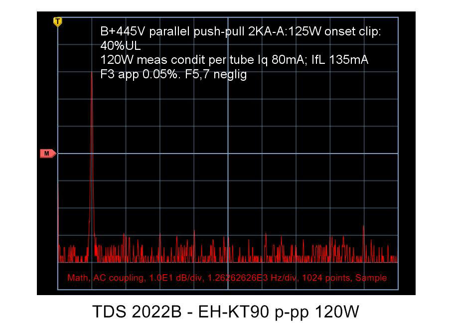

At last the bench results I was looking for. The setup using a HiFi designed (20dB glob NFB) parallel push pull UL 40% 110W stereo amp using concertina ECF80, Balanced 12BY7 (triode config)Williamson CCS slam Diff driver; original power stage fitted with New Edit TungSol 6550 or JSC Svetlana 6550 winged C types.
Both these last two types give very similiar distortion results. This amp has the privilage of AC driver balance and sep bias adjustments for min thd. Only because of these two is it possible to optimise the performance.This time I raised Iquies for KT90's to 36W per tube. (80mA#450V) this figure is hard for the standard power tubes previously used. In fact the lowest thd was obtained using the 6550WE versions, but these tubes cannot hammer 36W on the anodes. I believe Jim McShane also did research in this.
In all UL circuits, running at a high Iquies does wonders reducing the THD at upper audio frequencies (10Khz) and for the KT90 running at this 80mA Iquies is a breeze. It also is more linear with low valve screen UL grid resistors. One could press Iquies higher into classish A but the returns wasn't worth straining the power supply.
To my suprise I got very similiar thd results but with an extra 10% more throughput power. With a B+ of 450V; one cannot complain.
The remaining details in pic.
The output is remarkably clean; stretching the TDS2022 FFT to show harmonics below 0.05% which was the final figure. Others trying sim; beware, the output tranny used was an excellent balanced item with a b/w up to 75Khz.
I will publish the thd/power results after all is tabulated. Until then,
I take my hat off to New Sensor for getting this EH KT90 tube to perform right. This puts my faith in the EH version; but the Ei KT90's version is noway any match
richy.

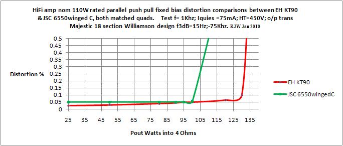

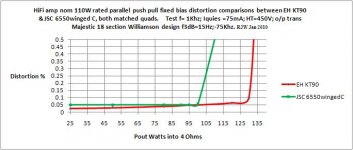

Okay the graph enclosed is pudding proof that swapping to EH KT90's is a worthwhile bonus. Take note of the operating conditions. Comparing graphical lines, the indications of lower thd at lower powers (as expected) is due to variations in front end and driver stage valves.
Users with other o/p transformers may get slightly different results, but this EH KT90 is worth it's salt, solong the heater current can be supplied.I'm now on listening tests.
From a parallel push-pull advocate,
richy
richy

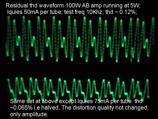

Dummy loads tests: By just chance I measured thd vs Iquies set at a low o/p level (5W) i.e 100W stereo AB parallel UL40%; p-p power amp using 2x quad Svet 6550 Winged C in each 1/2; the harmonic details in the pic. The input level remains constant, but as the Iquies moves up the curve, better linearity is obtained then je lower the thd. The same freq v.s thd effect at 1Khz but not anyway so marked.
Notice at low level 10Khz, a 50% Iquies difference of Iquies; thd at is roughly doubled. Every amp will have a different signature depending on boundary conditions, but an increase will be expected in most tube amps.
Bear in mind; the open loop characteristics; this is where no 2 amps are the same. In this instance the global nfb (20dB at 1Khz) gradually runs down to 17dB at 10Khz so THD will increase. The variables are enormous; matched tubes ? open loop gains ? Min thd of test equipment ? The interpretation of all these results is open to variations, but at least the simplest can be examined.
Ideally I would like to spectrum analyse it, but the harmonic levels are low that a filter would have to used to rid the fundamental from input overloading, so instead I used the HP332 analogue monitor o/p.
The conclusion is increasing Iquies reduces upper audio distortion.Study the tube curves that one isn't exceeding dissipation for nothing by running close off the end and again thd will increase. For a tube amp running with a relatively low B+, the advantages are there.
Note: Iquies was measured cathode + screen current.
The next check the same but with a loudspeaker + crossover ?
richy

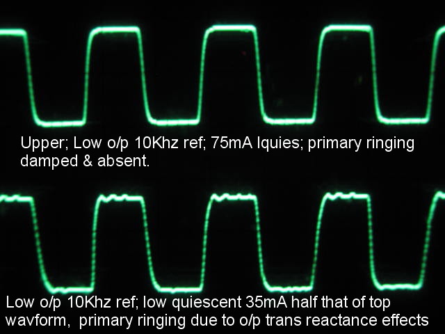

Here is another symptom of push pull problems, and quite a regular one. In this example the user turned down the quiescent current with a view for longer tube life creating the lower waveform. The pic shows ringing equating to transformer parasitics having pick & play with poor o/p tube stage damping; hence the ringing. Increase the quiescent and the upper waveform results which is acceptably clean.
Going back to the lower; the ringing can be zobelled' or slewed out with an R/C; the penalty is unnecessary wasted power going into the snubber, and not the intended load. Quite often amp builders come across these problems and bark up the wrong tree in thinking that global feedback is to blame; which it isn't but directly by an underrun output stage. When global nfb is connected as in this case it is, the waveform will appear confusingly in various distorted forms throughout the amp stages. The cue is with a dummy load, ringing of this nature can only occur where an inductor is.
Again a substandard made o/p tranny can show up a raft of defects which requires experience. With high gm tubes, with 40% UL taps a screen to anode zobel is often unavoidable typ 1K+1nF to avoid much higher frequency oscillations, of the leakage inductance and capacitance node.
richy.
richy.
