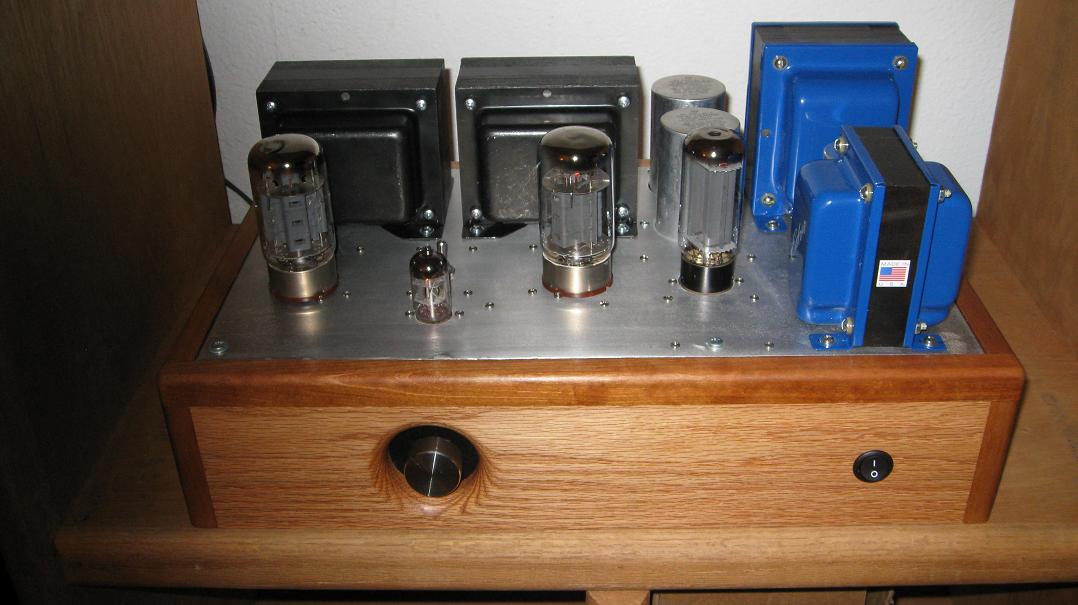

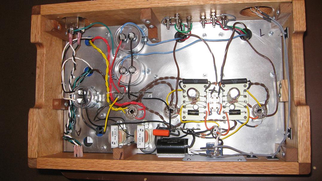

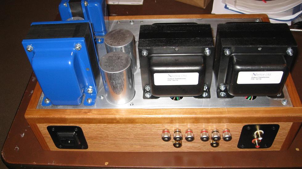

I'm attaching some photos at the following imgur album link. I believe that I will finish the capacitors and fix up the sides of the xfmrs, but for now it looks really sharp. My next project will be to make a suitable DAC, and then the speakers. I have a lot of work left, I suppose.

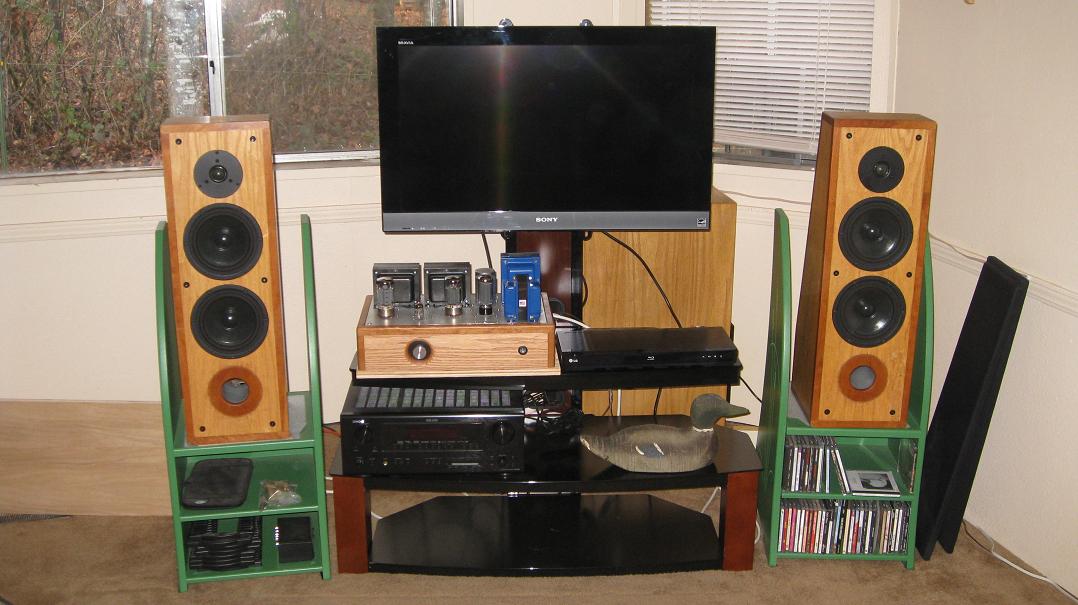

I haven't even built mine yet but I'm already excited and hankering, got the 'covets' for a 2 x SE KT88 mono block. Hint hint. Should probably finish this one first. Maybe in a year from now. My build will be slow. This will be my first valve amp. What kinds of speakers are people using? Dave R looks like he has some DIY 2.5 way? How does it go Dave?
The TMM in my set up is not a 2.5 way. The (2) 6.5 midwoofers are 4-ohm, wired together in series for a (nominal) 8-ohm load. The crossover from woofer branch to tweeter is a series. I would consider it a 2-way. These are tuned to ~ 41 Hz.
The TMM's are very nice sounding (IMHO of course ) . However the hefty impedance swing from 7 ohms to 40+ ohms on the mass loaded peaks make this tube amp struggle a bit on the low end. Nothing a properly adjusted sub can't accommodate, though. If I had to do it over again, I'd look at (2) 8-ohm midwoofers and a single (more efficient) 4 ohm tweeter. The mass loaded peaks would be half, instead of double in that case. The good thing is that the impedance of the TMM's is not an issue for the SS amp.
I have a smaller 2-way bookshelf pair (also vented, and also series crossover) which is a magical match with this amp. It is tuned to ~ 64 Hz, but even without a sub I find it quite enjoyable. One day, I'll re-build the cabinets on these to match the amp case.
