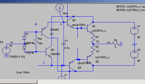

megajocke said:
But the transistors will not magically start to work another way when put into the circuit so it won't blow up like you say. But maybe you misunderstood what I meant by shorting them together (those two wires coming out at the bottom are the ones I mean in my diagram). This makes Q5 a diode just like the others in the string and it will work just fine. Q8 will drive Q4 directly and Q6 will provide bias voltage for the output stage, without undefined or very nonlinear behaviour. But that doesn't really matter for the problem and in the following text, is not done.
The problem I'm talking about is something that will be pretty unusal as I've already said, maybe affecting only a few percent of the amplifiers made - but in my book that's one of the worst problems - not apparent in the prototype or even a small production run maybe. I'd be happy if someone pointed out a nonobvious bug like that in one of my circuits.
If you say it's not a problem then here's a hint:
(the convention i use is Uab = "red lead" on node A and black on B)
1) Ubc is about 2Vd, set by Q7,Q8
2) Uad is about 4Vd set by Q5,Q6 and the diodes for biasing output stage.
Kirchoffs voltage law gives: Uab + Ubc + Ucd + Uda = 0
Insertion of 1 & 2 gives [because Uda = -Uad]:
Uab + 2Vd + Ucd - 4Vd = 0 <=> Uab + Ucd = 2Vd
That is, the sum of the voltage drops over CE of Q5 and Q6 is 2 diode drops. But how does it divide?
Hint #2 = There's nothing in the circuit that will make it divide 50-50...
You make a very convincing argument. Unfortunately it does not agree with measured results or with my simulations which DO match measured results. Perhaps my real units are a little short on the applied mathematics of electronics.
Your points:
#1- Sorry, that is incorrect. Both my simulation and my measured results show otherwise. And they agree.
#2- See #1.
Hint #2- And yet it does.
I do believe you think you understand what is going on in this circuit. I also believe I know what is going on. At this point I have measured over 100 units and confirmed voltages and operation. Since these results also match my simulations (and quite closely I might add) I will go with what I believe is happening.
I do appreciate you pointing out what you perceive as a design flaw. It simply does not show up in the real units.

On "1) Ubc is about 2Vd, set by Q7,Q8" <= numbers and node names as in my schematic
You answered:
"#1- Sorry, that is incorrect. Both my simulation and my measured results show otherwise. And they agree."
But in post #54
http://www.diyaudio.com/forums/showthread.php?postid=1683679#post1683679
You said exactly what I stated in point 1:
"The voltage between the emitters of Q7 and Q10 is 1.2V Both transistors are on and conducting. "
So which way is it? Or maybe I should have been more clear that the transistors are numbered differently in my drawing, sorry for that.
"#2- See #1."
What is the bias voltage between driver stage bases then if it's not ~4 diode drops?
"Hint #2- And yet it does."
Not in the simulation you posted earlier, but it will under the right circumstances, for example if current sources and those biasing transistors are matched (maybe not by hand, maybe they are close enough from the factory) for example.
If it is not splitting 50-50 at idle it will at some other amplifier output current. If this is at a pretty low current and, with signal and load connected, voltage is read over transistors with a multimeter (which shows average) then it will read the same voltage over both too.
In this file you posted Q8 has 0.66V Vce while Q11 has about 0.2V
http://www.diyaudio.com/forums/attachment.php?s=&postid=1681062&stamp=1228927989
Or is it another simulation you are referring to? I'd like to know the measured voltage in the real circuit over those two, Q8 and Q11 in your diagram.

Hey, I just found the other thread and this post:
I assume you by this mean Q8 and Q11 in your circuit is working in the saturation region? In that case the discussion is just about a misunderstanding because in post #41 (first one I posted) I wrote:
But when I there suggested the transistors had to be operating in the saturation region or in reverse you said I didn't understand the operation of the circuit. But I see you are referring to the region as "pinch off" so maybe that's why you didn't spot it.
Also, the files with voltage readings that showed non-equal voltage sharing didn't make it any clearer. I agree that the circuit will work when those two transistors are operating in the saturation region, that's pretty obvious. What I tried to explain is that the circuit cannot work as intended if the transistors were not run in the saturation region.

Steve Dunlap said:
The transistors are run in the near pinch off mode on purpose and this is why the circuit works.
megajocke said:The circuit around Q8 and Q11 has pretty undefined behaviour. Better would be to remove Q8 and Q11 and put biasing between bases of Q7 and Q10.
Unless Q8, Q11 is saturated or driven in reverse there is no way for the signal to get to the output right now. (Input is to the collector???)

Hello again megajocke:
First let me apologize for not replying sooner. I have satellite as my only high speed Internet option. When there is winter weather like now the snow and sleet block the signal. The ice isn't even reaching the ground here but the stuff in the upper atmosphere still messes with sending and receiving.
Now, it seems we have both realised we have a problem with understanding precisely what the other is trying to say.
So, starting 3 post back:
You answered:
But in post #54
http://www.diyaudio.com/forums/show...679#post1683679
"#2- See #1."
I missunderstood what you meant by 2Vd and 4Vd. I took this to mean 2 volt and 4 volt when you meant diode drop. The first is a 2 diode drop as (we both) stated. Just not in the same post. The second (4Vd) or 4 diode drop is actually just under 2V. It can be adjuster from under 1.6V up to 2.2V With values shown. The adjustment is made with R12, which should be a variable resistor. Still short of a 4 diode drop, but not by much.
It does not divide 50-50 across the the emitters of Q7,Q10 but there is the 2 diode drop as we have both said. However, look at the voltages on the emitters of Q8,Q11. A split of 49.95% to 50.05% seems pretty close. Emitters of Q13,Q15 are even closer.
http://www.diyaudio.com/forums/atta...tamp=1228927989
These voltage drops reflect the differences on the collectors. The bias circuit forces matched voltages from the emitters onward. It does this by varying the resistance of the bias pair which is what causes the different collector voltages even with the same current into the emitters.
Steve

Yes, it's pretty easy to get misunderstandings over the net...
I tried adjusting the simulation (diode string and resistor) to make Q8,Q11 work in the saturation region, about 200-250mV Vce. The bias current in output stage is around 40mA then, like you recommended.
The more bias is turned up though the more it misbehaves because Q8, Q11 gets enough Vce to work more like current sources instead of resistors - so I can see why a pretty low bias current compared to what is usual is optimal for the circuit configuration.
But as long as bias is kept low those are working more as resistors than transistors so it's not too bad. If there is 400mV to divide between them I'm sure it will divide equally, 500mV probably too, 600mV... maybe... but above that all bets are off. But it doesn't operate there I see now.

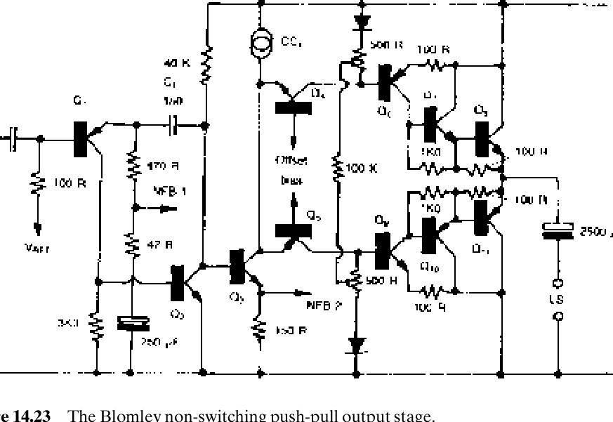

megajocke said:Have you tried this type of circuit? Doesn't have issues at high bias currents if one wants that.
Maybe too boring though![]()
Or how about the original Blomley?
Do one with split rails and the bias generator for the "steering" BJT pair would be especially easy to knock up (+/-0.7V from an other identical NPN/PNP pair connected as diodes).
But would it be better that a properly done double or triple EF?
Glen

megajocke said:Yes, it's pretty easy to get misunderstandings over the net...
In an earlier post I mentioned using a distortion analyzer to set the bias. I do realise not everyone has one. But, if you have access to one the easy way to set the proper bias is to start low and increase while watching for a null point. This is proper bias for the transistors used to build that amp. Setting the bias higher will increase the distortion (as you noted) and is simply a waste of electricity. You can make the amp run hot, for those that feel the need for heat, but you gain nothing and increase distortion.
