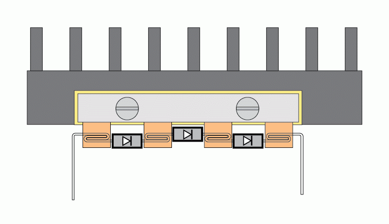

Jens Rasmussen (Delta Audio) did the same thing a few years ago with his Leach pcb. I initially did that too, and even sanded the faces as a unit to achieve better contact, but a simple experiment showed that a much faster thermal response could be achieved by using axial diode leads clamped to the heatsink (via Kapton insulation tape), as shown. I found three diodes to be optimal for the Leach.

So, Brian, let me get it straight - form the pics I see the 3 diodes in the air with two soldered leads conducting heat from the heatsink (& obviously insulated from the heatsink). And this has a faster thermal response? And is unaffected by air currents? Hmmm!
Edit: thinking about it metal would be a better heat conductor than the glass or plastic body of the diode, so I'm convinced!

This is the "as shown"

It actually worked very well on my Leach version, and it's a sight better than drillling the heatsink.
Anyway, try the “ouch” test!
Hold the diode body between thumb and finger. Apply a hot soldering iron bit to the lead. Time your “ouch, better drop it” response as the body (and fingers) heats up. Now do the same but hold the opposite lead instead of the body. Betcha drop it sooner!
The three diodes are mounted so that four leads make heatsink (h/s) contact. Four diodes mean six leads making contact; all contributing thermal transfer to the PN junctions. Any mass of insulation i.e plastic or glass body or air, will obviously slow down that transfer rate.
The important point is that the leads, or SMD legs, make contact with the h/s, not via an air gap. I suppose a double sided pcb with enough via holes might allow a faster transfer rate.
One could make a flatpack of axial leaded devices with leads through the pcb, bent flush with the pads and soldered, then filed flat. The whole unit can then be clamped via an insulator to the h/s. That way all leads are in contact with the h/s.
By the way, I used the SOD123 package with that technique, which I think is even smaller than the one you’ve used, i.e. less thermal mass. SOD323 would be even smaller. Sanding the faces can further reduce that mass, within reason, of course.
Brian.

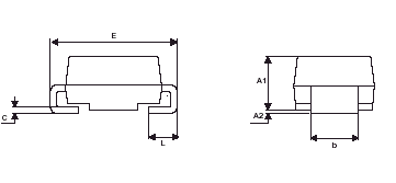

ostripper said:That is a good idea, the metal leads "wrap around" the body
and are flush with one of the sides. (attached)
One could just flip the
plastic side toward the board (flat metal away from PCB)
and couple using a compounded
mica washer.
best of both worlds..
OS,
I'm not sure how this works at all. If the legs of the SMD are soldered to the pcb surface, how do they contact the heatsink?
Are the bodies glued to the pcb, dead beetle style, then the leads soldered in a string?
A sketch would help.
Thanks.

O.k. I see, but that construction technique will be a little more tricky than axials through the board.
Oh, and the leads can be long, increasing the contact area, if necessary.
Brian.

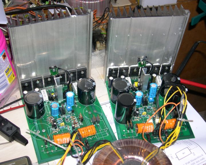

If heat sinking Q7 and Q10 solves the problem, then do it. Could you post some information on your heat sink. A picture would be nice.
How close to the outputs is the bias board mounted?
Hi Steve,
the heatsink on Q7-Q10 is a sub-optimal solution IMHO, mostly because on the "correctly" heatsinked board I still can't pass more than 70mA, even with R27 at maximum setting.
On the other board, with less good connection to heatsink (sil-pads), I can easily adjust bias to over 200mA.
These heatsinks are nothing special, they measure 15x17x4cm and their base is not particularly thick (about 5mm).
But since a photo is better than many words...
The board on the left misses some components because was assembled in a hurry
Ciao
Andrea
