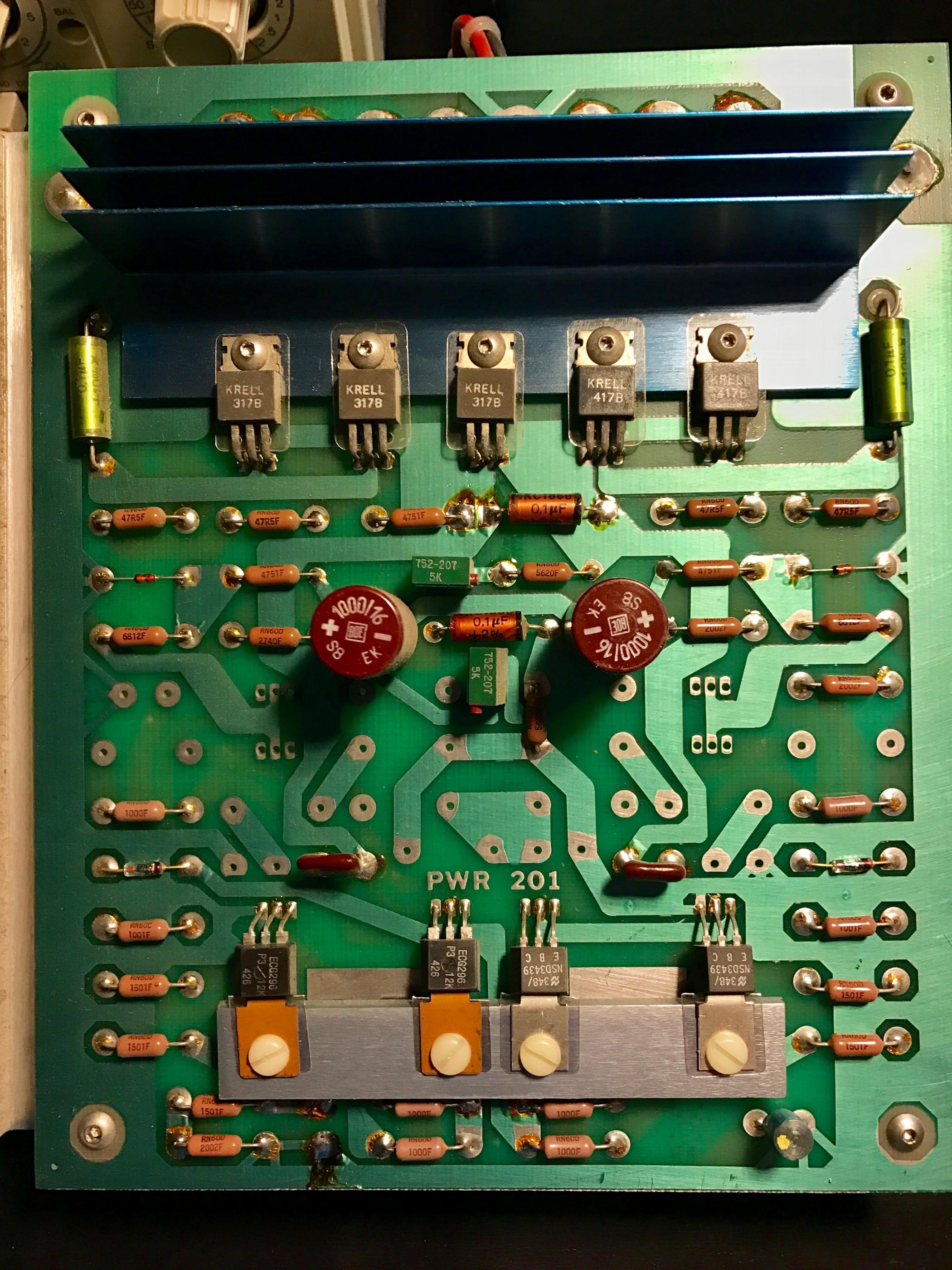

Krell KMA100 driver board
[image]Image:krell driver board|none|They are the top ones attached to big blue heat sink[/image]
Show us the transistor and where it sits in the circuit.
