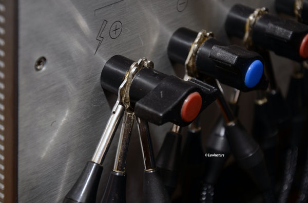

Itsmee,
this particular one exactly, or any wing-type binding post ?
The Tiffany style binding posts are made by a number of manufacturers nowadays ; Vampire, Mundorf, Intertechnik, leafshaped cross-section ones by Propeller Post, etc.
Even Hirschmann used to make this type of terminal ('Polklemme' in German )
