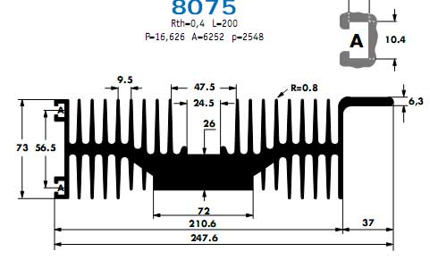

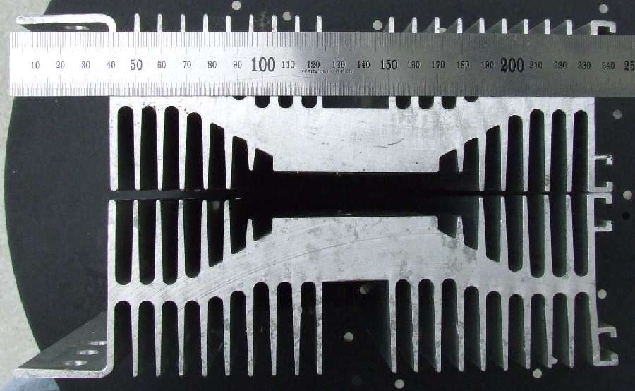

Here is the image of the coolers I have at 205mm height each, two (as on image) should be sufficient per channel.
stein2 said:image of the coolers
Wowza, a 1 inch base plate, nice sinks.
Pada ones ; probably same as crazy danske pooftahs use all the time
Wowza for sure. Two of these babies and four Spragues pull down to mother Earth by 10 kilos. Meaning, that four of these, eight Spragues and two 500VA (4kg/each) will generate 28 kgs alone, plus the box/case/housing and misc stuff ... I think that will come very close to the weight/power ratio of a decent tube amplifier...
