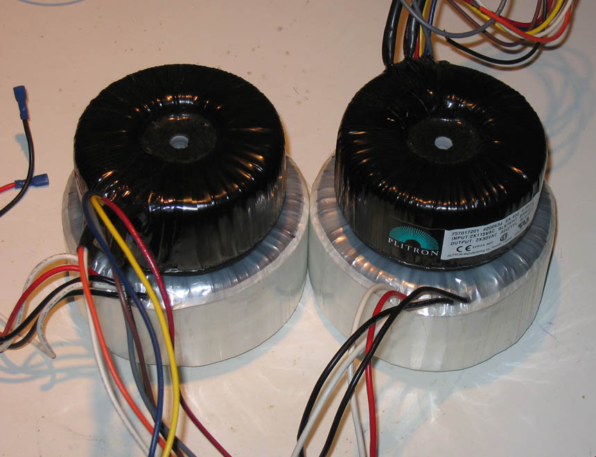

grimberg said:
Shawn,
The voltage on the original Krell KSA-50 is about 37.5V. This information is available on the Wiki along with some other valuable tips.
http://www.diyaudio.com/wiki/index.php?page=Building+guide
You can also consider water cooled ceramic blocks, as used for CPUs and video chips.
Sorry, my bad, I have two 30-0-30 400 VA's for the Krell KSA50!
~40VDC rails.
And I have 40-0-40 800VA's for Krell KSA100!
~55VDC rails.
Gots a lot on my project table right now, getting hard to keep organized? ;)
OK back to normal here...somewhat. I hope I can knock off both amps this winter? :cool:
Shawn.

TomWaits said:
two 30-0-30 400 VA's for the Krell KSA50! ~40VDC rails.
I have 40-0-40 800VA's for Krell KSA100! ~55VDC rails.
both these transformer/amp proposals will give higher voltage than the Krell originals.
The 30-0-30 will give about 4Vdc extra and generate more heat and consume more power.
Your 3pair tunnel will cope with more heat, OK.
Your 400VA will not cope well with more power.
Either reduce the voltage or reduce the Iq. Neither are optimum.
You may get reasonable performance by increasing the 56mF substantially try 75m or 100m.
The 40- 0 - 40 will give about 6Vdc extra and generate a lot more heat and need a lot more power. I think this one is going too far to extrapolate the 100mk2 design.
I agree but I disagree, is it fair to say that? I think in everyday use these values will work well and that it should not be that hard to find some balance. I will proceed regardless and I most certainly will share the outcome. T, sometimes you just have to do it and try not to worry too much. I am not carrying forward on reckless abandon here, nor do I suggest it but I have to experiment in real life scenarios. This is how I learn best, by doing and experimenting. I am willing to take some small chances too but I'm not a gambler unless I'm in Vegas. ;)
Don't hit me with the ruler when I say this, but I think I'm going to try running the 100 off 60VDC rails with 1kVA per channel. I already have the toroids. :eek:
Cheers Man,
Shawn.
P.S. I own a variac! They dial up nice and slow if you want them to. :)
in both cases difference is slightly above 10% rise of mains voltage.....
for me that looks as nothing to care , if heatsinks are good enough
regarding power-that really depends on load (spks he use),nothing more ....and nothing less ;)
