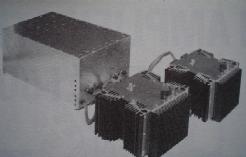

jacco vermeulen said:Photo....
Can you say "Speakon connectors and 4 con 10 ga. wire" for the umbilicals?
Would be VERY neat and be able to use the same PSU for my Krell AND Aleph Mina-A / 30......
rabstg said:Can you say "Speakon connectors and 4 con 10 ga. wire" for the umbilicals?
Yep.
Unless you can get your hands on Camac style connectors like i used for the design on the picture i posted.(see Mark Levinson or Fischer, my audio friend talked me into buying that filthy Swiss stuff)
(which is a fully regulated Class A, the picture does not do justice to the size of such an amplifier)
I used Neutriks on BrianGT's GCs, decoupling a powersupply so easy can be pretty handy.
