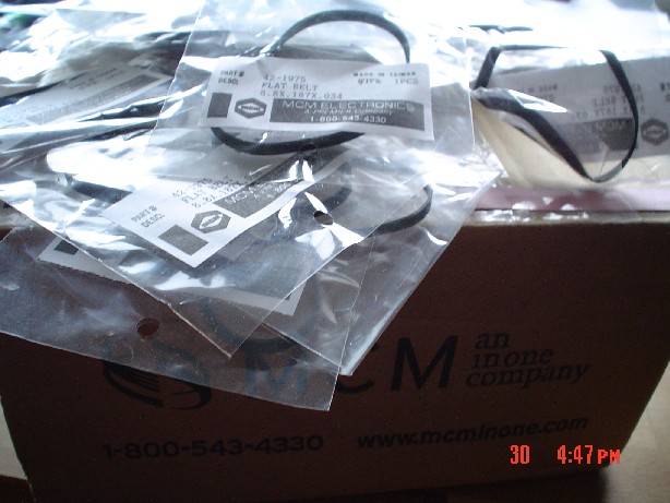

Speaking of spaghetti:
anyone have a clue what a diy dork can do with a box full of Taiwan flat belts ?
MCM sent my order to New Caledonia first, it returned, then sent it me, for me to discover the true content.
With the shipping and handling costs added these are really fancy belts, friends.
Spot the real fool !
