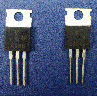

The MJE1503x have a much higher SOA than 968. This allows lower impedance loads to be driven.
968 would probably do if you were to only drive severe 4ohm speakers. If one were to drive moderate 1ohm or severe 2ohm speakers then I suspect that the 968 would become unreliable.
The MJE1503x will drive 1ohm all day to any level.

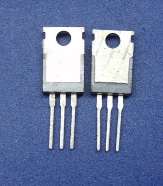

The latest 15034/5 has much higher SOAR and is capable of driving very low impedance loads when used with a high gain output device.
From the few samples I have from Onsemi there seems to be a disparity in hFE between the lead free and the older version.
Has anyone else found this or are better matches available for the newer lead free?

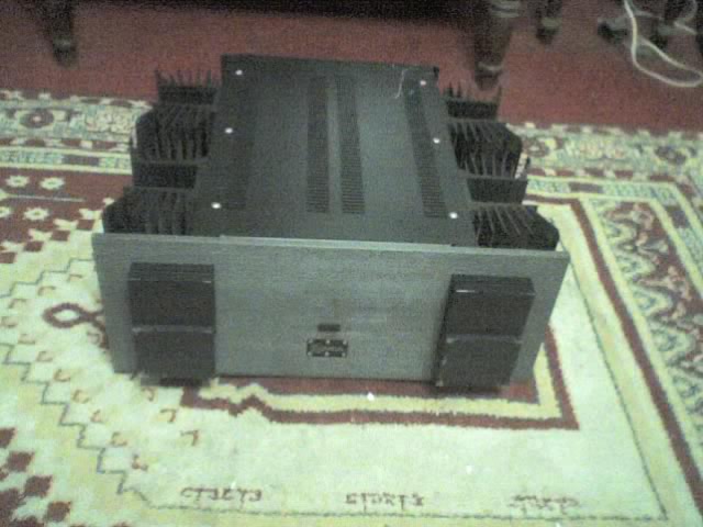

Some of you might remember that I was looking for some fanblock heatsinks a week or two ago to simply do a easy swop of the amplifier module in my existing KSA100 without having to dismantle everything. In the back of my mind I was also on the lookout for a good amp carcass that can can be used for the 100.2 clone. My experience with the local metal shops has not been that positive and I want an amp that also looks good.
The outcome of my search was that I ran across an KSA150 of which one channel is overheating and low and behold another KSA arrived at my house yesterday....
Jozua
