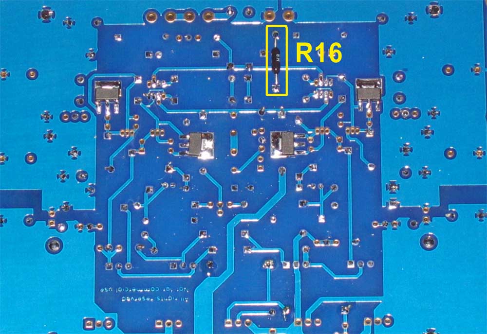

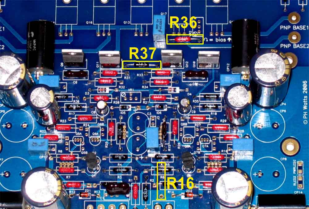

The resistor value in the place of the jumper is very flexible. he current drawn through it will be around 40mA so 10R will not even be a 1V drop. One thing to bear in mind though is that the higher the resistor is, the slower the front-end will turn on and thus be more likely to produce turn-on thump. A muting relay will therefore be a good idea. Instead of a timer controlling the relay, Krell used a DC protection circuit since turn-on thump is essentially DC offset misbalance, and thereby got two birds with one stone.

None the less, the "resistor thing” was well discussed at the beginning of the thread and I skipped over it, oops! I will post pictures of my resistors & boards. As it turned out, it was a “no-brainer” and the boards are indeed perfect! Thanks again guys; MarkG, PWatts, Flodstroem and everybody else for making it happen.:drink:
I’ll try the 10 ohm resistor and when I get the basic bench amp running I’ll work on the delay-on relay thing.

Thanks for the input BTW! Here is how the simple resistor task turned out on my boards:
Shawn.

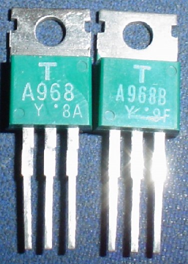

First Green, later production ones with the twisted T logo are black.
The suffix versions have a higher voltage rating.
Toshiba has an arm up KEC in Korea, these devices can also be Korean made with K A968 and K C2238 markings.
Manufactured under Toshiba license, equal devices, i can post a piccy of them too if desired.
(No touchy Chinese versions, make you sick.)

I also thought of that, but there must have been a reason why Krell used the 2238&968 for the predrivers and not the drivers? There isn't a big cost difference so it can't be that, or maybe there was a big difference back in the 1970's and 80's?
The 15030/1's have been used for drivers for most good amps on the market for several years now and they're quite good, but if Krell had used 2238&968 for the pre-drivers and not the driver stage too they must have had a reason.. Jacco?
