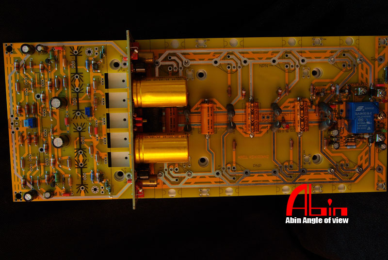

Fix said:

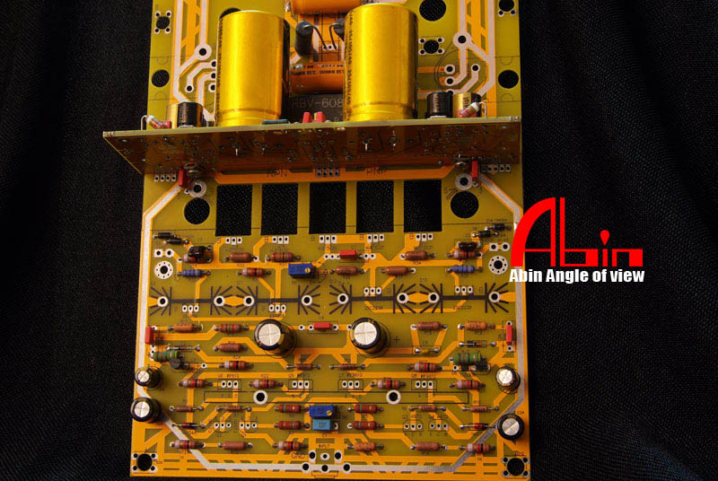

PCB test mounted on Heatsink, Emitter Resistors soldered.
[/B]
What is the white once? (I have black)
I need to replace them on my original Krell KSA 100 MK2
If you are refering to the white resistors they are 1 ohm 5Watt.
The colour (color) does not matter. Having said that I know one manufacturer that crimps the wire in the resistor to the leads for white resistors and welds the wire to the leads for their black resistors. There is also an option for low inductance wire wounds.
I doudt that you can hear the difference.

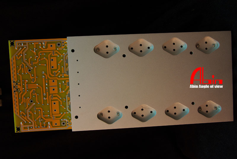

I've never had any real problems with heat, just that I wanted to be sure how Hot my heatsinks could get before getting critical.
When I look at the original design, I would be amazed if they have a temprature lower than 70c degress on there heatsinks. First they have limited air intake in bottom. Air outtake on top is less than mine... So it would be interesteing to measure on an original amp.
I have ~54.5c degress on my heatshinks now, and it tops ~57.5c when it's very hot outside.
Been playing +60h now without any problems.
Sometimes 5-7h at once.
I'll give it some more hours before starting to measure BIAS and DC it for final settings.
I must say the design is great, and it plays music in a most amazing details, deepbass, very open soundimage...

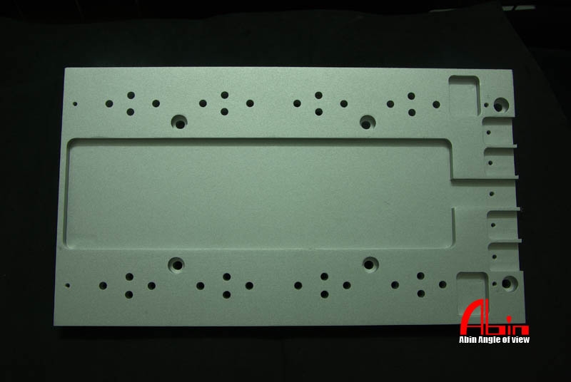

To lower temprature on the heatsinks, I would today make those heatsinks 13-15cm long instead of mine that are 11cm depending on how much space you have on the case.
Heatsinks come in 1m length so divided by 8 = 12.5cm
Then maybe you could get down temp by 1-3c ?
I've also read somewhere that if you Anodizing the aluminium would get better heatdispasation.. Prefered color is Black. Maybe that also could lower the temp by 1-2c ?
