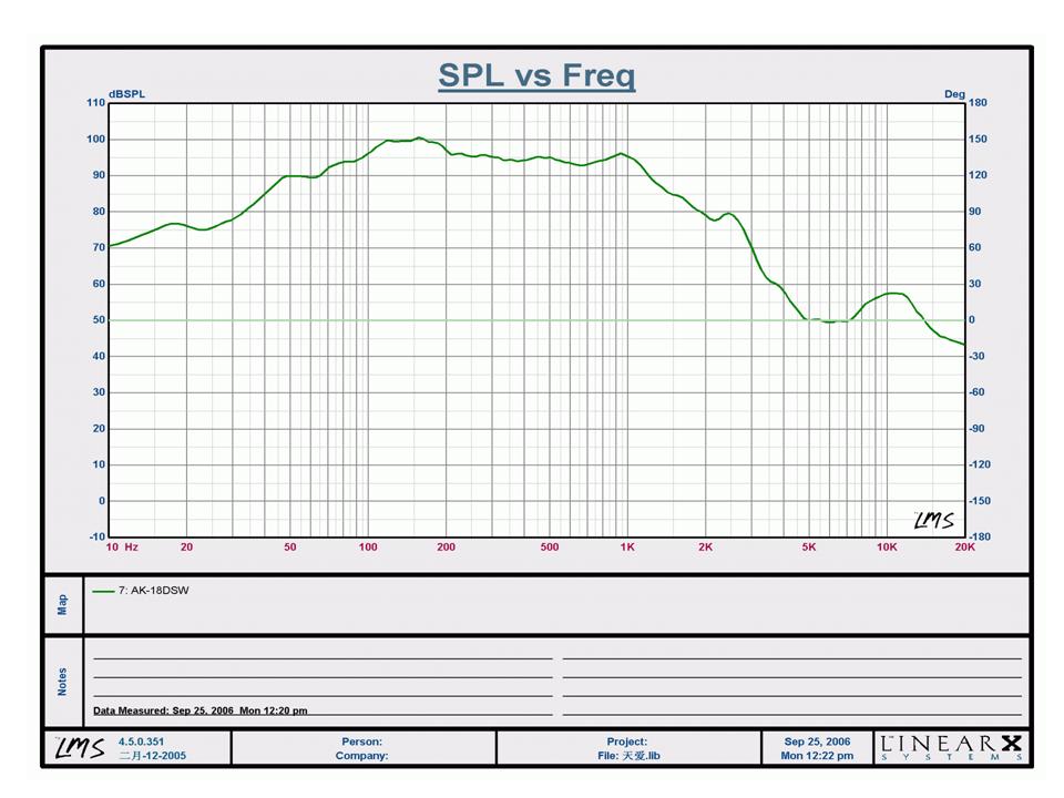

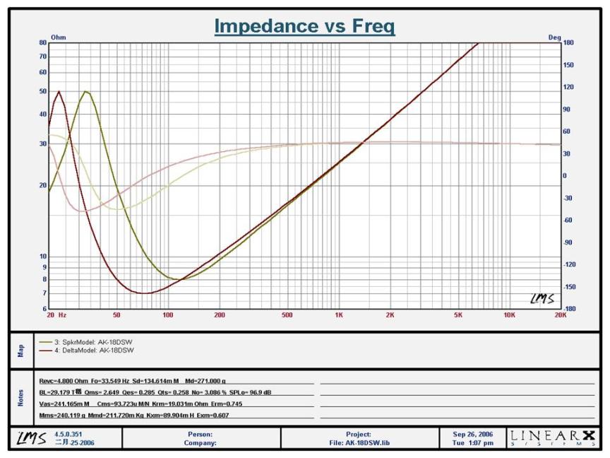

TS parameters
@ hienrich,
Revision: SPL0=96.9dB should be corrected to SPL0=103dB (103dB is right)
Remarks: Frequency range: 32Hz---1.8KHz,
RMS power: 500W. Max power: 1000W.
Expirement on WINSD mate cause there are some parameters that u may find confusing due to the units used.
Best regards,
jay-r

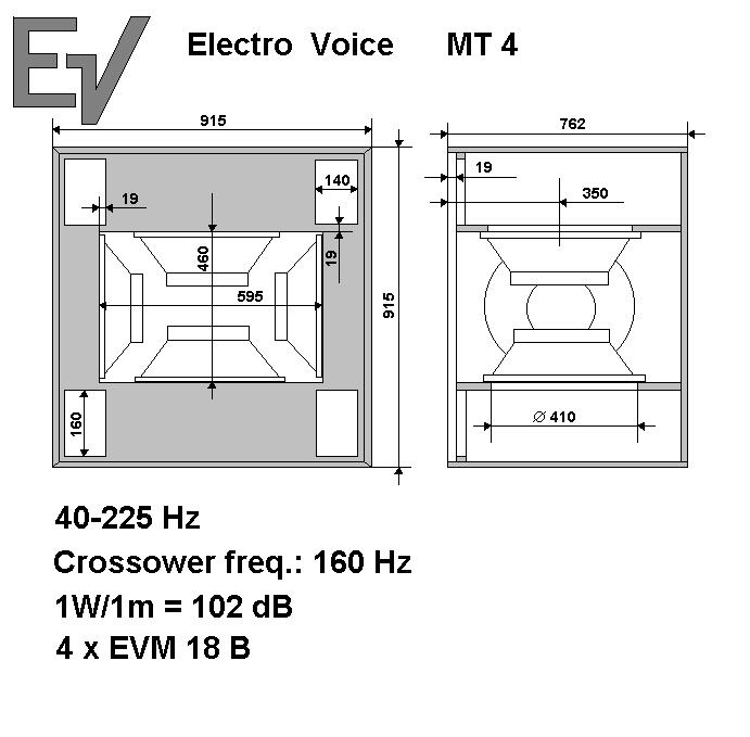

may you also advice or recommend suitable enclosures for this...
actually I'm planning for ES18bph but I don't know if this would fit in, moreover also thinking of MT2 (electrovoice)
manifold technology dual 18" enclosure, but still in pursuit for a detailed plan...
here is an MT4:

mt2 manifold
http://zmatek.jinak.cz/diy/pbaudio/manifold_technologie/show_construction.asp.html
I posted this link from the subwoofer forum section, check the tread titled "manifold 2 X 18" authored by dj marvelous, some of my colleagues has this subwoofer in their rigs, sounds good when you pair it to a " palakol" mid hi.

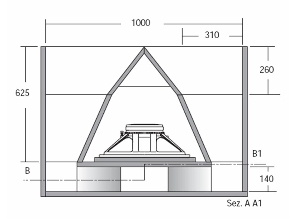

so much questions:
if they RCF'f what model?
are they the L18S800?
where to buy ? how much?
RCF's kasi ang kailangan sa Martin WSX sub, a bit more complicated design.......but throws lows at a distance...

@hienrich
Wa'y sapayan bai. this driver is best suited for PD186 BUT u have to make the rear chamber of the 186 plan slightly lower in volume.
Its like the looney bin, has a slightly bigger volume than 1850 but slightly lower volume to the 186 cab and plays 3db lower than 1850. the QTS and QES were in a range for a very good driver in a horn, while this has also high BL (29. 179) meaning this has a stiff suspension, strong motor and well damped.
what tye of music do u play mate? yes this driver will work in ES18BPH but this will produce a very tight and chest thumping bass. Good for techno and hard techno. Build at least 4 ES18BPH but if you want impressive results build 8 of them and no need for sub box under them.
