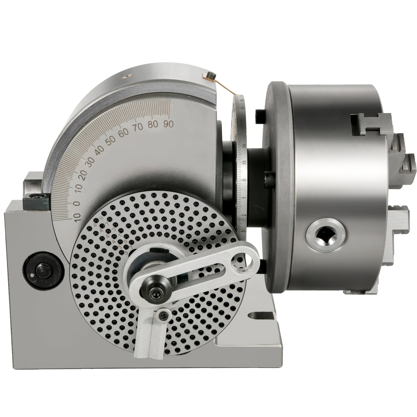

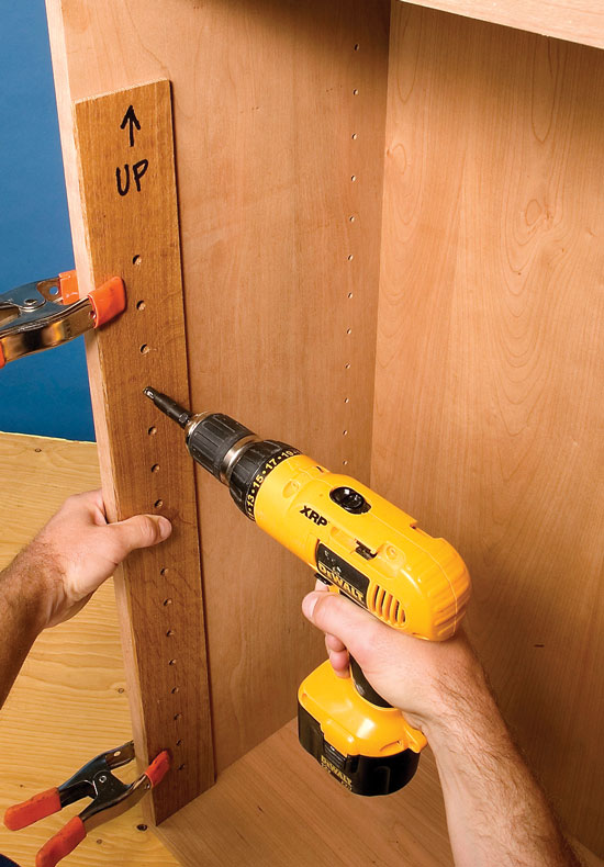

The ratchet is a mechanisim that will work. There is also much simpler holes and a pin like you would see on a dividing head. This works radially or linearly.
You drill the required number of holes in a circle pattern, and have a mic boom rotate in the center with an arm that has a pin matching the holes. This is possible with hand tools or with a drill press or mill, or if you have a CNC.
The same principle in a straight line will allow vertical adjustments that are very repeatable. And again for the mic boom moving forward to towards the DUT and away from the DUT you can have a linear series of holes.
