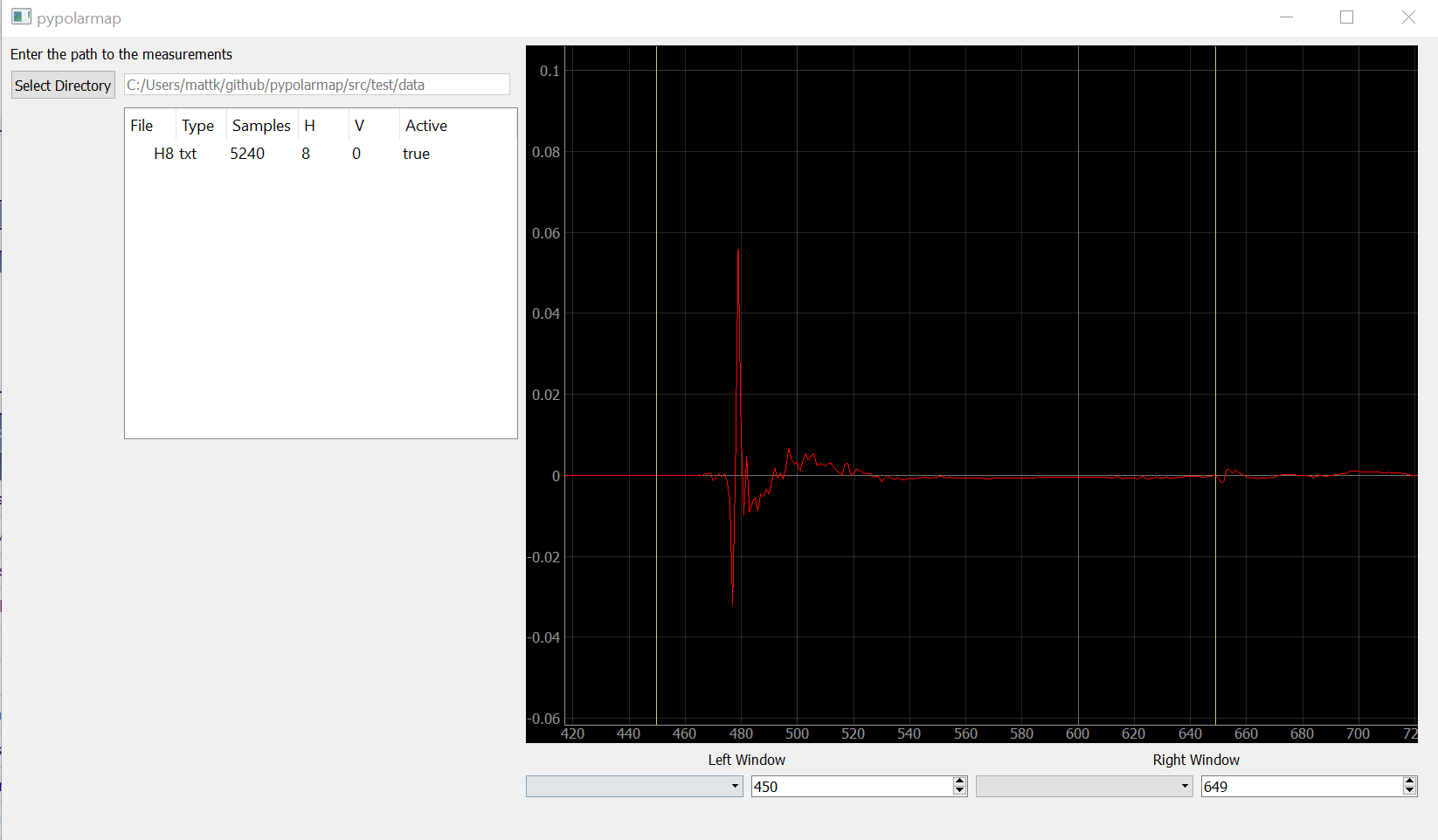

starting to make some sort of progress with a UI though I haven't put any effort into making it look pretty so ignore the fact the layout is a bit rough
this can load measurements from a folder and display n impulses in a chart, the chart widget has built in mouse controls for panning and zooming and it seems to move v smoothly. I've added draggable lines (the yellow lines shown) and these are connected to the spinners below (so dragging updates the value in the spinner as well as updating the spinner moves the line) to verify that I can handle user interaction with the chart and determine things like where they clicked or what moved where.
Code is visible at pypolarmap/src/python at wrapper * 3ll3d00d/pypolarmap * GitHub if anyone wants to poke around
I think the next steps are
- use those markers to create windows
- allow the user to see the windowed IRs
- feed that into the fft & lintolog functions from the @gedlee's dll
- plot those results

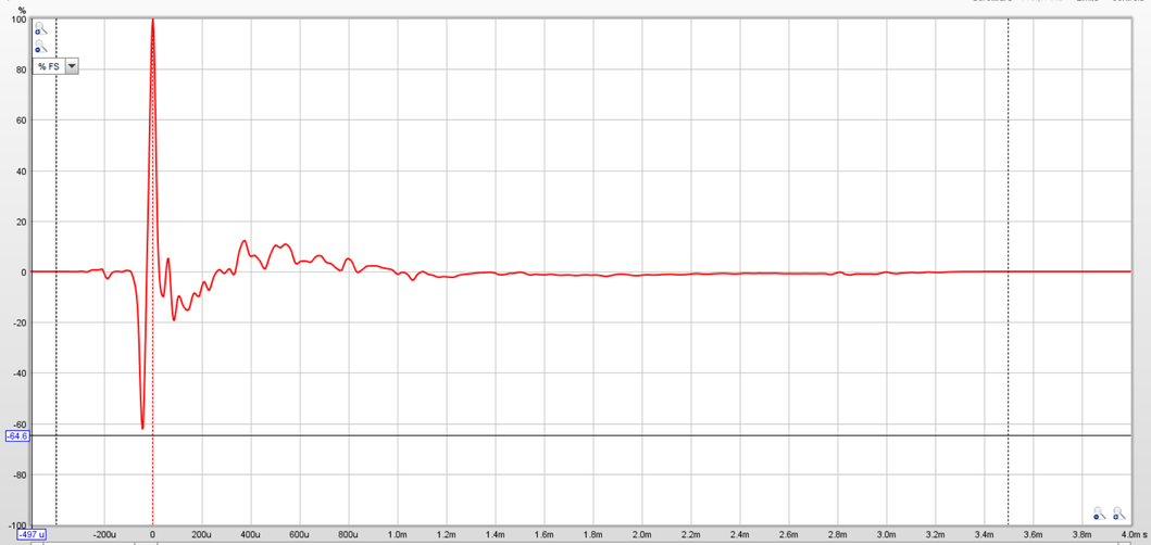

I added the gate & window which you can see in pypolarmap/impulse.py at wrapper * 3ll3d00d/pypolarmap * GitHub
this is my interpretation of how something like ARTA or REW applies a window, never implemented such a thing before so appreciate it if someone can give it the once over. The resulting graphs look sane so it seems ok to me.
now to feed that into the fft and plot the result

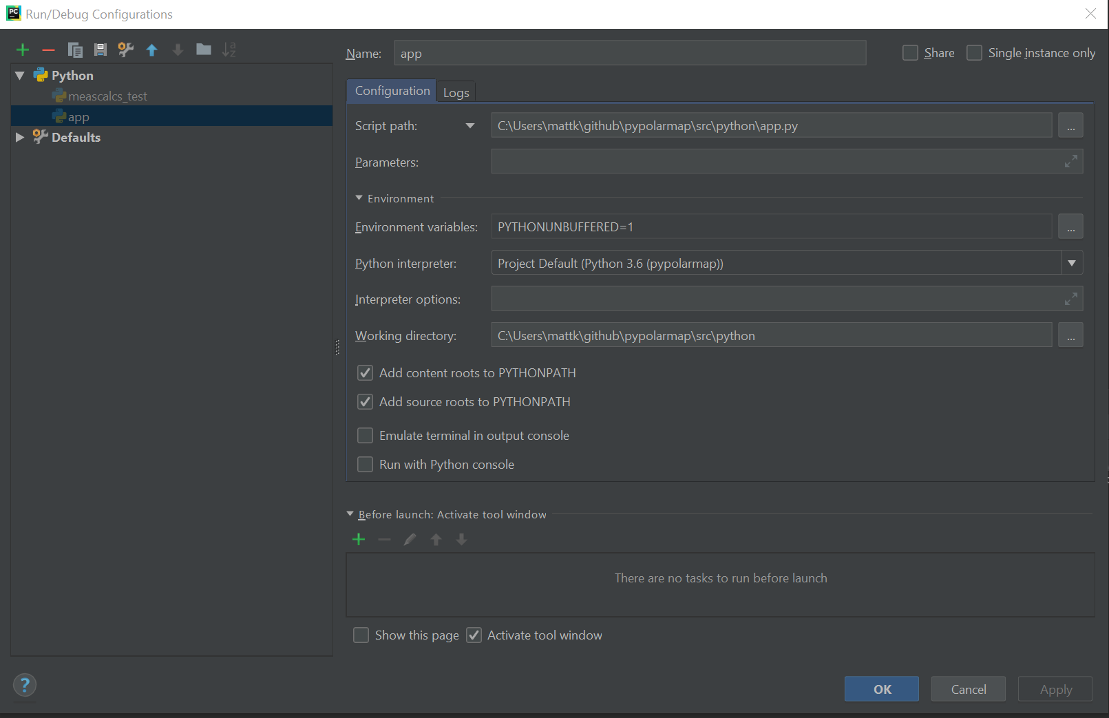

if anyone wants to run this then I think this should do the job
- download and install the 32bit anaconda -> Downloads - Anaconda
- open an anaconda shell and
note that very specific versions are listed there because the latest versions seem flaky (I hit the same problem mentioned in this issue as soon as I import numpy)
- I use jetbrains IDEs so download pycharm community -> https://www.jetbrains.com/pycharm/download/#section=windows
- install it and use it to clone my repo from github
- set the project interpreter to the python.exe in your scanner32 environment (so by default this will be c:\Users\<username>\Anaconda3\envs\scanner32\python.exe)
- open the directory (containing the source) as a pycharm project then create a run config to run app.py
- run it and away you go
note that it currently only reads files that are basically wavs in txt form (i.e. a txt file containing a load of floats, 1 per line) and also doesn't do much except stick them on screen but I thought I might as well post this anyway

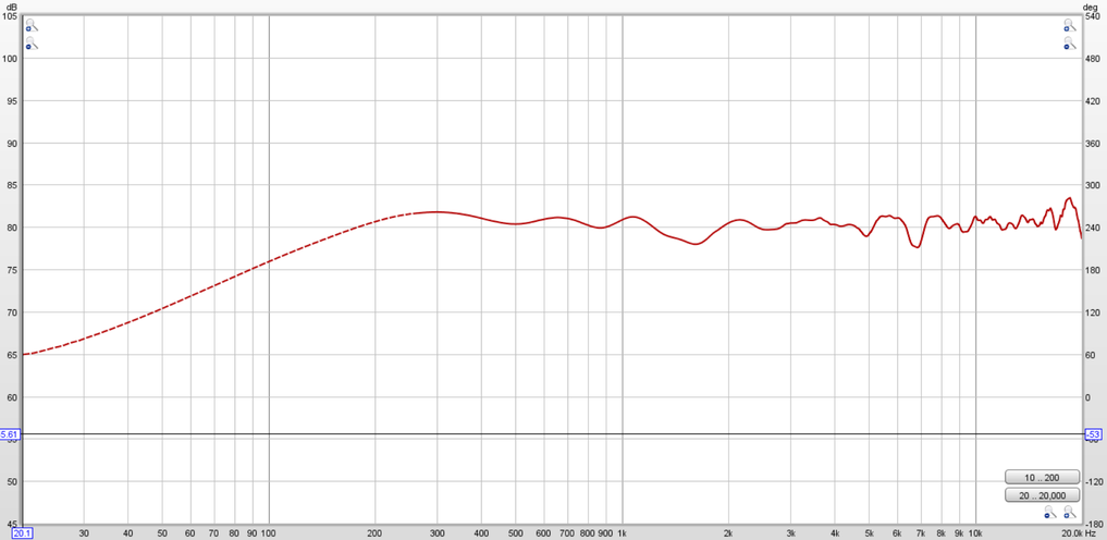

added an initial rendering of the FR using @gedlee's fft and linToLog functions
pypolarmap/magnitude.py at wrapper * 3ll3d00d/pypolarmap * GitHub
using the previously written python wrapper
pypolarmap/__init__.py at wrapper * 3ll3d00d/pypolarmap * GitHub
I'd include a screenshot but it is very very crashy atm so I can't. fft is fine but linToLog either crashes on call or succeeds and then the python process dies soon after with an error code that indicates a heap corruption. I think this implies I'm feeding it data it doesn't expect and/or can't cope with.
On the odd occasion I've seen the resulting chart, I'd say the raw fft data looks much like the FR produced by REW (so I think this backs up the above, this is working fine) while the linToLog looks a bit unstable at the low end (i.e. FR oscillates up and down)
I'm not sure how to work this out, @gedlee any ideas? I can translate the python code into pseudocode if you think that would help.

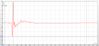

in pseudo code for a single measurement, my test measurement is some random in room measurement at 48kHz with a 1st reflection at about 3.5ms (i.e. about 170 samples)
- apply gate (e.g. left 25 samples, right 175 samples == 200 sample wide gated measurement)
- apply window (e.g. hann 50%)
- this gives you a set of samples as follows
in pictures
