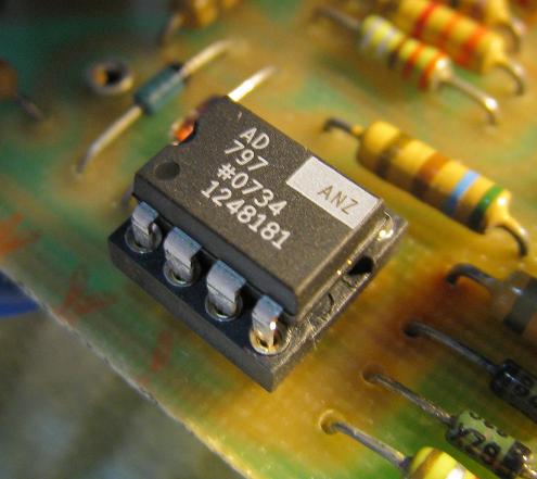

I have tried some different OP amps in the 405-2.
I bought OPA604 and AD797, hoping that OPA604 might give a flavour of what OPA627 is like at lower cost.
I didn't like the OPA604 at all. Sounded very rolled off. (Although I'm sure it will measure flat, of course.)
I much preferred the TL071, which is the standard OP amp in the 405-2.
I then tested the AD797, and it sounded a lot more like the TL071. Possibly better. Drawback is the higher DC on the speaker terminals due to the bipolar inputs of the AD797. It's now about 5mv instead of 0.5mV, so still very acceptable.
Decoupling at the OP-amp's power pins are 4.7uF and 100pF. The 100pF should have been 100nF, so I'll have to re-evaluate after getting the correct caps.

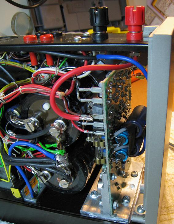

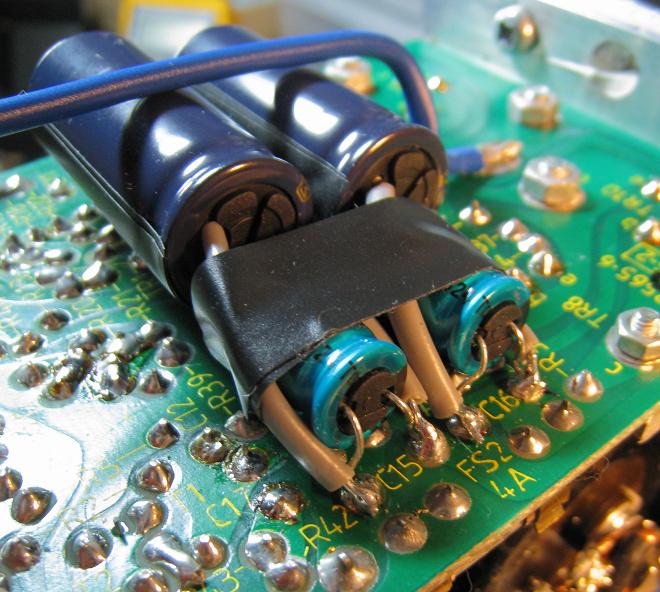

I also put two 1000uF caps directly on the boards' power rails. (I already had added 2x100uF). Another improvement in sound. Likely made larger since I still use the push connectors for all original cabling. Should also help channel separation.

If you are adding caps make sure they don't feed into the signal ground. This will couple noise etc, which is worse under load, into the signal stages.

The big caps I added went into "power ground" (I assume you refer to the 10 ohm separated small signal ground).

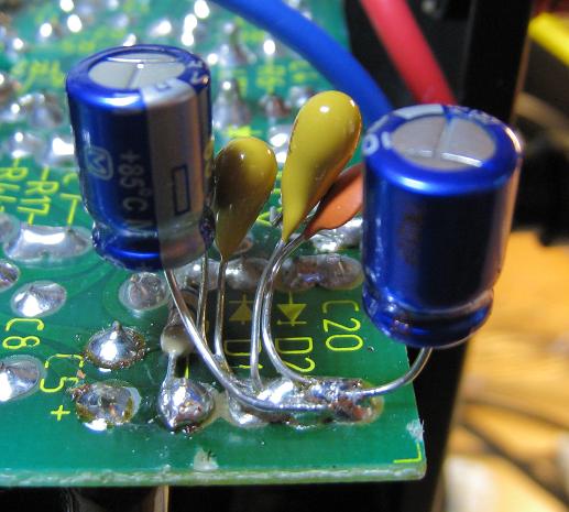

However, I tried to add 100uF across the zener and R (R7,D1 and R8,D2) for the OP-amp, since I believe the OP is starved of a proper low impedance power supply path.
That caused a lot of hum, so I never auditioned that mod properly. (Not sure why as the caps were across the small signal rails only.)
Instead I put the two 100uF over just the zeners (D1 and D2), like the smaller decoupling caps, and the result was truly jaw-dropping! (Try it!) I have only tried this with the rather demanding AD797, but wouldn't be surprised if it helps a lot even with the TL071.

OP-amp bypass: 100pF (supposed to be 100nF, to be fixed), 4.7uF tantalium, and 100uF cap.
Edit: Apart from a jaw-dropping improvement in sound quality, the 100uF also lessened turn-off thumps (which were initially worsened by inserting the AD797).

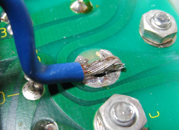

Power ground. Goes to speaker out neutral post. Replaces screw that sent power ground into chassis (via various screws and even thermal paste!). Knee is due to additional mod, I'll re-do the cabling later. Lot's of prototype type stuff for now!
