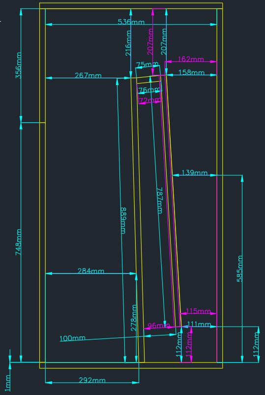

So I have been drawing up the keystone in CAD, but because i'm working with 18mm wood thickness and I can't use Arts exact measurements as the 3/4in = 19mm. Yes that seems minimal but that equates to changes in the horn heights that may or may not be significant (I don't know). I have attached an image to try to show it. But I have included some possible changes in magenta by shifting panel H 4mm closer to the driver to match Art's original S1.
Does this make sense? Am I worried about nothing? Will it make any real change to the actual sound?
regards Dane

Changes of a mm won't affect output, though I don't understand why you would change the panel H length- Hornresp inputs were approximations of "as built", done after the cabinet was finished.
I haven't changed the length of H. It the same 31' or 787mm. I'm actually trying to build as close to your as-built measurements as possible. But I cant do it exactly as my material is not 3/4 (19mm), but actually 18mm.
So my internal volume is slightly larger (2mm) and then if i add the internal panels, I get a 4mm difference.
But as you mentioned it's probably going to make very little difference to the output. Think I might be just splitting hairs.

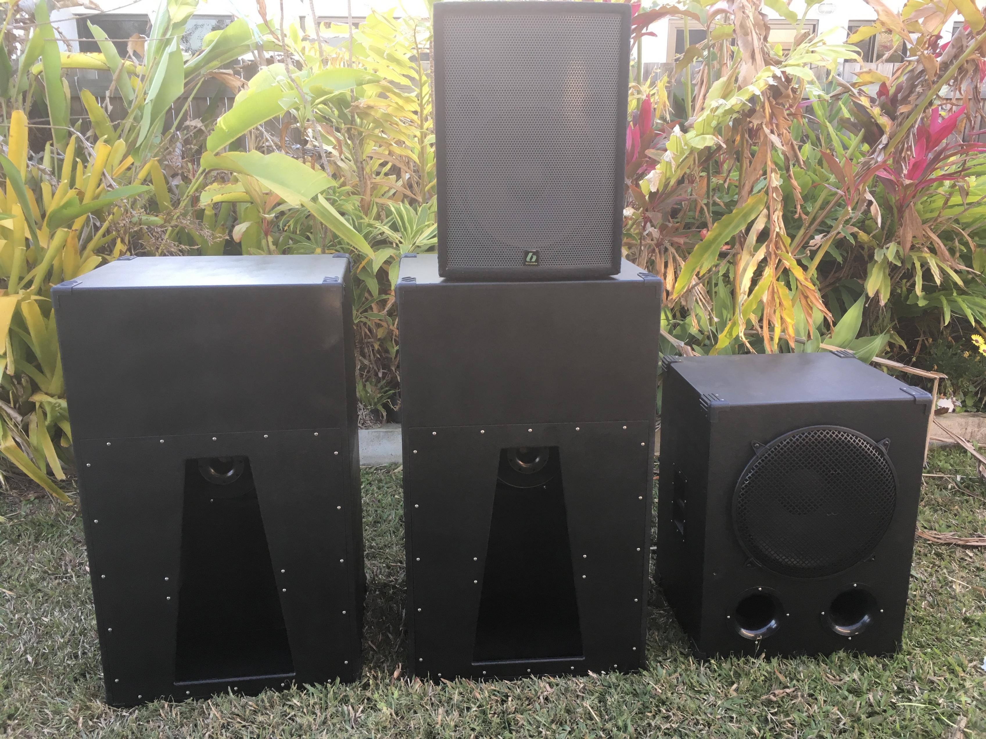

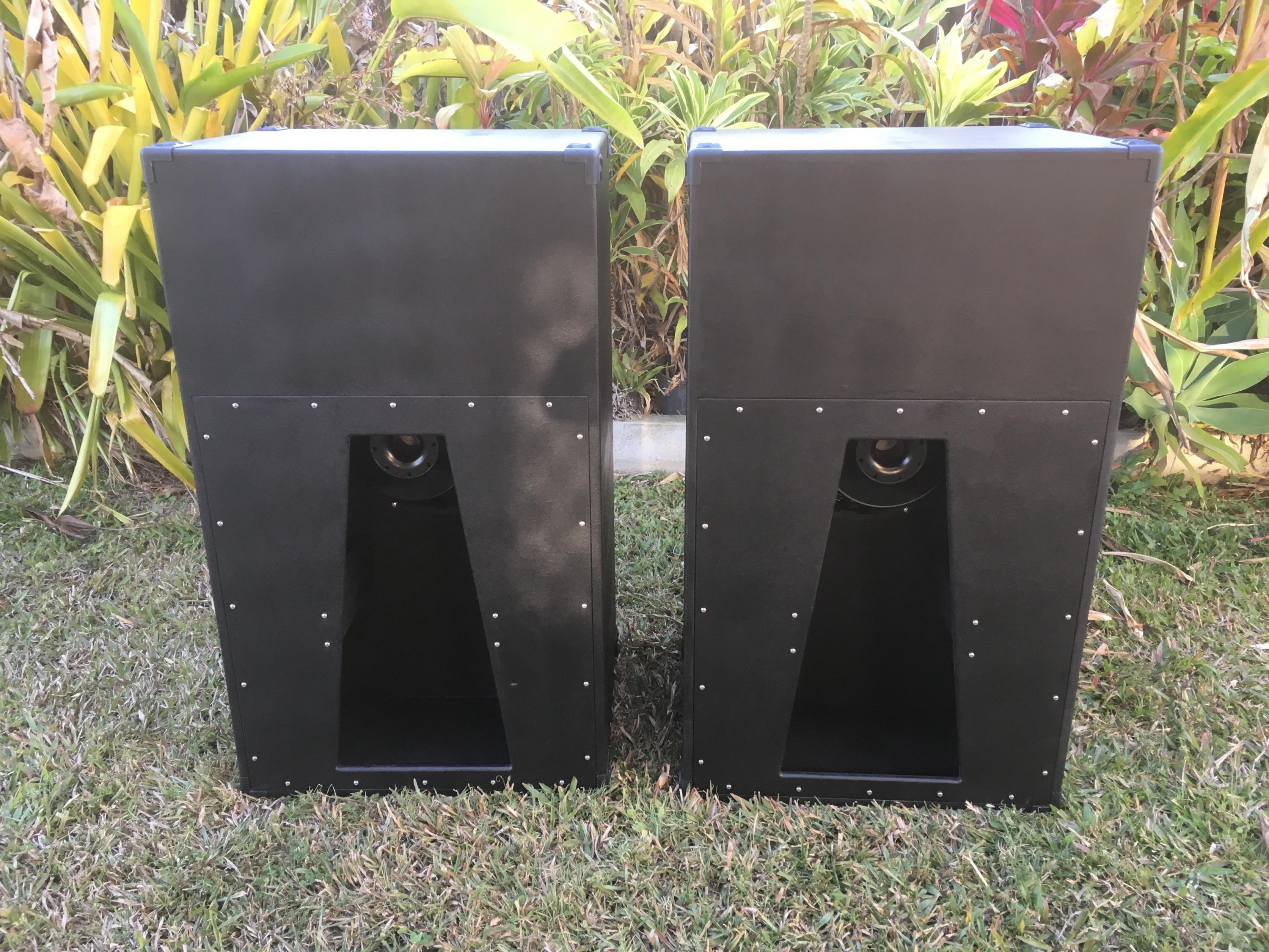

My 2x Keystones with BC18TBW100-4's build has finally completed. Woohoo
Yet to do a full noise test, but at an excessive volume inside a residential house I'm very pleased. :D Thank you Art, and others who have helped out in this thread. :cheers:
No I didn't end up putting handles on, but heck they are heavy Haha (I was warned)
My previous "big" diy sub is on the right in pic :eek:

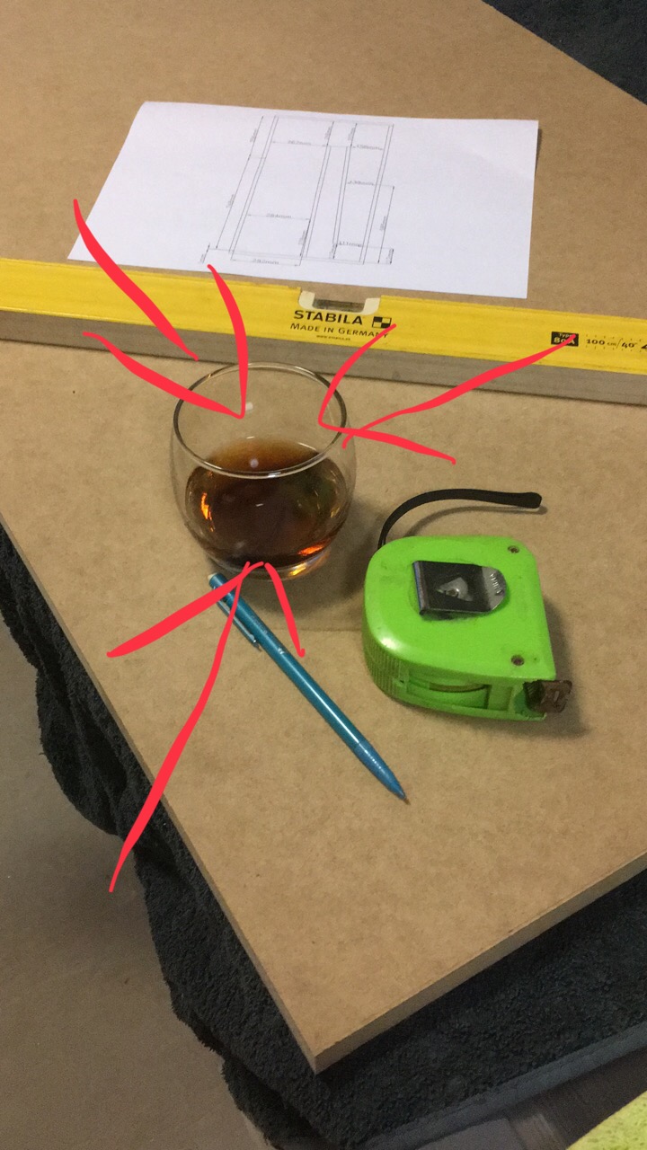

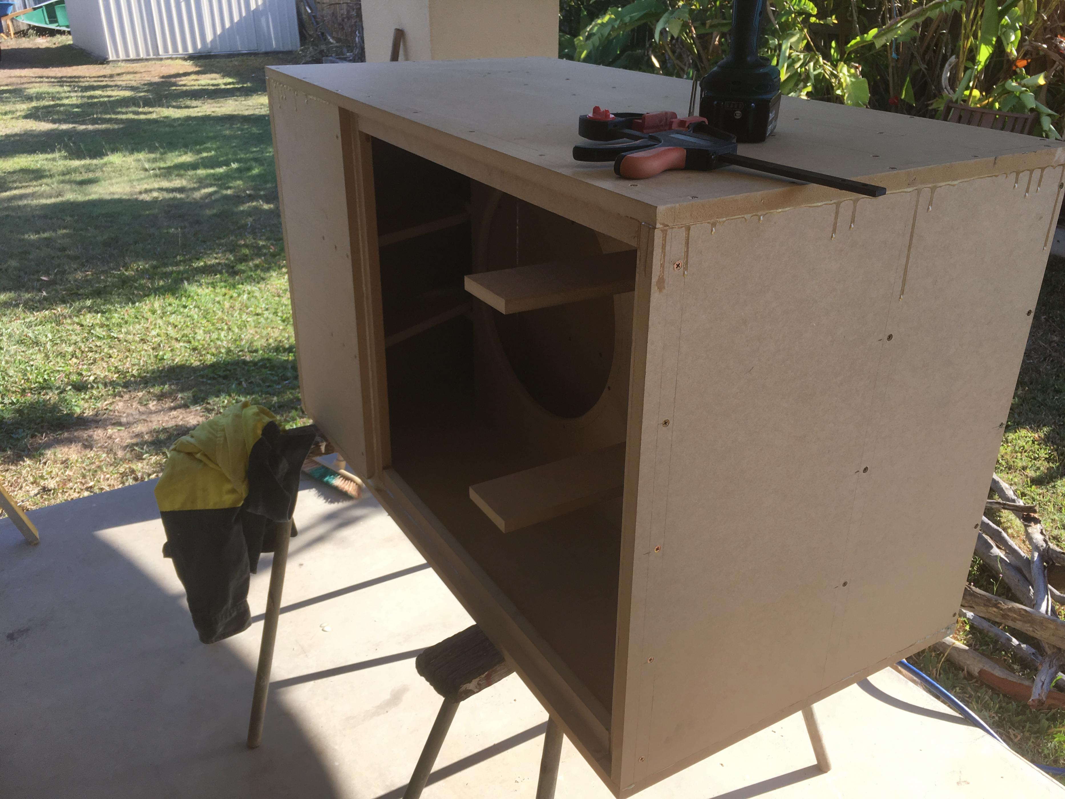

Thanks BP1Fanatic. It took longer than expected but I did dry/pre-screw assemble it all before re-assembling it with glue. And when your only cutting with a circular saw, tape and level, it takes longer.
Actually I made one epic fail by cutting the Key out the first go totally wrong angle. :eek::( Had to buy another whole sheet to replace that 1 panel :mad: But I did find the culprit for the mistake (see pic)
