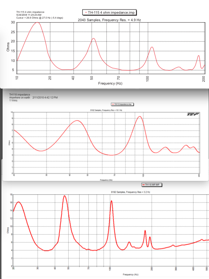

Sometime around May 2018 they had updated the TH118 impedance chart (the 18Sound driver in the original TH118 had an impedance minima of 3 ohms)without changing the frequency response chart. Oddly, the lower impedance minima somehow went up from around 28 to 35 Hz.
No impedance charts were included in the current TH118 or TH118XL spec sheets, but the frequency response has been re-measured, probably when they noticed the previous TH118 appeared more "sensitive" than the larger TH118XL.
Now THAT I'm more interested in. I remember having a lot of discussion with JAG over that, him insisting that the minor changes in the TH118 compared to the TH115 of the same dimensions is what caused the lowest resonance frequency to drop to 28 Hz, and me responding that there was no way those minor changes could have made such a significant difference in the resonance point.
The LF impedance response of the BC18SW115-4 TH-118 appears to have changed back to being more similar to the TH-115 in the more recent (bottom chart) measurement, compared to the older 18 Sound loaded TH-118 (center chart).
The first graph for the TH118 seems just shifted 10 hz lower compared to the second. It could have been a computing error.
