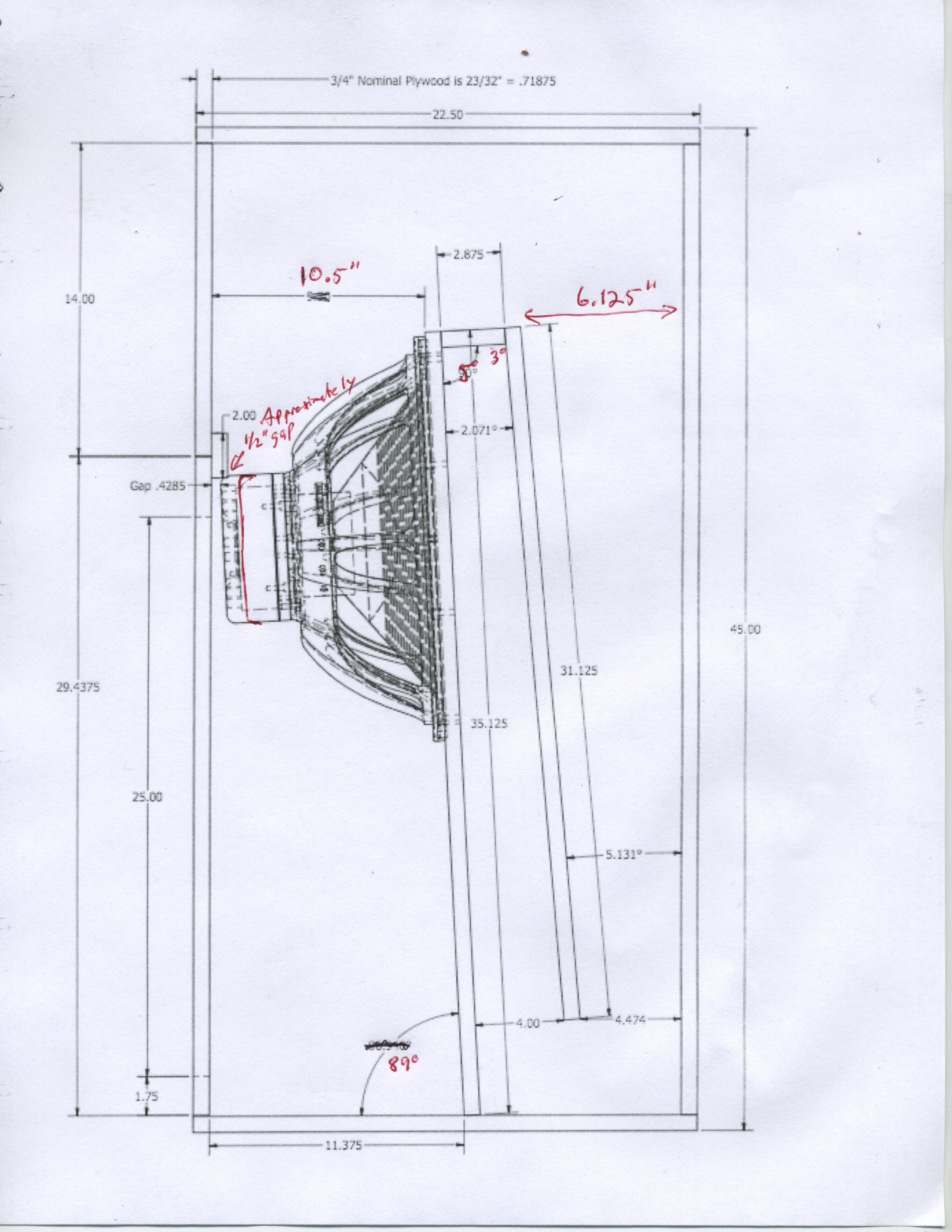

The gap is around 1/2".
There is an error in the position of the baffle in Oliver's dimensions due to my small drawing not having been corrected to the actual full size lofting of the cabinet. After measureing the actual build dimensions I caught the error now, they are shown below on your layout.
Note there are 9 braces in the cabinet:
Brace 1 (two units) in the first portion of the horn
Brace 2 (two units) in the second portion of the horn
Brace 3 in the second portion of the horn centered on the driver
Brace 4 between the top of the horn path and top of the cabinet
Brace 5 between brace 4 and the front of the cabinet
Brace 6 (two units) "wing braces" either side of the Keystone exit. Braces 6 have right angle brackets on the front of the cabinet that are T nutted in place to facilitate removal of the Keystone panel for driver installation.
Art
So..having built 4 boxes using Oliver's dimensions of 9.5" and 7.15" instead of the correct 10" and 6.125"...........what might you expect the impact to be on the performance other than driver clearence ?

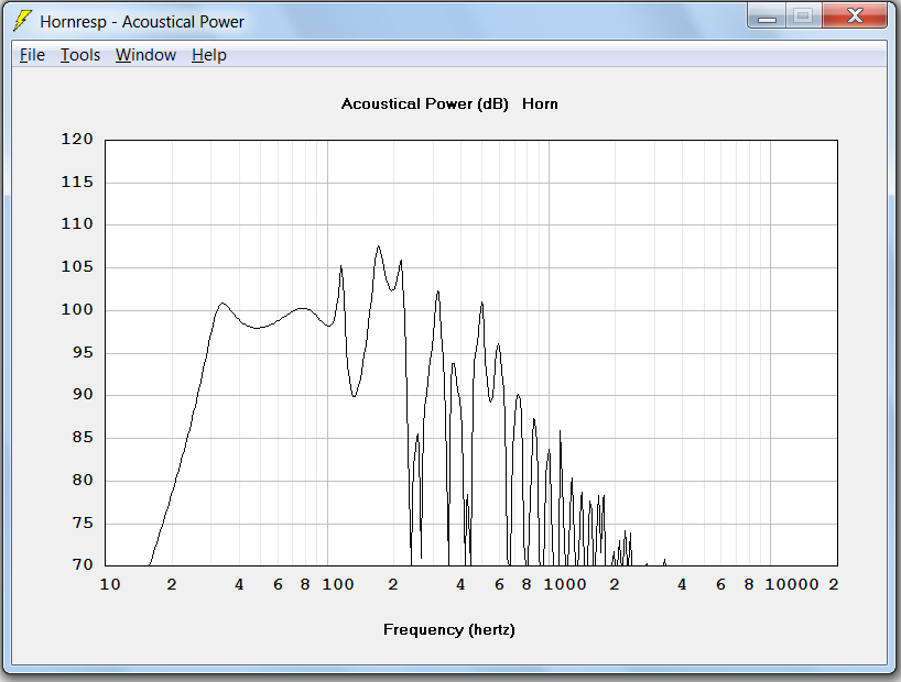

To further illustrate your point that anyone make draw up a cabinet. Here's is my cobbled together sim for the KS 4" taller and 5" wider as suggested in the thread. This was obtained by adding 20% to throat area and 10% to length purely done for giggles and learning more about HR. (flame suit on) :D

Oliver,
I screwed up the dimensional update in Post #451, when measuring my actual build template I accidentally measured the distance between the driver flange to the front panel rather than the baffle. As anyone who can add the dimensions could tell, they don't add to 22.5", but I neglected to "do the math" before posting.
Dan's updated drawings were again going off my incorrect posting, so he could not identify which dimensions were wrong.
There is plenty of driver clearance with the proper 10.5" front panel to baffle dimension, so no recess using a laminated baffle as you suggest is needed.
Art
Hi Art,
There still seem to be some minor problems w/ the dimensions. The 10.5 and 6.125 @ the top turn-around will give you a duct height @ S1 of 3.024 instead of 2.875.
At the bottom 180° the length in the middle of the turn is the longest of the turn dimensions.
I just started to draw on this for my reference, and thought I better let you know about this. I'll attach my interim work.
