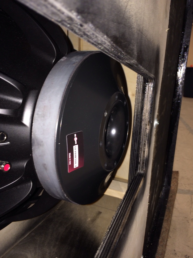

Do you think clearance for the motor to breathe would have made a difference in cooking the driver?
Keystone Sub Using 18,15,&12 Inch Speakers
Possibly, but so would not bypassing the limiters on my iTech :D
There are small vents where the magnet meets the basket as well, lots of ventilation going on in these drivers.
One would have to try both ways and measure the difference in response.

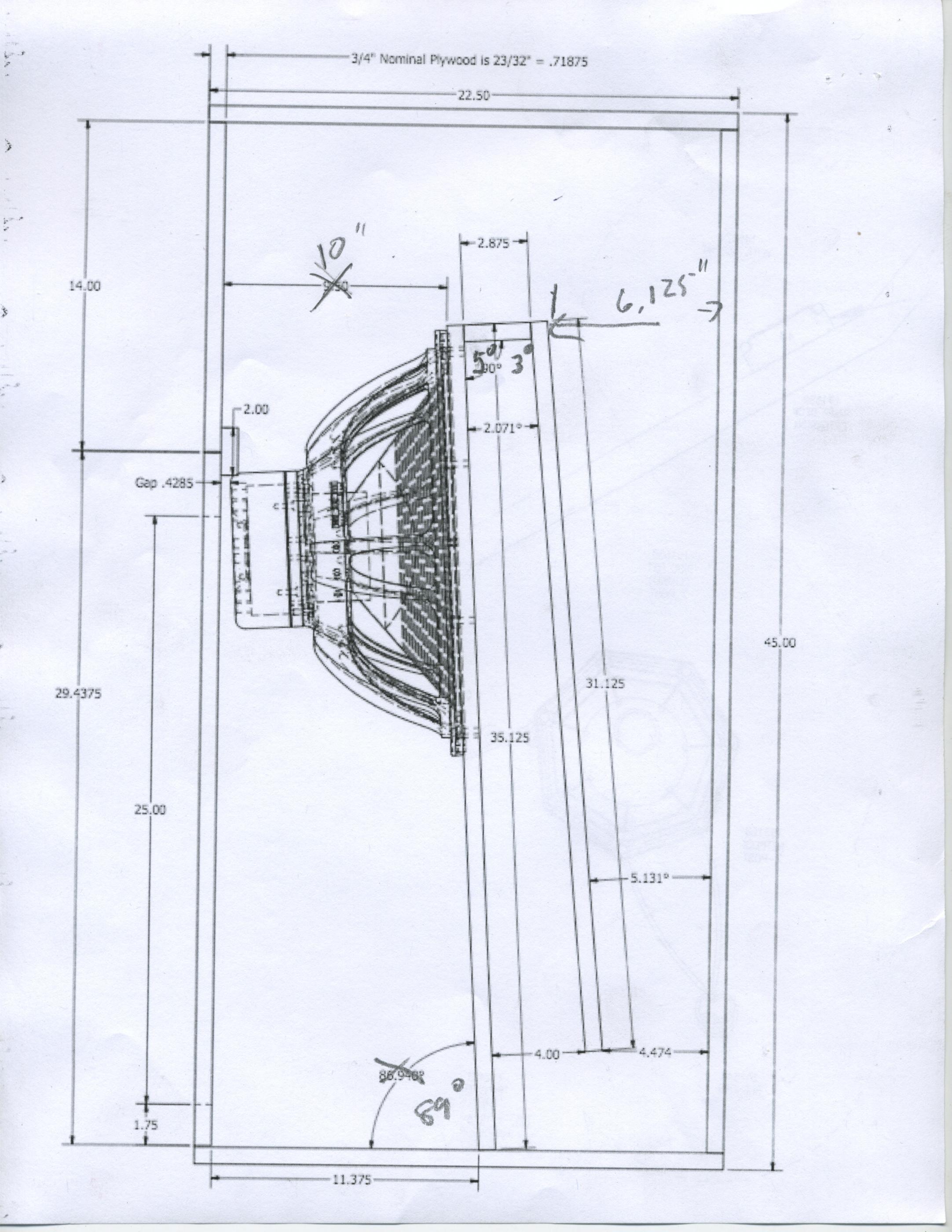

Edit: I used Art's sketch as well as Oliver's drawing, I made my own drawing with in Sketchup that showed all the finer details I had decided on.

The ring of holes directly vent the magnet-end of the voice coil. I'd leave those as unrestricted as possible, as you can get quite a lot of air movement when excursion gets going.

The gap between the motor and the inside of the front panel looks like it could be more than the thickness of the plywood?
The gap is around 1/2".
There is an error in the position of the baffle in Oliver's dimensions due to my small drawing not having been corrected to the actual full size lofting of the cabinet. After measureing the actual build dimensions I caught the error now, they are shown below on your layout.

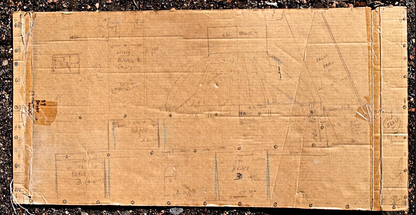

Note there are 9 braces in the cabinet:
Brace 1 (two units) in the first portion of the horn
Brace 2 (two units) in the second portion of the horn
Brace 3 in the second portion of the horn centered on the driver
Brace 4 between the top of the horn path and top of the cabinet
Brace 5 between brace 4 and the front of the cabinet
Brace 6 (two units) "wing braces" either side of the Keystone exit. Braces 6 have right angle brackets on the front of the cabinet that are T nutted in place to facilitate removal of the Keystone panel for driver installation.

The way the panels are designed, you would have to re-shape the keystone exit to be wider in the top and more narrow in the bottom
If this would be able to execute, it would be cool to be able to remove the driver throught the hole side-ways, to be able to exclude the access panel.
Other than loosing the keystone effect, is there any reason I could not make the opening on the side? I would prefer a narrow and deeper cabinet. Opening in pic is not to scale. I realize I would have to keep the access panel. Thanks
Keep the exit to around 6" wide at the top, and make it no higher than the original design and there should be no major concerns, as long as you heavily brace the panels, the "wing braces" will need to be turned to around 45 degrees. The exit will have slightly less area than the normal Keystone, which will result in a a slight reduction of the low frequency cut-off frequency, and slightly less upper response in the 70-100 Hz region.
The non- symmetrical lay out may result in more distortion at high drive levels.
Art
