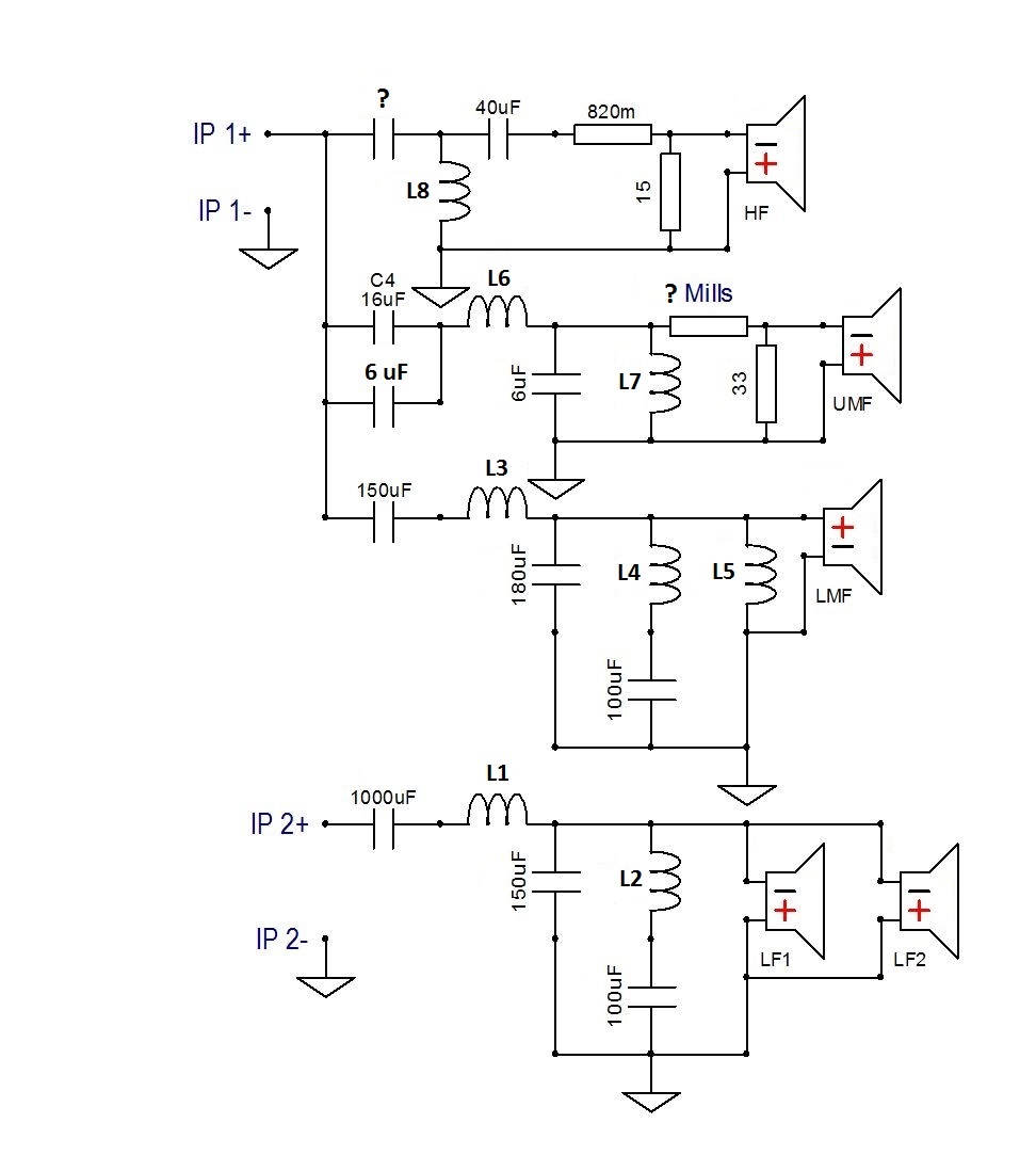

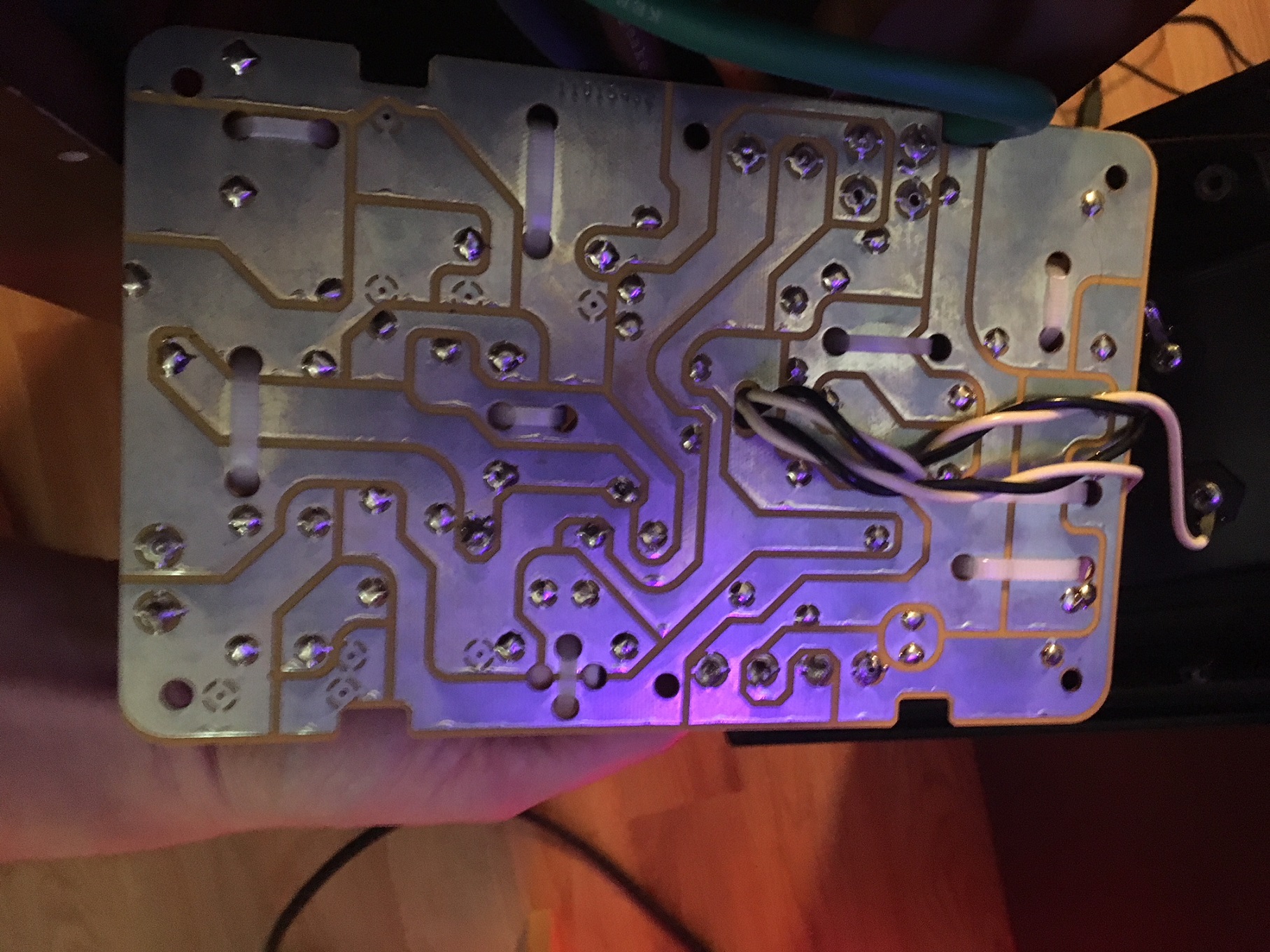

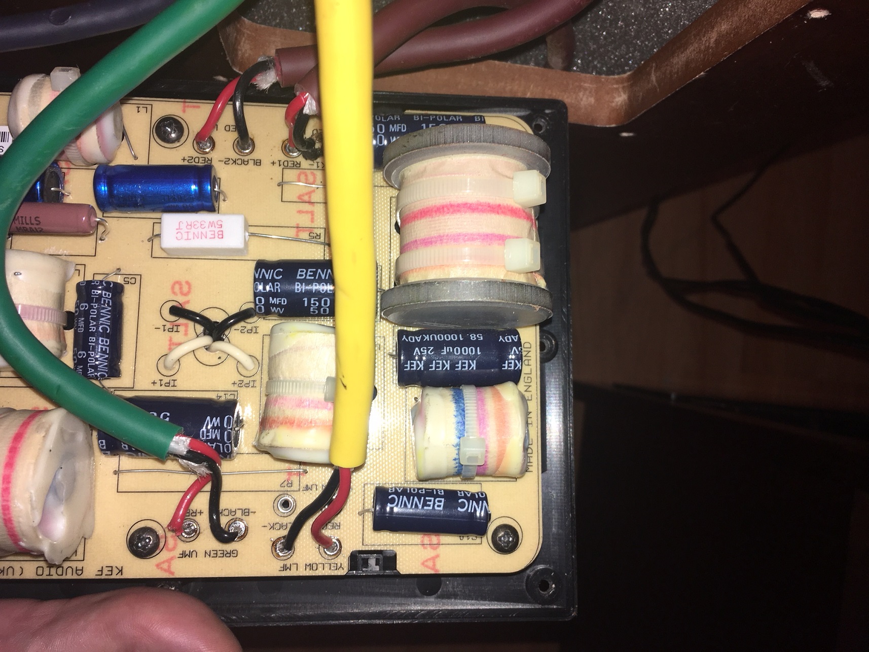

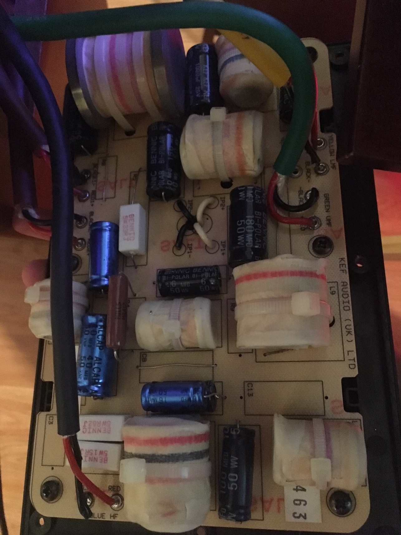

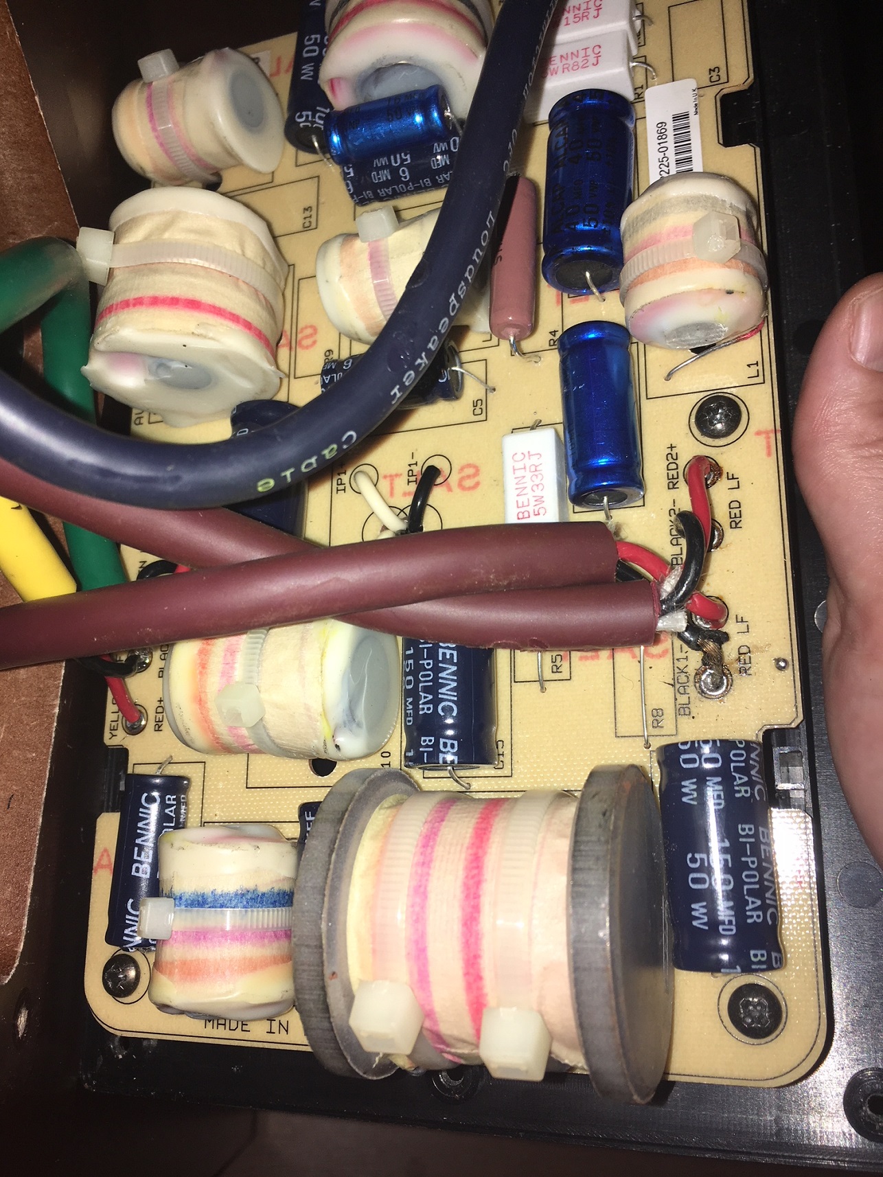

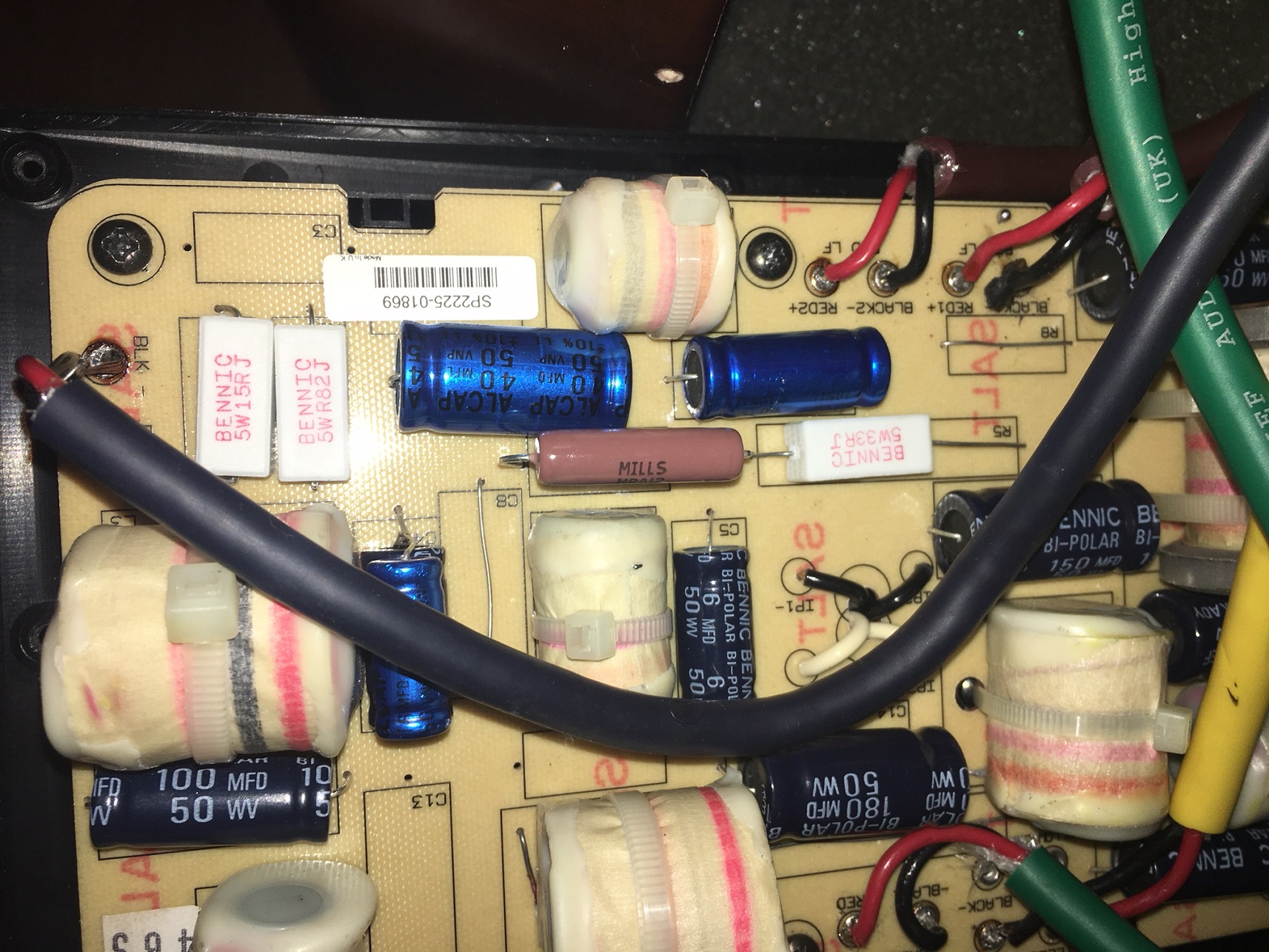

I am looking to do a complete crossover rebuild for my late 90s Model Three.
Was wondering if anyone has or knows where I can obtain schematics with component values. I want to build a fresh pair of x overs with poly caps, better overall parts quality using point to point ect, Then keep the originals untouched I can put back in if I ever decide to sell. The speakers are the original versions not the three two with boundary compensation.
Thanks in advance.

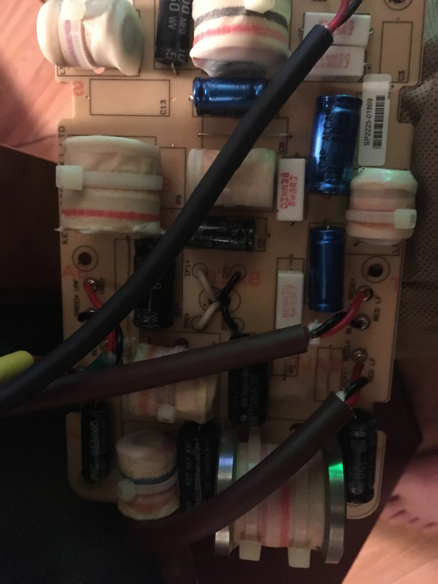

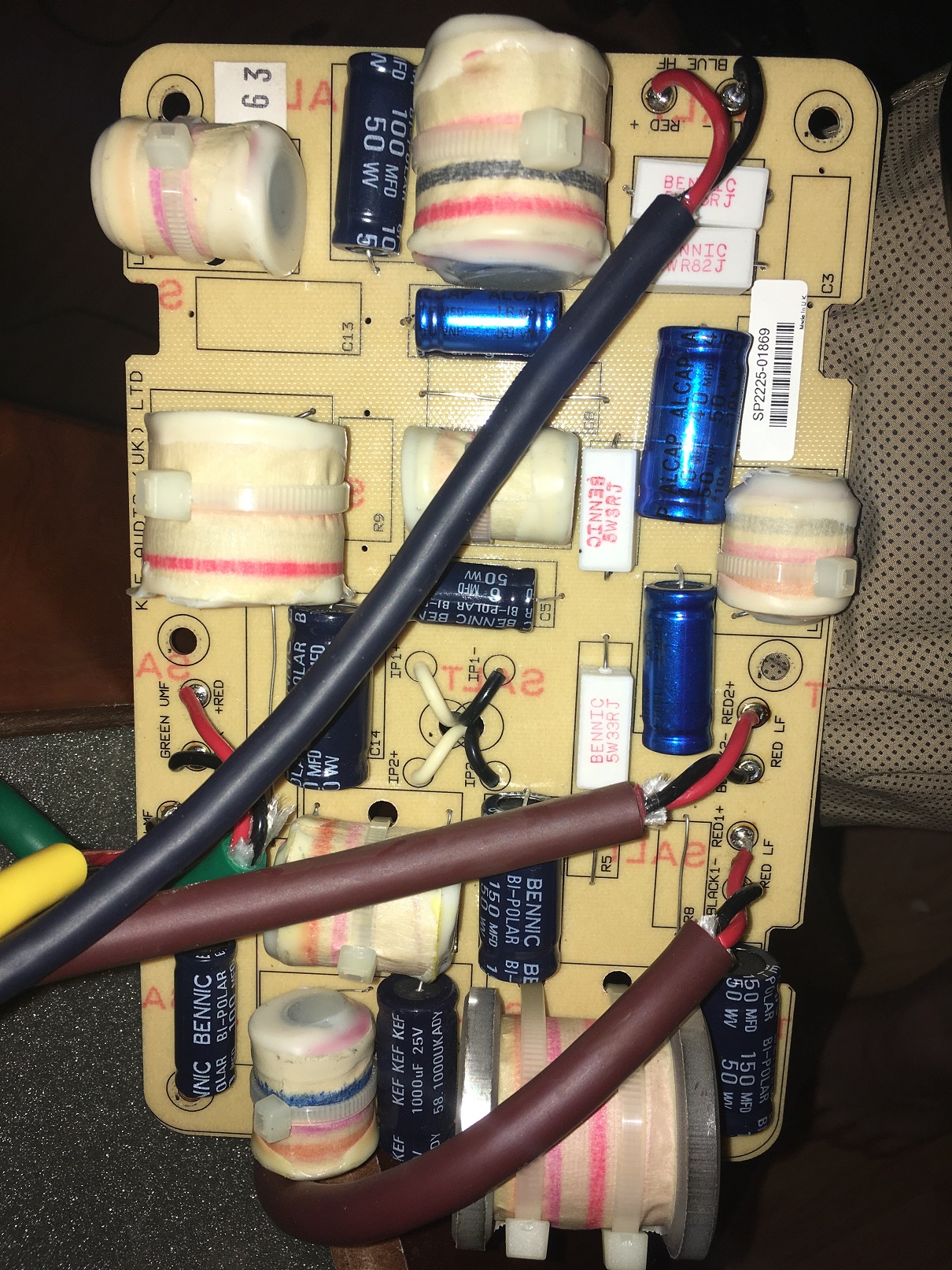

That would be great.I do have dats V2 as well as a capacitance meter to do measuring (multi meter is packed away somewhere). Wondering if I would need to remove each inductor to get an accurate reading or if I could just read direct off the boards.

One inductor leg should be out of the circuit to get a reading but that might be more trouble than just desoldering both and pulling it completely straight out without hassle. Get a desoldering wick for easyness, if you already haven't got one. I'll try to work it out the next day but I can't promise.

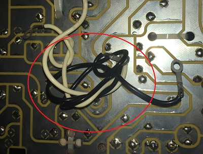

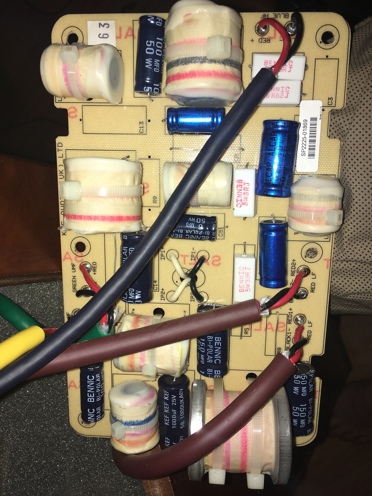

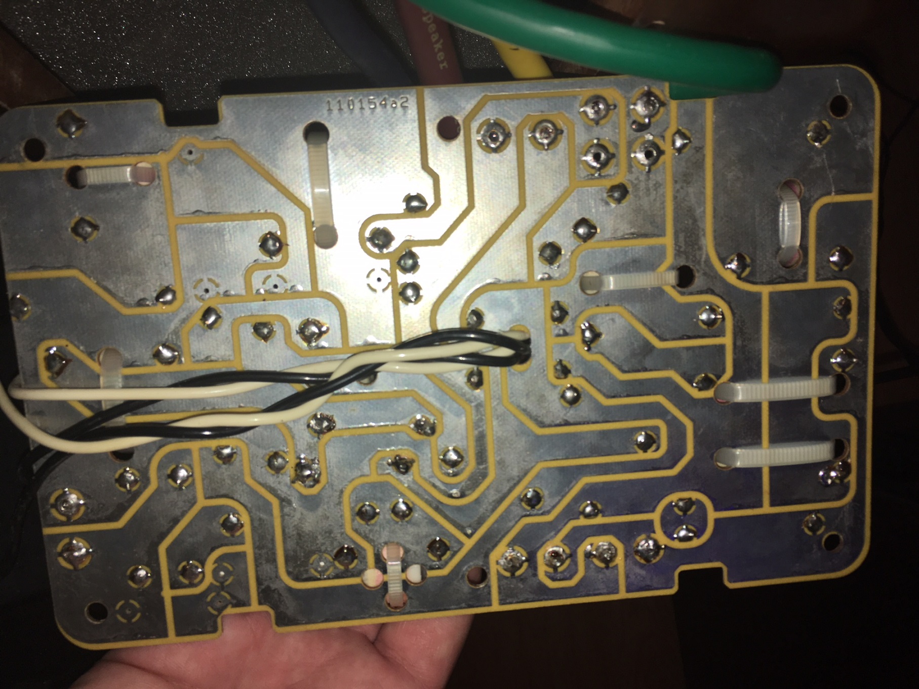

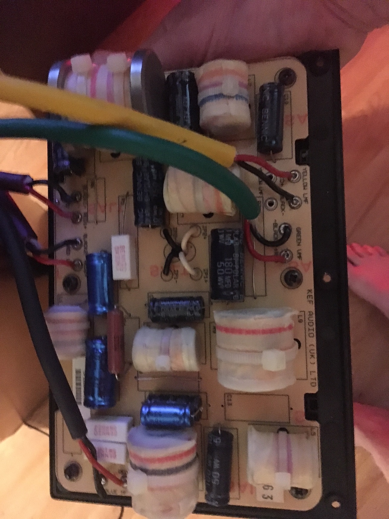

Took a few more shots from different angles with and without flash . Hopefully this will give you a better look and more easily see small things like jumper/bypass leads ect...

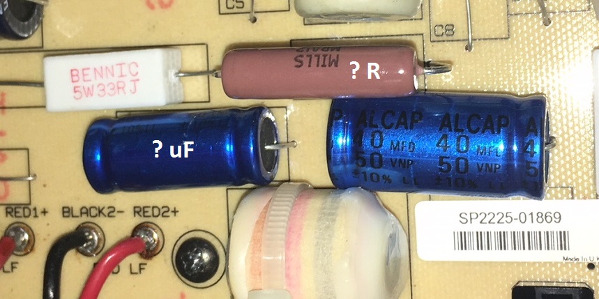

oh of coarse it looks to be a 5mfd cap and the mills resistor i placed in there as a replacement with a lower value to help tame a large curve in the impedance measurements. It only helped a little. The measurements weir taken with Dats 2 software and strange;ly are far from flat but match left to right pretty close.I will upload what I have as far as those measurements go if I can find the files.
Here are some of the measurements I took a while back. I will update with the inductor values when I get a chance to pull apart and measure.
