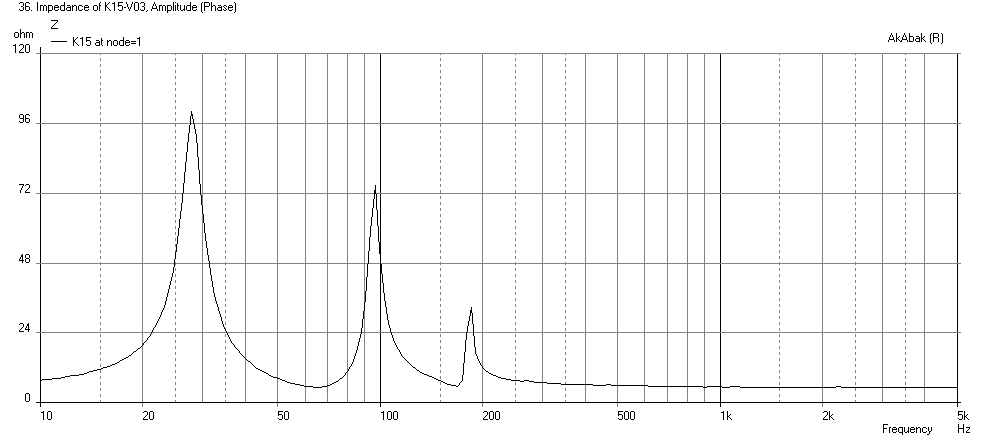

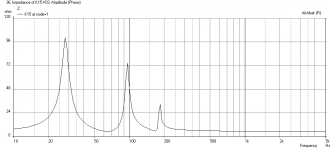

Regarding your K15 impedance trace, its general form is fairly good, though the rear-chamber should tune around 45Hz I believe (1st impedance minima) and the front chamber ~115Hz IIRC (2nd impedance minima).

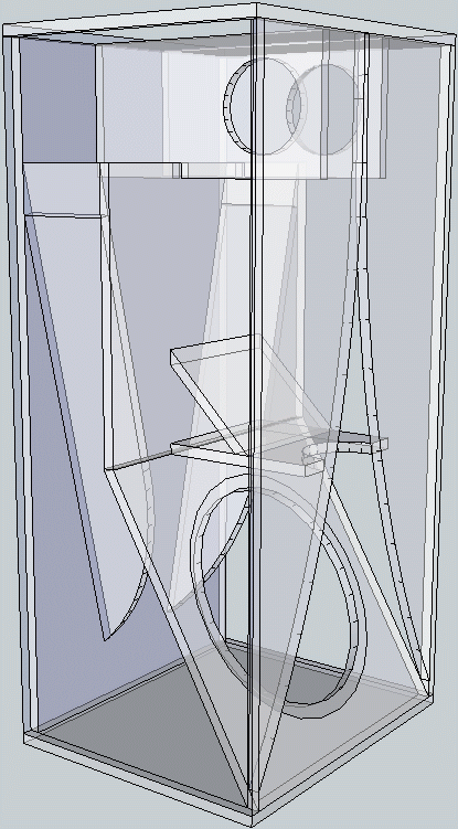

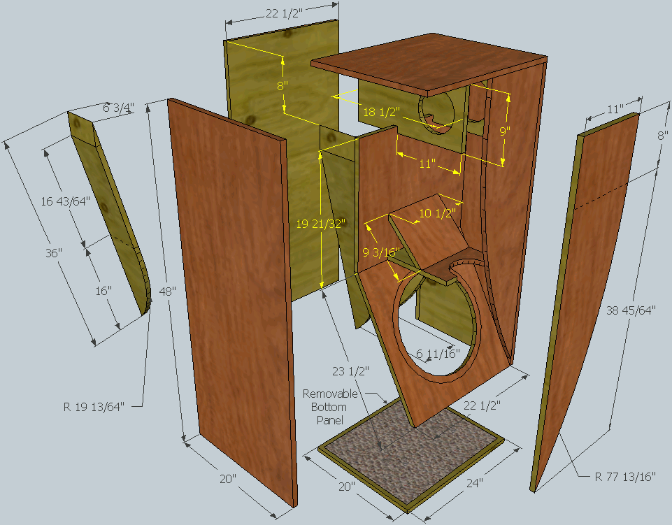

Those do look very right for K15 with Kappa12. (I built my first with a DeltaPro12)
Here's one I dreamed up on a hunch with no scientific basis and never built.
Wonderering if its possible to model by your method or not?
At least I have internal dimensions to work with, not just a rough outline.
Sized for an 18 I would assume....
Kenpeter,
That's good news to hear that the response looks correct for K15 with a Kappa. Your design looks pretty neat and should get you lower bass as there is an extra folded line in the back chamber. What is the purpose of the piece of wood and angled plate in the front chamber that is behind the K-slot? Is that just a brace and to be ignored for the purposes of the acoustical path?

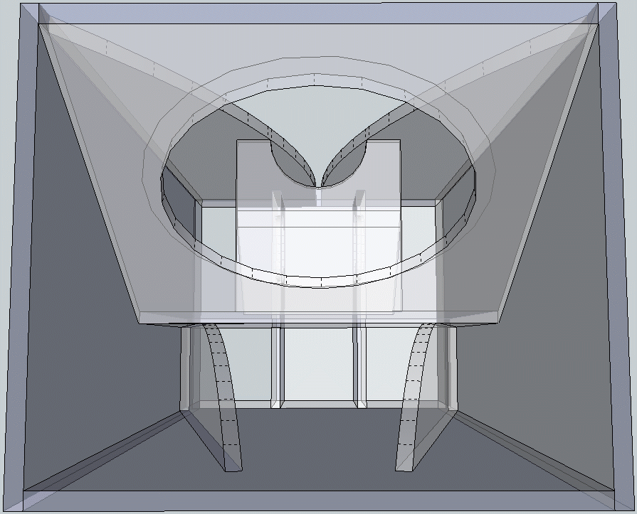

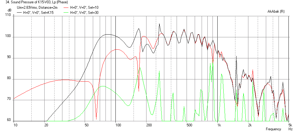

Sim of 1954 K15 with EV driver
Freddi,
I put in the cabinet dimensions from the link you provided. They are significantly different than the version that I used in the first model provided by Job Ulfman at http://home.planet.nl/~ulfman/
It made the bass sag a bit. Anyhow, with the 40.5 sq inch vent and shelfs at distances you specify with EV driver, mic at 2 m away on the ground, here is what I get. I seem to be getting a dip at 130 Hz that is not in your measurements. The location of the W is about right though. Second plot is the impedance.
Third plot is sans front shelf.
