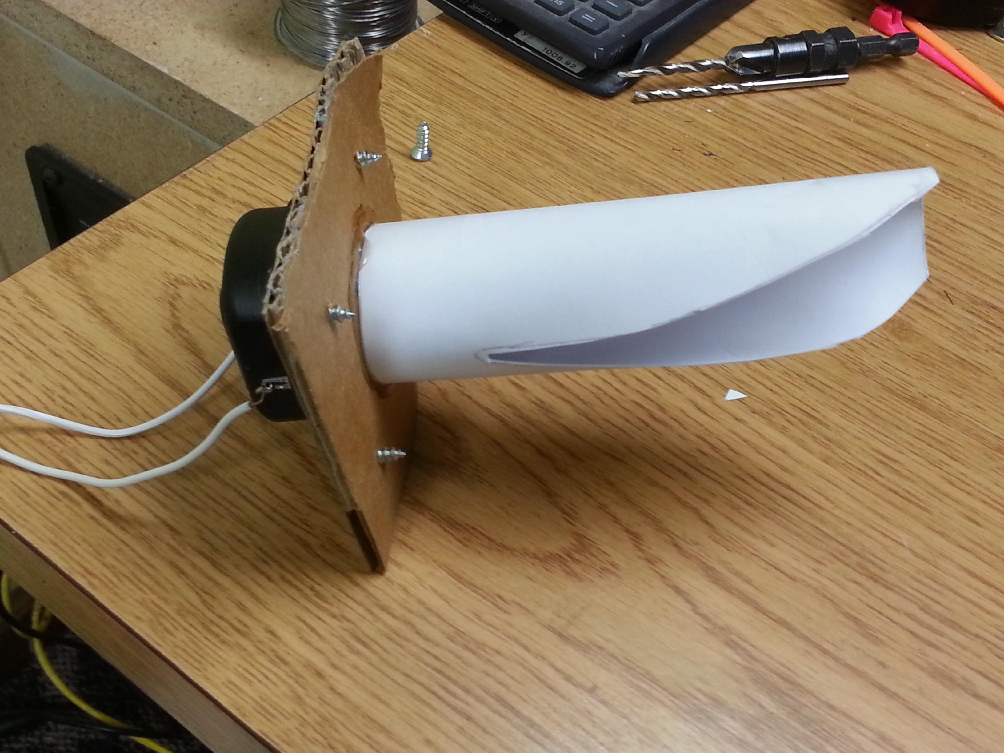

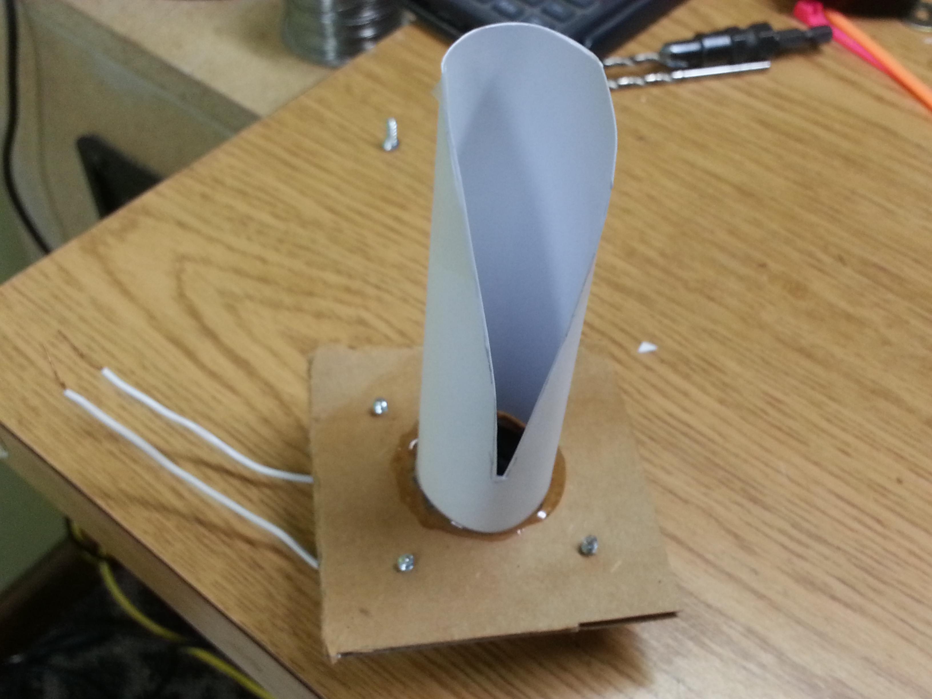

that's an interesting orientation of the K-tube's slot. For fullrange helper tweeters, I wonder how short a tube can be made and effective? - did you ever see the mini-klam tweeter lens made by Alan Weiss? - it could be something for comparisons.
Alan Weiss klam-lens for Eminence compression driver - it was used in a two-way 8" satellite and a 3-way theater speaker

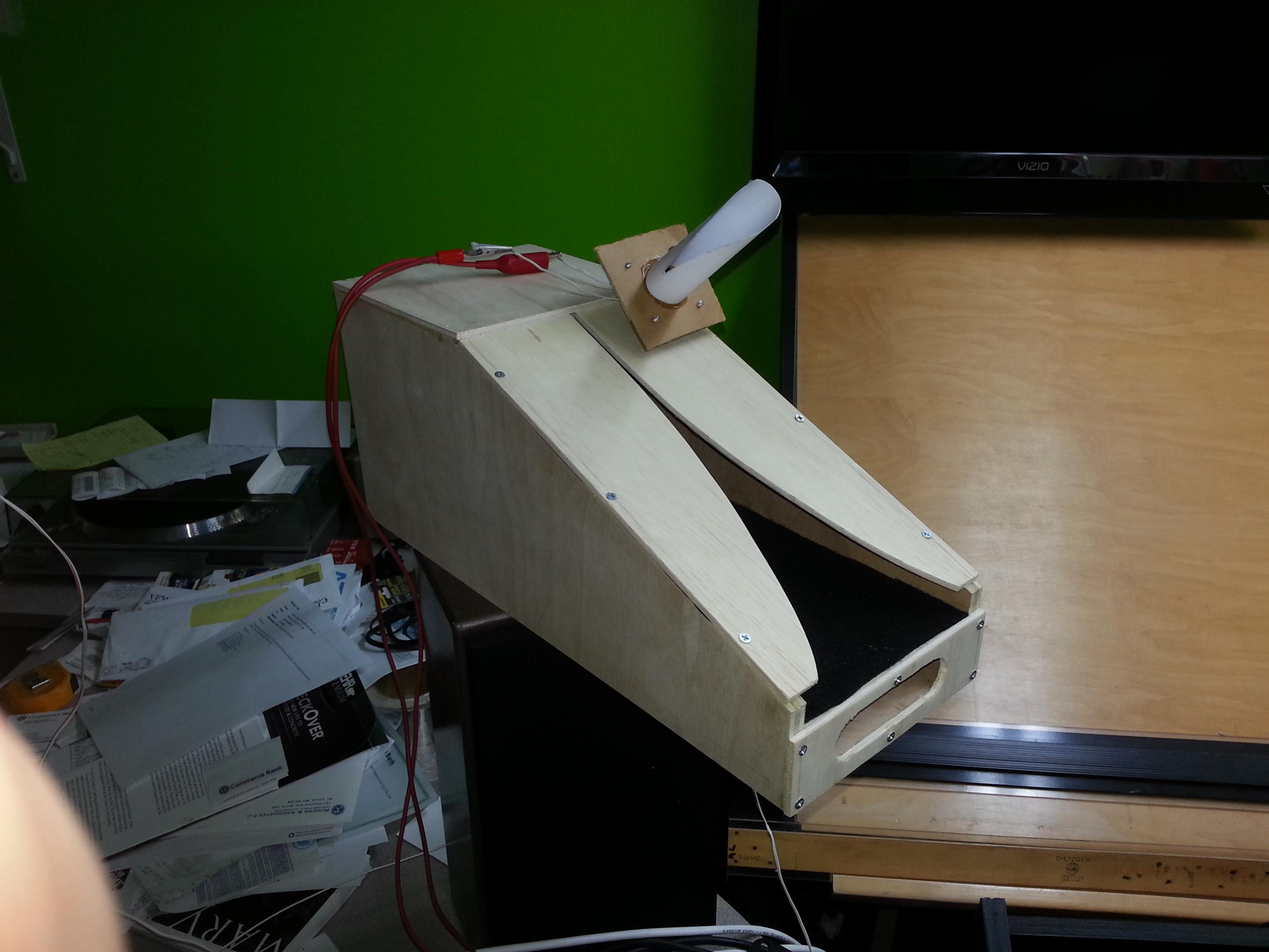

here's mine in paper
Does photo show orientation?
That is one of the arrangements I tried and I quite like how well it projects the sound stage to match my Klams.
The photo shows the tube tilted up. Did you run it like this? I have my tubes centred at ear level they are parallel to the floor. The tubes are at the corners of an equilateral triangle that from the listening position you are looking straight down the barrel of the tube. the orientation of the slot is like you have them in your photo they are cross firing. This is it best configuration I have found so far.
