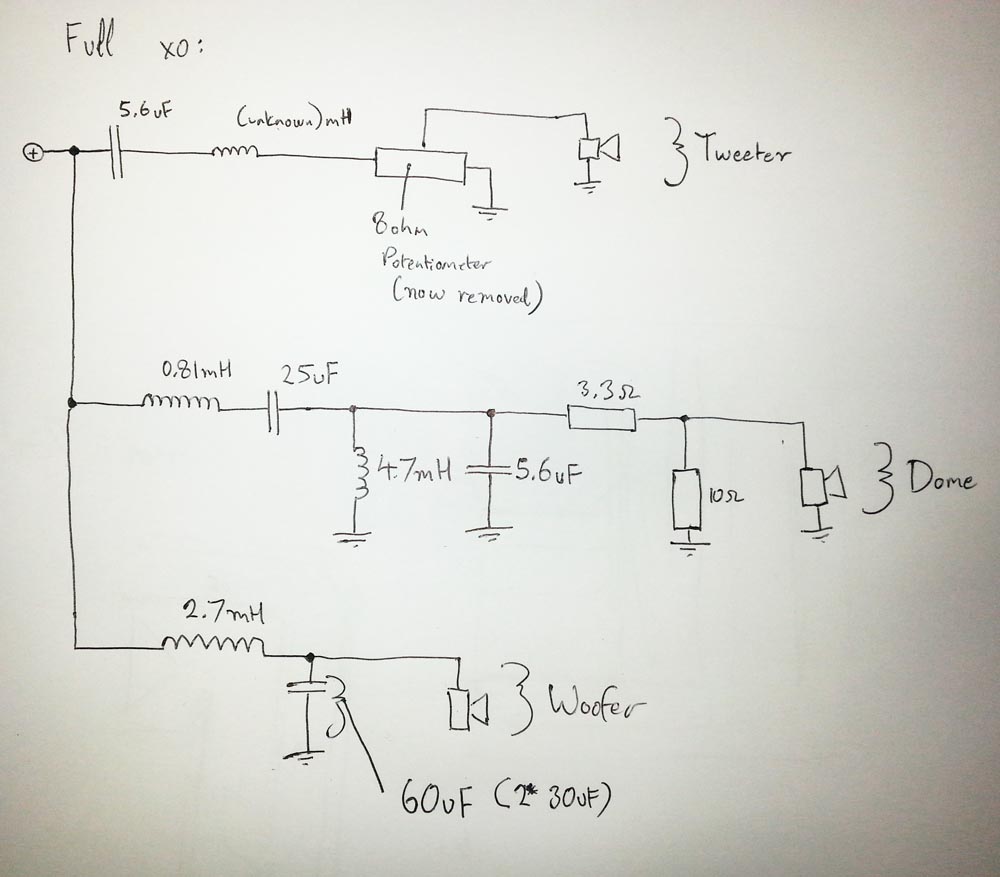

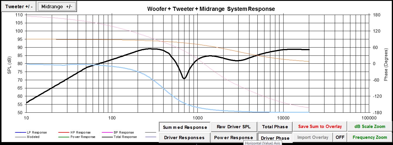

Ok, so crossover schematic is attached, I've also started modelling the xo with impedance curves and approximate driver responses, images of 'as is' attached...

When I take a look at your x-over it almost seems that you have a 4 ohm midrange ; please check !

Is the inductor in the tweeter path connected this way on both speakers ? Or just on one ? If wired different then that could be the reason for the difference in sound. I would also say that it needs to be in parallel to the tweeter in order to make it a 2nd order highpass. Maybe it even was wired that way originally and someone added the L-PAD later on and made a wiring error.
Regards
Charles

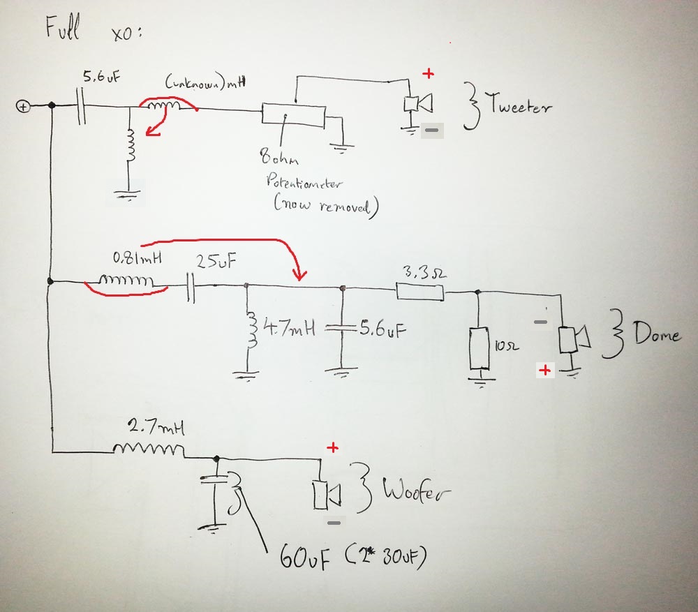

Looks like it was always wired that way, but yeah I think i need to try switching the inductor into parallel rather than just bypassing and re-check all the polarities.
If the passive crossover designer is accurate, then the more I refine the data input (impedance curves, inductor resistances) the more it appears that this crossover should be fine.

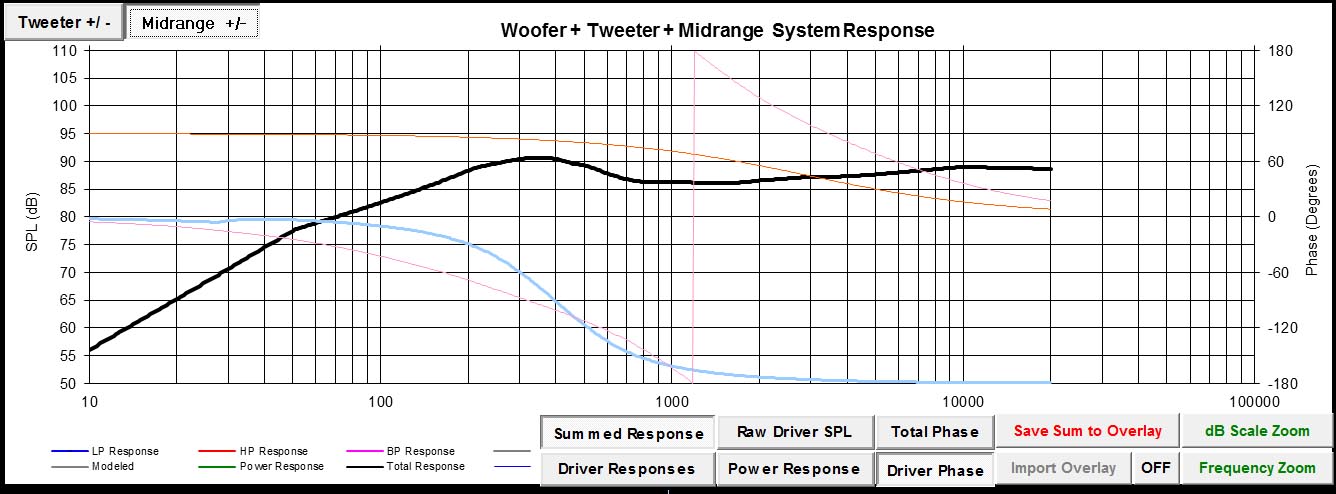

I've fixxed the XO to what I think we'd all agree it should be, and the difference in sound quality was night and day - these already have clear benefits over any of my other speakers, mostly they sound a lot more full and open. the only questions left are how much to pad the mid/tweeter and if I need to worry about impedance leveling.
Because of the values in the x-over.
Just checked a simular VIFA design; L & C on the woofer are mostly larger then C&L on the midrange .
Your values point to 8 ohm woof and a 4 ohm mid.
I designed a lot of x-over for Vifa speakers and it just seemed a bit strange.
Can you measure the dc Resistance of the midrange ; just to be sure.
If I'm correct you will have a bad job integrating the woof and the mid.
Leon
Do you mean the series resistance for the tweeter should always be located so that the capacitor is between the tweeter and the resistor?
the 10 ohm resistor was part of an L-Pad for the mid, not the tweeter, as originally the L-Pad was created for the tweeter with the potentiometer.
I removed the 10-ohm resistor as it measured 3 ohms on my multimeter...
usually I would also place the midrange series inductor differently
but I don't know if it makes much difference
you could also try a small experiment ... removing one of 30uf cap on woofer
Yeah, I don't know if that makes a difference either but it certainly makes a lot of sense, i get the feeling I'll be de-soldering and re-building the crossover and will re-arrange as you suggest, was easy to switch the tweeter inductor to where it should have been.
Tried to bypass the bass caps but can't do it until I de-solder the thing, but based on the passive XO calculator model I don't think I'd want to
.. as said in post 28, the more I model these crossovers and improve the accuracy of the model, the more it appears that the original designer knew what they were doing. The adjusted values from those recommended probably reflect what was needed to achieve a reasonable phase/frequency response between the mid and woofer.

Or is it possible that the L for mid and the L for woof are switched ?
Something is not right (for my intuition) !
it is using a mid dome that will need higher xo point than most other cone mids
so the woofer will also be crossed high, ofcourse
besides, the smaller value inductor looks much bigger
which tells that it might be wound with thicker wire, for woofer use

... but based on the passive XO calculator model I don't think I'd want to
a calculator is not much good
but you may use it as a 'pointer', or guide
remember to use different impedance values
accordingly to the actual driver impedance at xo point
and you will have to fiddle quite a bit more than that, on the real speaker
just don't rely on it to be real at all
a lot of things changes on the real speaker
btw, I use resistors in series with all parallel components
(I simply can't make a crossover without them)
impedance changes have influence on crossover function
that is one of the basic keys to all understanding of crossovers and speaker design, and more
try study how component values changes with different impedances
