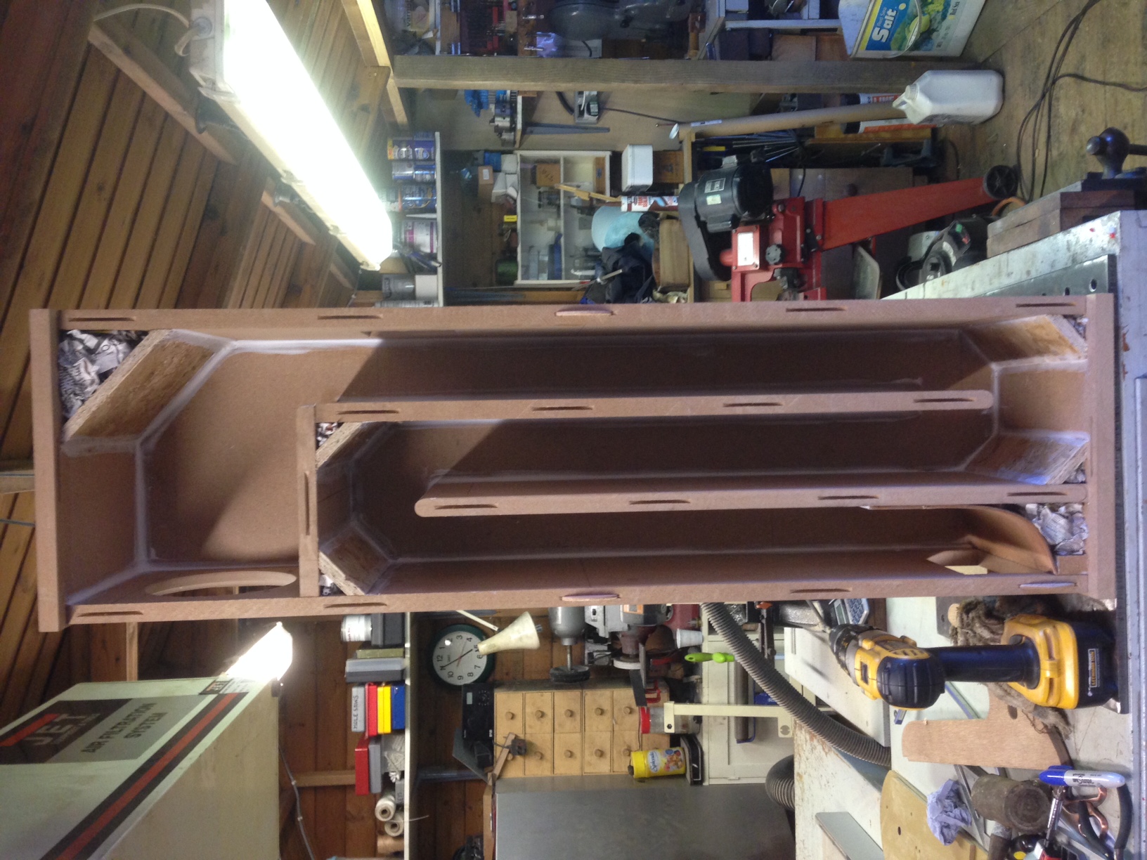

However much you may "expect" me to do, the folded TL design that seaco built is simply too flawed IMO to be able to recommend any driver having any chance of working satisfactorily. If seaco chooses a driver I can do some exploratory modeling pretty quickly, but there is little likelihood they'd work in his already started cabinet. There's nothing wrong with trying to do the very best one can even though the outcome will never be perfect.

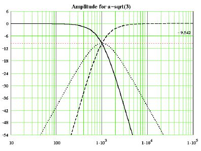

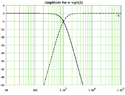

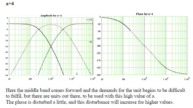

@ GM. I know diyaudio.com is famous for being stingey with praise, but to have never heard of Steen Duelund is shameful.
This man discovered an optimal approach to even-order filters just by algebra. He suggested a spectrum approach to filters, where 2 way blends into 3 way with a mid at varying level with perfect phase alignment. It doesn't address the power loss issues of even order filters, but he was listening on-axis, and it's just how nature works.
http://www.diy-audio.narod.ru/litr/duelund-filter.pdf

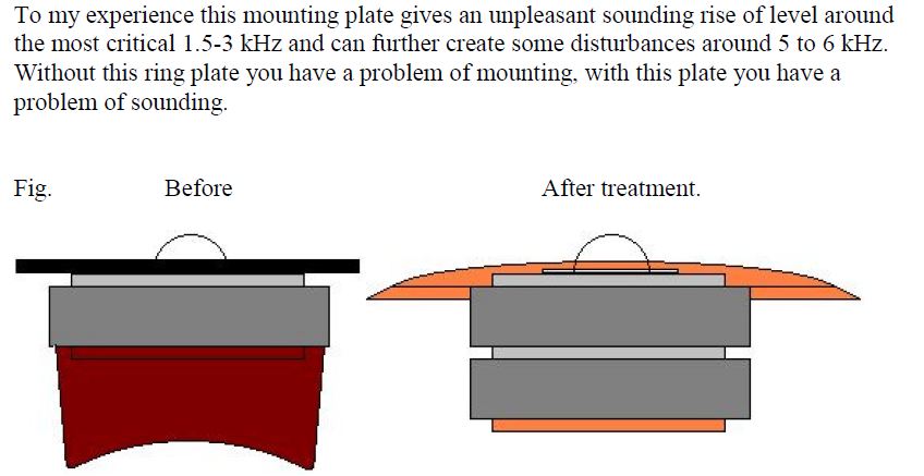

His closed box constructions anticipated B&W's Matrix approach. His diffraction ideas include the room, the box and the front baffle. He thought about the mass taper on a cone, and the front plate on a tweeter.
For all that, his broken English is hard to read, and he perhaps missed a trick with some BW3 and series filter designs. But always stimulating to read. :)

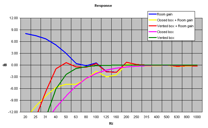

I think it is what it is. Includes every variation on cabinet size and geometry and placement and room reflection you might try.
Did I mention that Steen Duelund was a flat impedance fan too. :cool:
But we ought to include room gain too, to be exact.

If I thought is was possible to design a "one size fits all TL" I'd do it and in an instant. I think the best one could hope for is a TL that might work reasonably well across the board with it designed for a fairly narrow range of Fs and Qts values, at least as far as ending up with about the same response shape. Vas and, therefore, the line's volume would ultimately determine the bass response, like F3, however.

Truthfully, Seaco, you listened to the wrong people. :eek:
Your design was not bad at all, IMO. Particularly disappointing after you put in so much good hard work on the cabinets.
You lost confidence. It might have been good, it might have been terrible. Hey what did you have to lose?
My own opinion is that you needed a better crossover, possibly better drivers, not cabinet.
