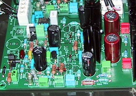

Cobra2 said:
And it also sounds great ! Now, I need to find a home for it (chassi).
A little gain-adjustment 100ohm -> 75ohm was what I needed.
All components are matched, even had to order another 10 of the RIAA caps for getting a match...
Didn't you use 2.5% caps? Is it polyester....green? :magnify:
Now the picture looks better but how about the class A circuit? FET + resistor only.

6800pF + 2,5% = 6970...
And when I do critical matching, I try to go for +/- 0,1%. :cool:
Witch "wastes" a lot of components....:bawling:
Having looked over the schematics & instructions, I think I have removed the surplus components, exept a few, that should be isolated from the circuit anyway (without transistors).
