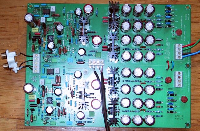

Now the picture looks better but how about the class A circuit? FET + resistor only.
Didn't you use 2.5% caps? Is it polyester....green?Cobra2 said:And it also sounds great ! Now, I need to find a home for it (chassi).
A little gain-adjustment 100ohm -> 75ohm was what I needed.
All components are matched, even had to order another 10 of the RIAA caps for getting a match...
Chris said:This design is a two stage riaa phono preamplifier.

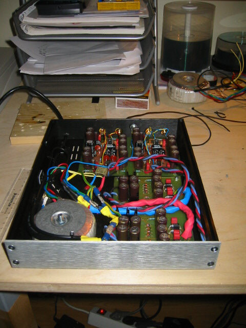

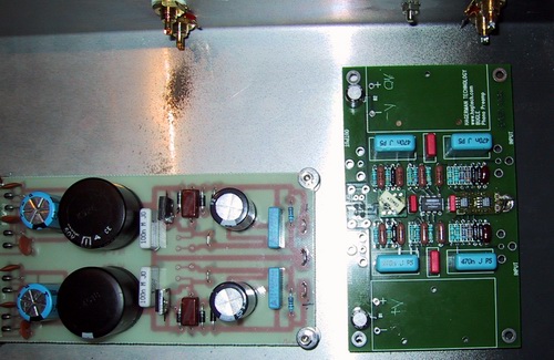

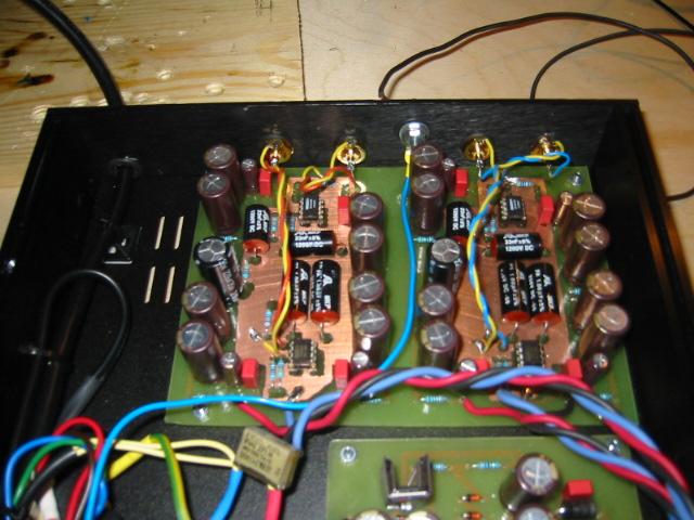

Currently I use BB opa 37 in the first gainstge an BB opa 606 in the second gainstage. The result is shown in the following pictures.
Very nice work Chris! Could you perhaps elaborate a bit on how you made the case? Especially, how did you get that nice finish on the front plate?
Re: QSXM3
6800pF + 2,5% = 6970...
And when I do critical matching, I try to go for +/- 0,1%.
Witch "wastes" a lot of components....
Having looked over the schematics & instructions, I think I have removed the surplus components, exept a few, that should be isolated from the circuit anyway (without transistors).

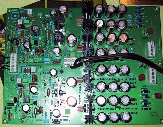

Re: Re: QSXM3
Some parts are still there which shouldn't but they seems to float, no harm in that.
Can you measure down to 0.1%? I have a LCR-bridge at work which takes 0.25% (12500 SEK = 1500 USD).Cobra2 said:6800pF + 2,5% = 6970...
0,1 %
or not...
I use this : http://www.peakelec.co.uk/
and I have a few referances.
And measuring thru a lot (time-consuming), I sort them, and compare against a referance.
And (after calibration) I expect the instrument to be close on mentioned value, when it is spot on at 1nF(referance).
Arne K
