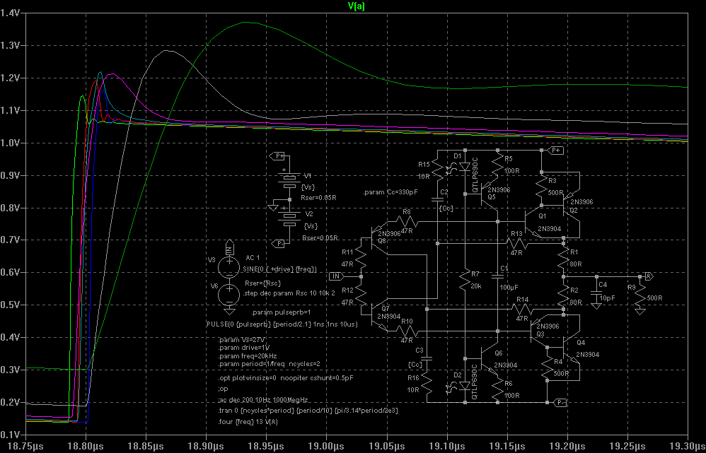

@Rüdiger:
The loop-gain probing is a bit difficult in this setup, so I tried the normal approach looking at the step response. I ended up with degenerating the feedback for high frequencies, by dividing down the AC at the collectors. This comes at the cost of lesser cascoding voltage.
See attached test. It can be seen it is quite stable (though not pefectly damped) with any source R from 10R to 10k, but with higher source impedance more DC-offset is introduced, also distortion "goes up" from 0.6ppm to 0.11ppm ;-)

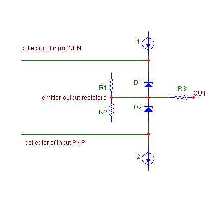

Well, I guess, there's no quick shot possible.
Since we have to break the short link between the input collectors and the emitter nodes of the compound pair, we fall somewhat back with the 50k/50k divider (0.000020%), with 99.99k/10 we settle at [Edit] 0.0002%.
Step response won't be perfect still, but better.
For comparison: while the curl follower (CCS'ed jfet follower out of a single 2SK389) sims at 0.0054% at 1V (10k load), it sims with 0.000015% at this attenuator setting, this time with 500R load. (0.000001% with 10k)
So, I will try the other suggestions as well and see where it gets me.

When I look a little closer at the circuit, I find that then one looses the additional current sinking through the input trannies; that is, there is no option for a current polarity change in the output emitter R's. With the original hookup, the additional +-10mA from the CCS's are available to maintain class A.PMA said:I do not think that 0.0000X% or 0.0000Y% really matters. I am quite sure that stability is an ultimate requirement. For this reason, I tight collectors of an input complementary pair to supply rails, though distortion is a bit higher then, due to Early effect.
Of course stability is a big concern... in this case also ferrite bead in the inputs might be worth a try...

Rüdi, I meant #2. #1 is stable in my sim with any R_src, even with no output load and high supply impedance. Must be the different trannies... I might try the BCxxx models from the Philips library (Orcad, phil_bjt.lib) to see what happens. What were the models you used, and can you post them?

Rüdiger,
I've tried it with your models, but no change:
- circuit #1 is stable**)
- circuit #2 is unstable below ~500Ohms
- compensated #2 is stable**)
**) but with decreasing margin at lower source impedances, step response (also of the internal currents) looks very well down to ~1k, no significant overshoot.
I didn't sim the supply details, maybe the problem comes from that?...
