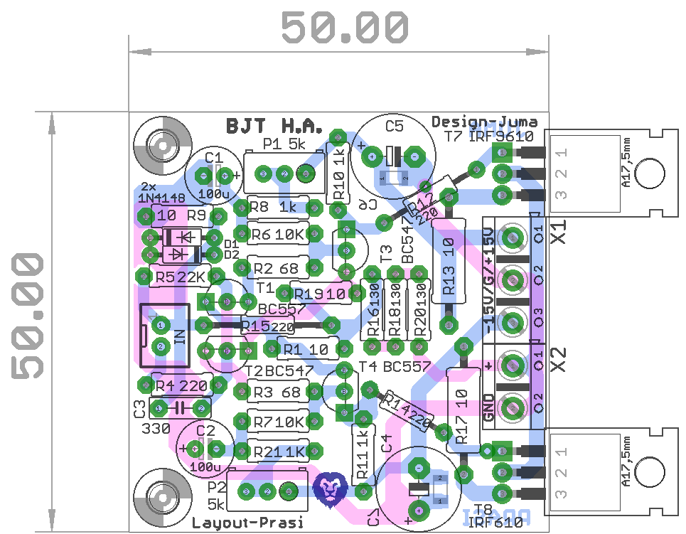

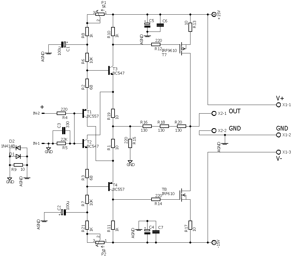

mouser was fast, the 68ohm resistors are soldered for r2/r3 and now everything is perfect. have a bias around 100ma and the offset is stable floating +- 0.4mv after 2h. i didn't need to change r10/r21 to get the bias down to 0v. amp gets warm but verry moderat due the big heatsink. now i have to wait for the 10k poti to arrive.
would like to thanks prasi and xrk971 for your help. sorry for my laziness didn't match the mosfet, often the adjustment range is big enough for a 2 mosfet design, learned something new. sorry prasi that you get troubled asking questions for me.
nedd to punish myselft for that:
i should not mount unmatched mosfet. i should not mount unmatched mosfet. i should not mount unmatched mosfet.
Don't be too hard on yourself. A two MOSFET in push pull should not require matching to achieve zero volts DC offset. The design should have enough adjustment range built in. Many N and P channels don't even have the same range of Vgs so can't match. Like IRFP240/9240. One is in 3v range and other is closer to 4v. Just differences in N and P channel.

for the nazar psu with the prasi pcb take care of the wrong marked diode (d10) all 4 diodes point in the same direction (d9-d12). i would take 68ohm resistors for r2,r3. i could archive a adjustment range up to 120ma bias (or 1.2v over r13), very stable offset. the adjustment range is narrow, would be nice to be more flexible and get high as 250ma.

i do not know if you have read this in the bom, but when using 1u coupling cap (C8), then R5 need to be 100k.
reg
Prasi
i seen hat in the bom, it's a 100k in, i used two coupling caps.

Here is my build of the HA.
Del V across R13 and R13’ is 1740mV and on one ch and 1730mV on other after 2 hours. So hefty bias.
I mounted the IRFP on separately thro wires and that’s why all the wiring.
Heat sink is a bit small for this dissipation and gets hot.
Offset jumps around a bit from -3mV to +6 to 7 mV.
