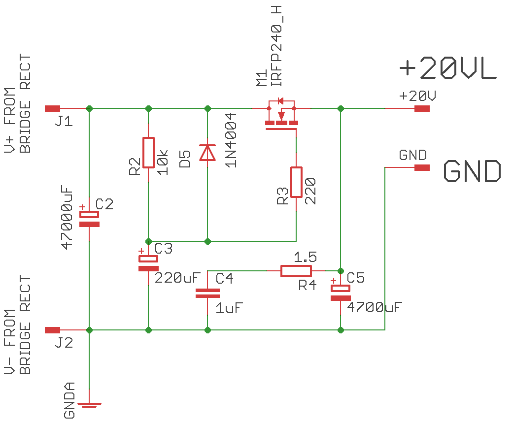

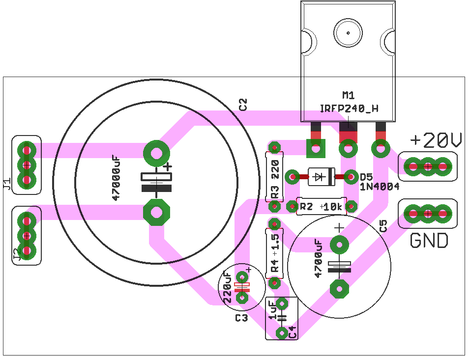

Hi!

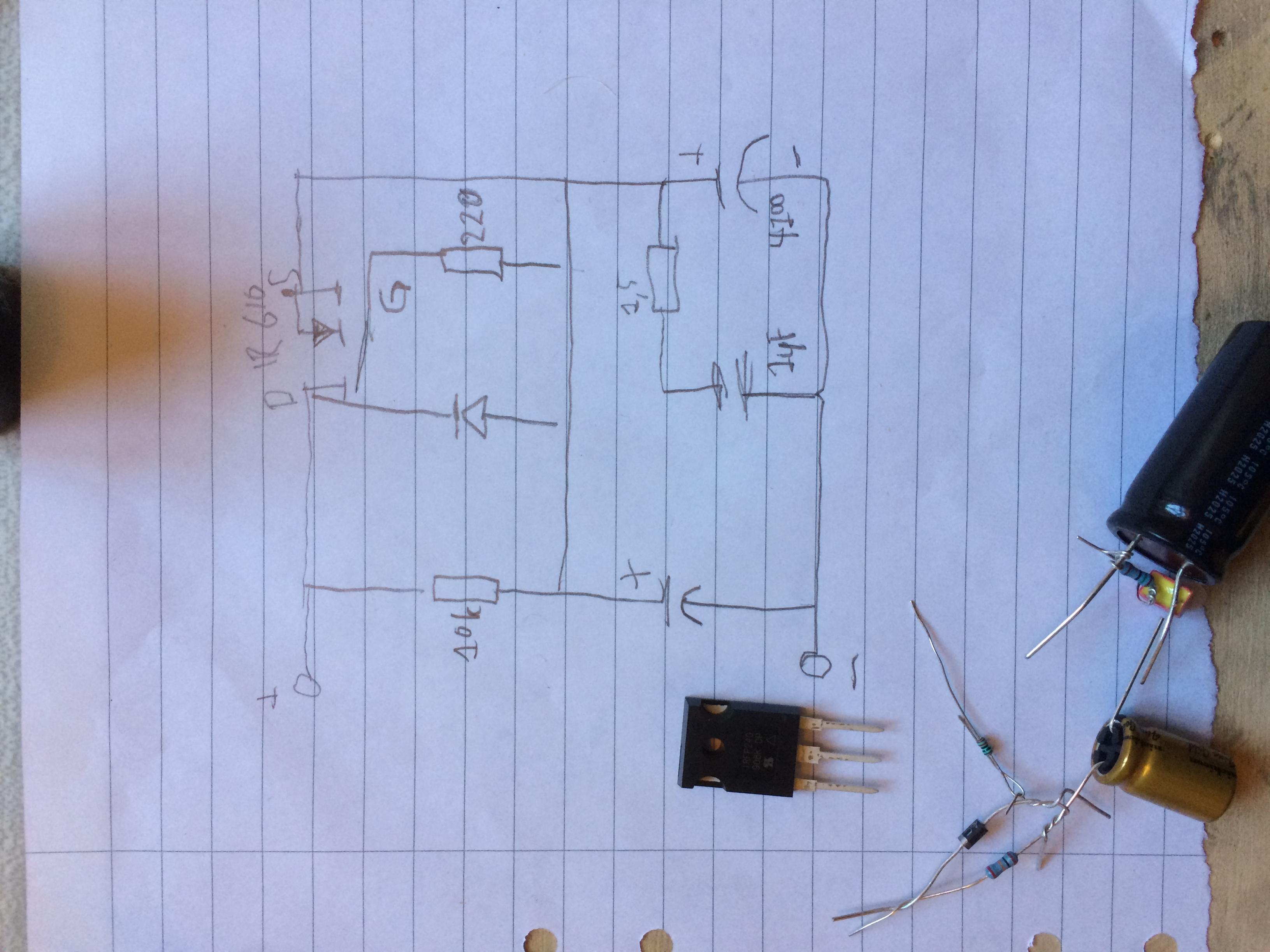

I'm trying to assemble the single rail version shown in the first post for an amp and just want to make sure I've got everything right.
Where on the mosfet do I connect the 220r and where do I connect ground/v- to the amp?

Always generous:)
I had the sch ready, it just took 5 mins and I wanted to help out a new person.

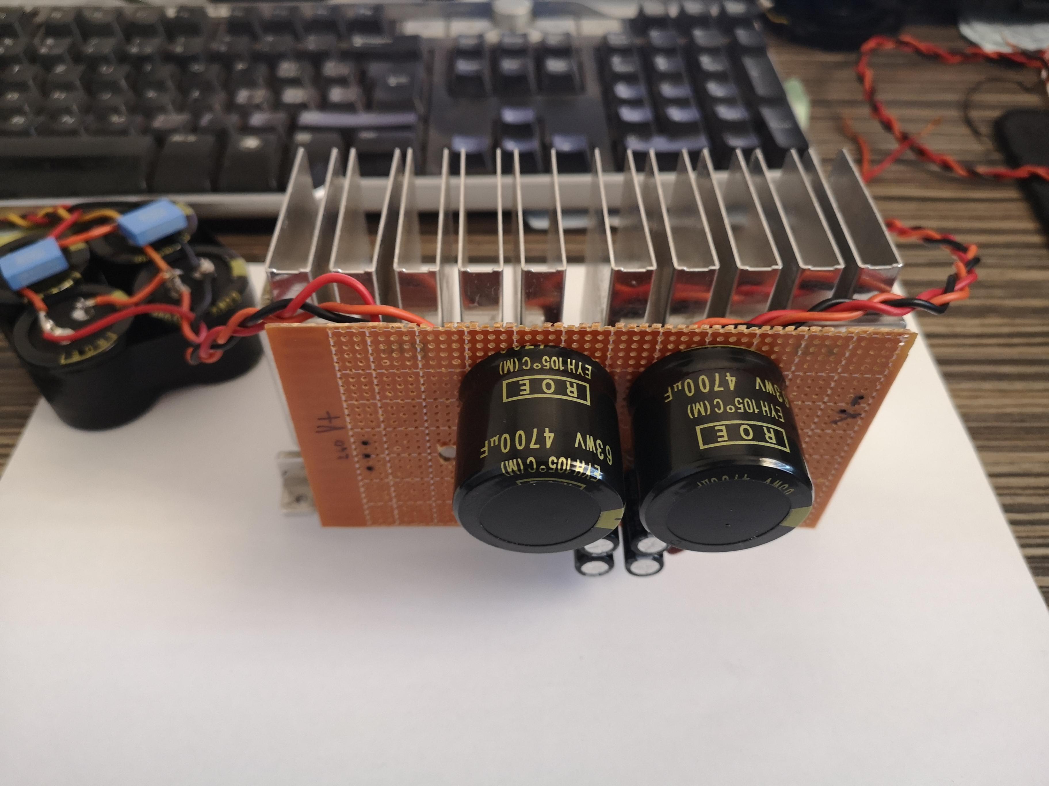

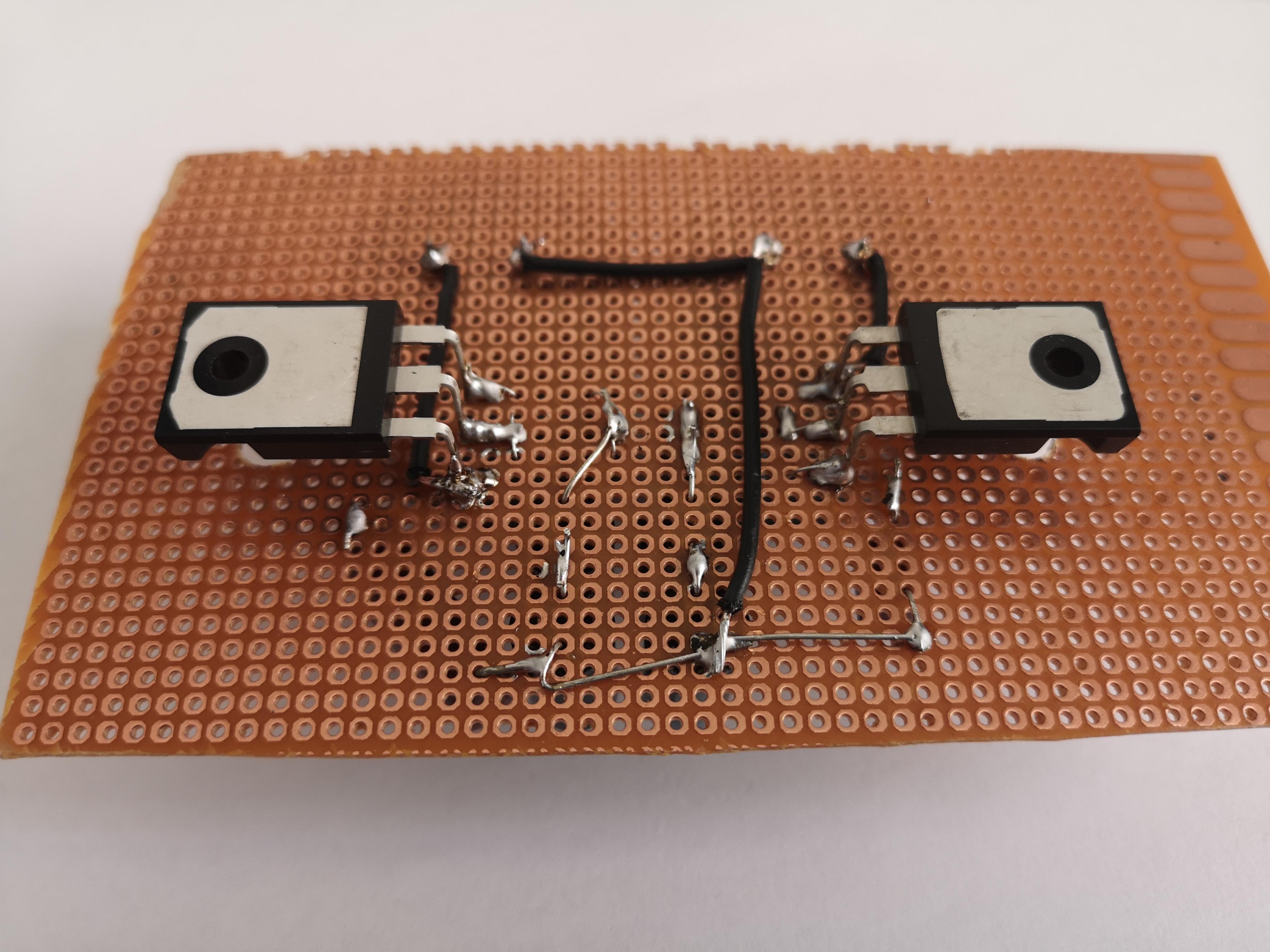

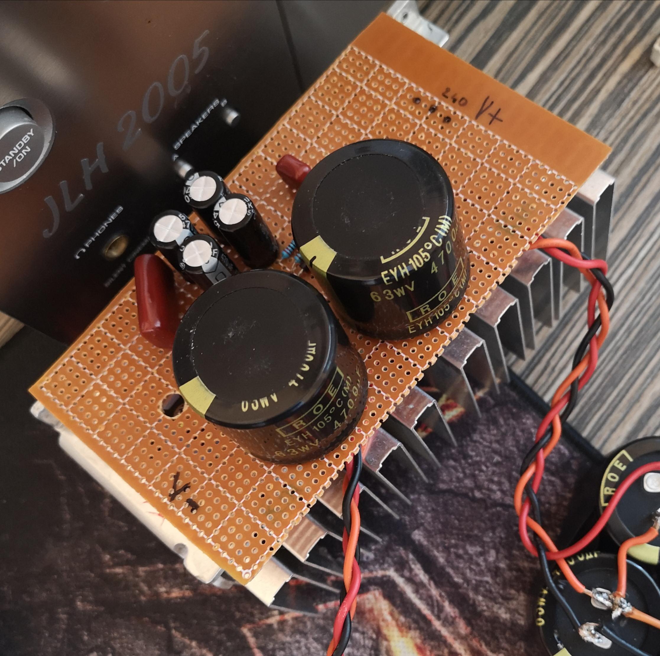

Juma's capacitance for A class testing, made it last night on the board for easier handling. I have been using it for a few years in p2p form.

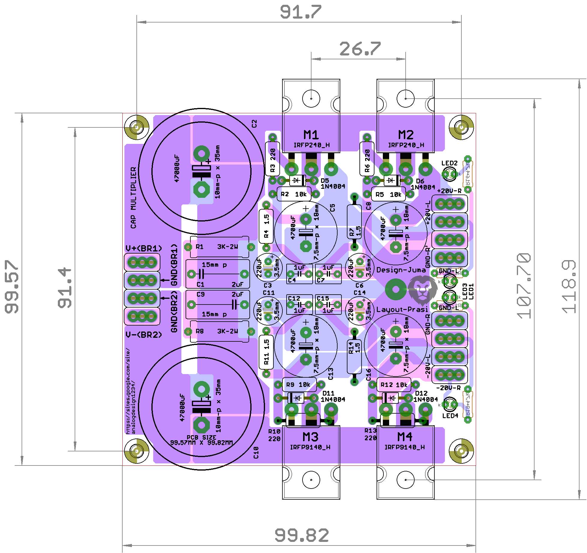

I don't know whether I fried anything.?!
Wired up the positive side alone and all good.
Was a bit confused how to wire the negative side and I thought I'd beeped it out correctly so I tried the neg side with BR - to GND(BR2) and connected my BR + to V- (BR2).
No magic smoke or anything but no leds .
Did I wire correctly? Could I have killed something if incorrect.?!
Leds on neg rail appear correct orientation
Edit......damn! With reference to a photo on post #355 I got it wrong. Will I have blown the transistors? The first big smoothing cap on that rail measures ok. It blew the mains fuse and also blew it again when I correctly orientated the BR wiring. So something is damaged!
