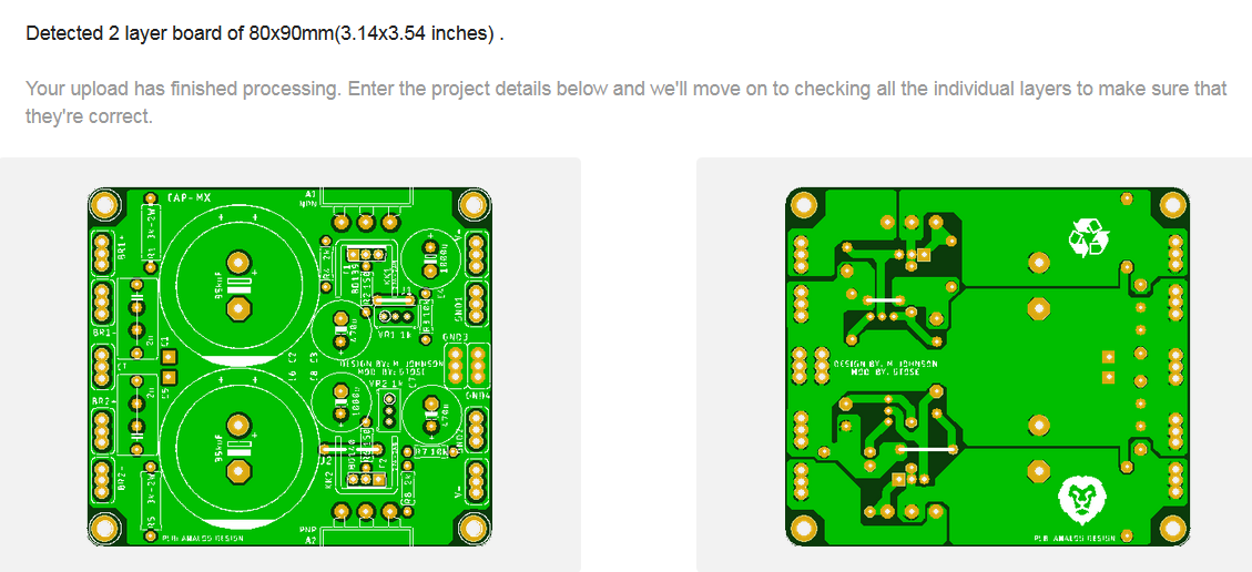

I just loaded the Gerber files in the KiCad gerber viewer and it does appear that the board is smaller than what JLCPCB is detecting. The output transistors along with two drill holes appear as part of the PCB area and then the PCB outline.
Any chance that the originator can upload a fixed version with the correct PCB outline in the edge cuts?
Edit: I have attached an image of the errors in the outline layer where you can see the outline extending beyond the PCB dimensions.
Hi Kozard,
here is modded gerber zip file that doesnt have drill for output which might be causing wrong outline with jlcpcb.
hopefully it will work now.
regards
prasi
  • CAP-MX-GTOSE-MJOHNSON_R1_2021-03-02-drill.zip
Yes, that works. Thank you!
JLCPCB detects the size/outline correctly now. (Image attached.)

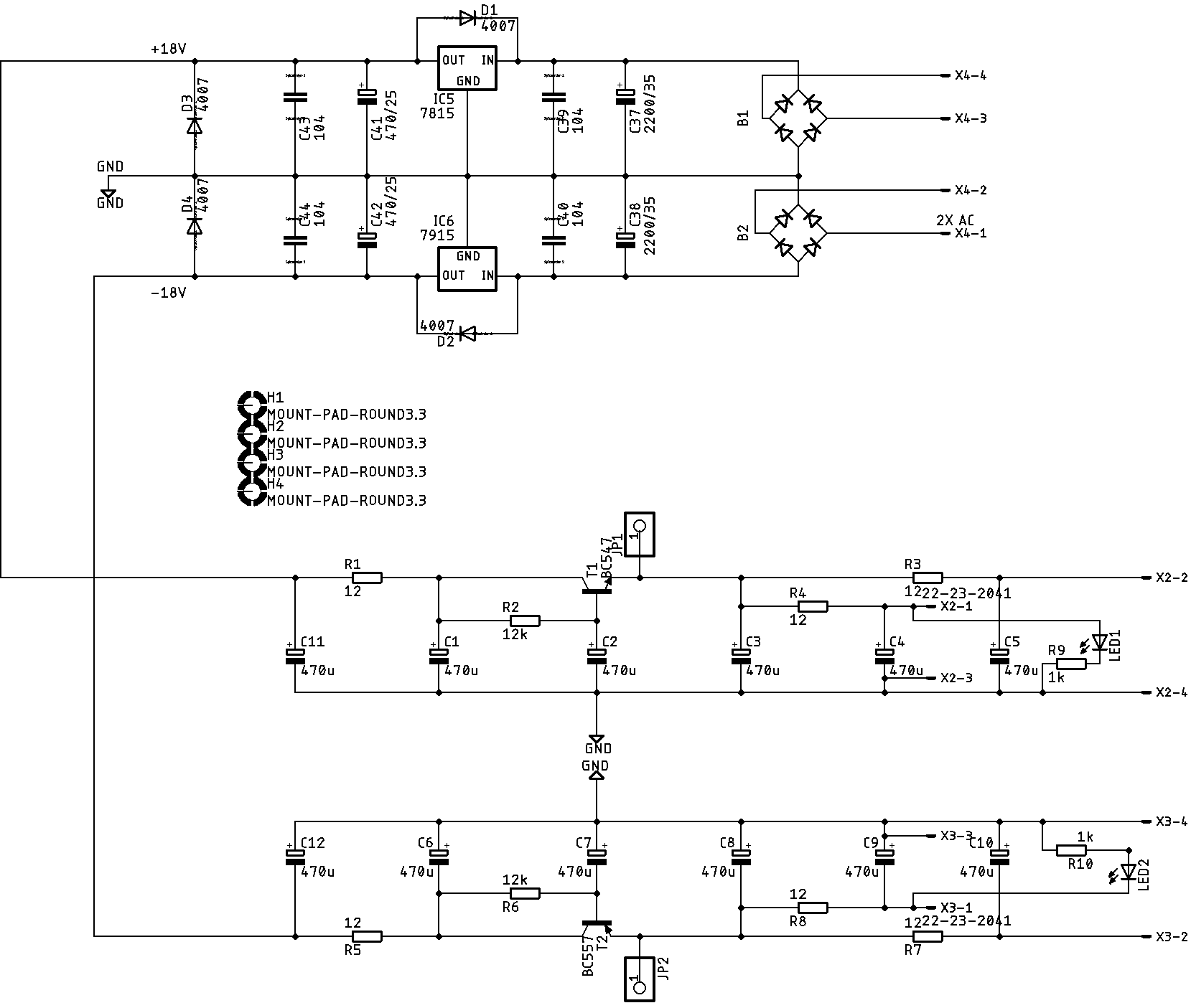

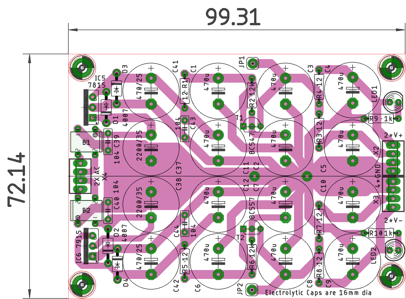

  • GERBERS-cmx juma-preamp-rev2-with regu_2021-03-28.zip
Reactions: 1 user
Hi, one question:
For this pcb/schematic, if i put all 4 mosfet identical, like irf840 or similar, can i have 4 multiplier for positive voltage?
I have to disconnect/separate the gnd connection?
https://ibb.co/yFQ6hhG
Thanks guys
It will not work as diode orientation is different. best not to try it.
rather you can cut pcb in half and use.
