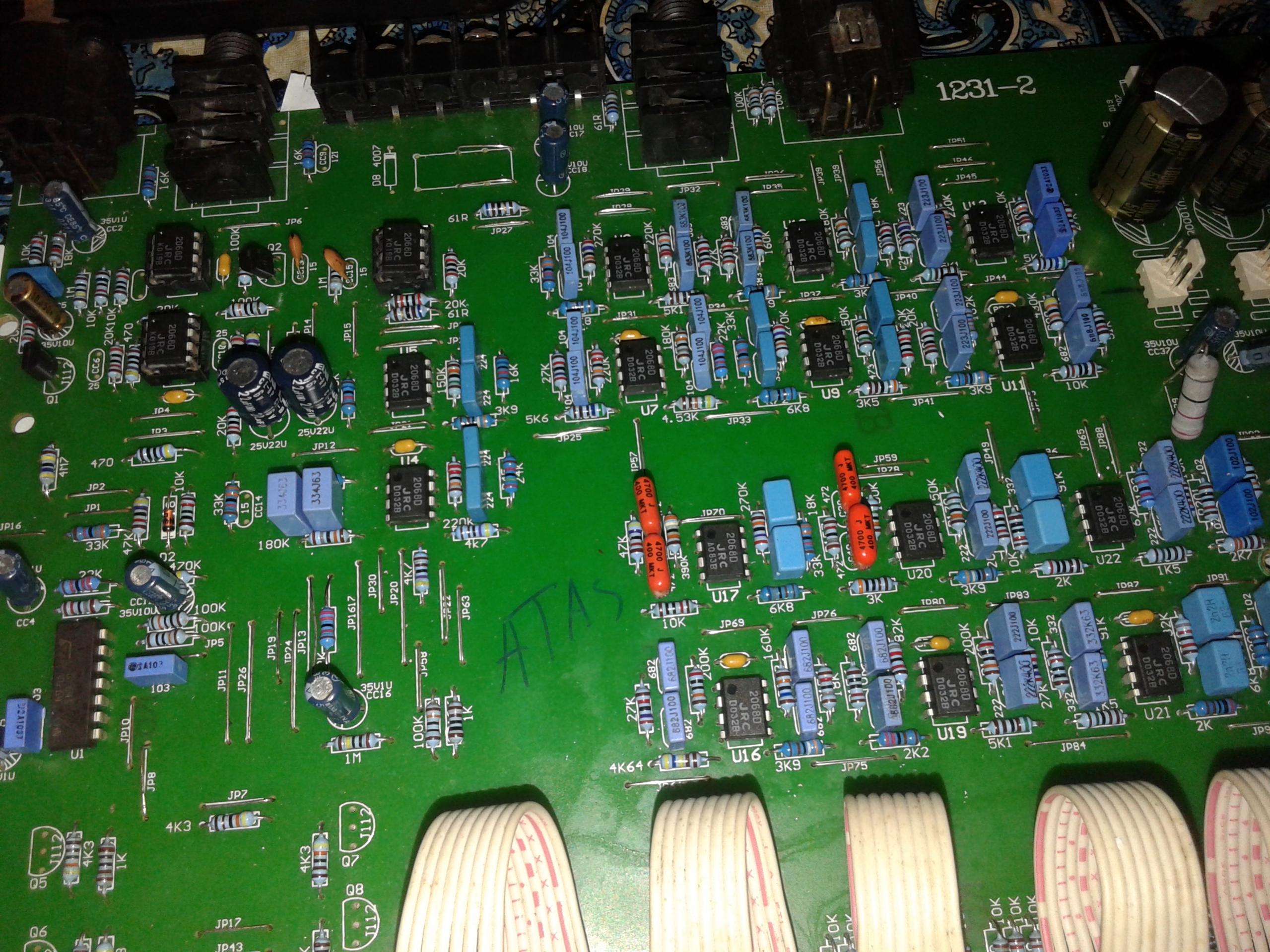

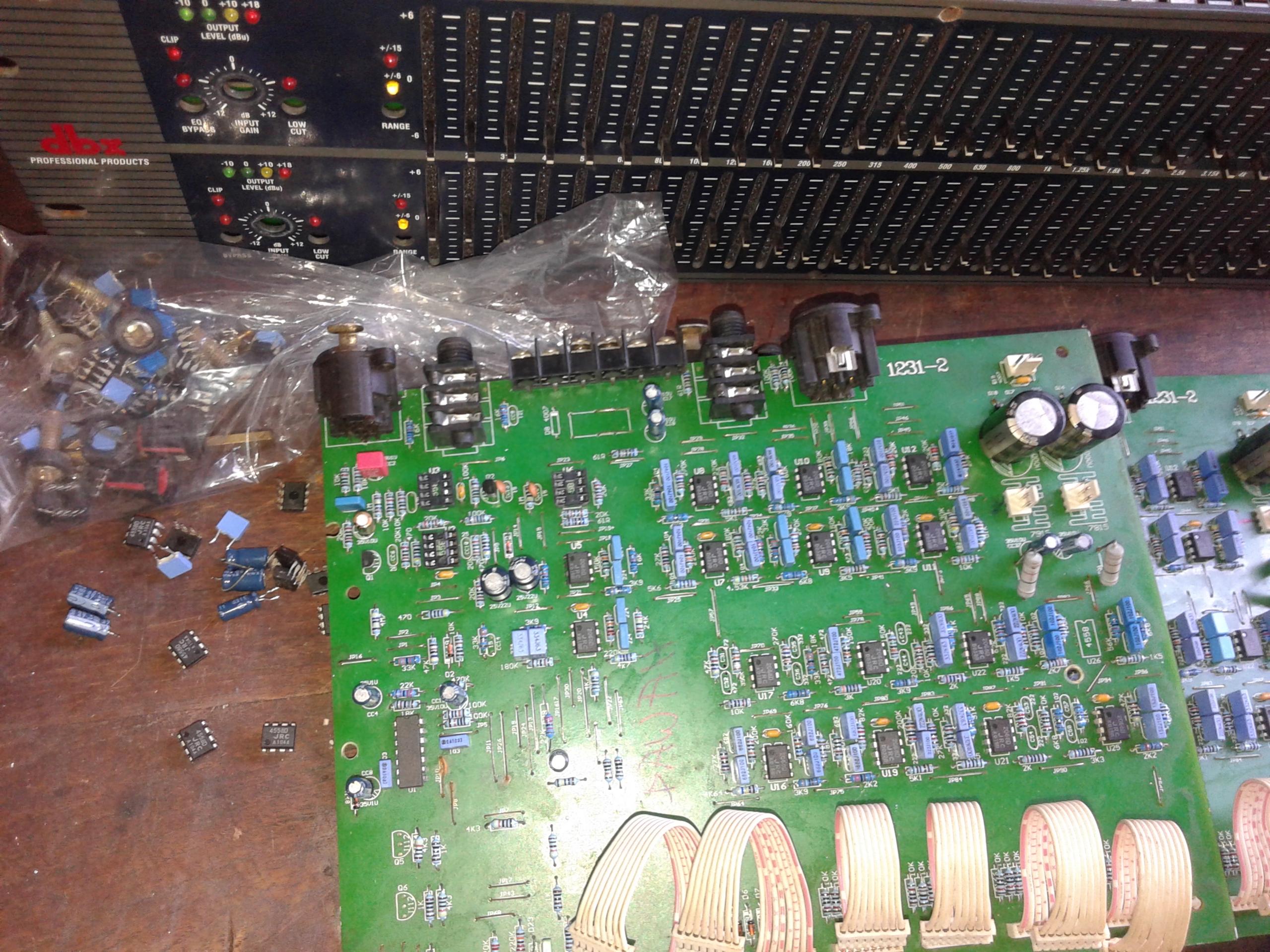

cheap and low cost ... usually found in many china made car preamps and car amplifiers ... i have mine replaced them with either TL072's or NE5532's
That looks like a good plan to replace a fake part that didn't work with one of specs that meet the design goals.cheap and low cost ... usually found in many china made car preamps and car amplifiers ... i have mine replaced them with either TL072's or NE5532's
It is likely that there are 4558 variants available that just can't meet design goals. it is in that case when replacement is advisable.
It will take greater board space to defeat wishful thinking; and, when greater board space isn't the thing to do, then just install a stouter part. That plan works just fine.
There is a catch here however ... i had 2 same car preamplifiers with 4558 inside ... one of them replaced with TL072 and another one with NE5532 ... despite the improved sound quality with either TL072 / NE5532 ... the preamp that has TL072 made some noise during turnoff ... the one with NE5532 didnt make any turn off noise at all ... so some caution is advised when considering opamp replacement with different models ... i still dont know why the TL072 made the noises
The '072 is notoriusly and badly behaved when power is removed. I guess it is the same mechanism as the phase reversal when a 072 is used as a voltage follower and the input goes high, close to the power voltage.
