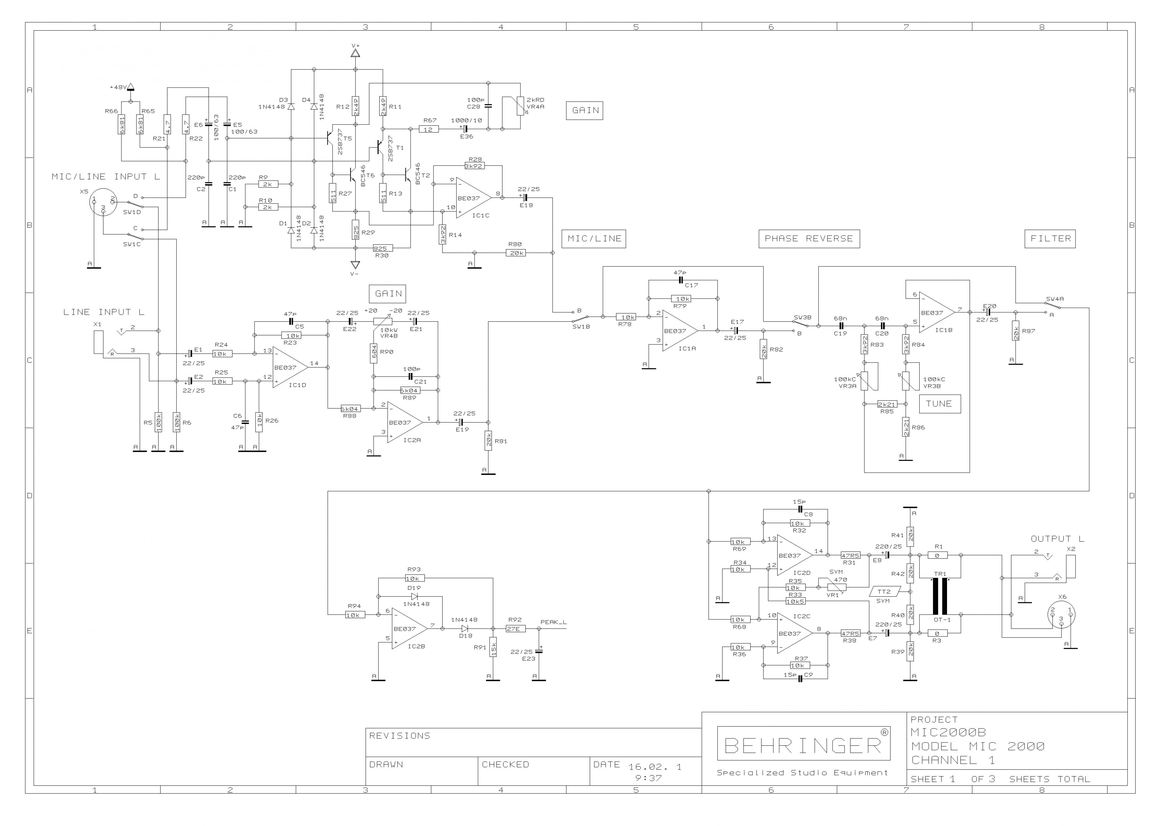

You mention MC33079...I currently use a Behringer Mic2000 1RU mic/line preamp with gain, variable low cut filter and polarity switching.
The original quad opamps are NLA ''BE037/LM348 (USE 0ICS-002)''......''0ICS-002 IC BA14741 DIP'' .
I have a handfull of MC33079 in the mail also..these will go into the Mic2000.
LM837 is another possibility.
I also have a pair of Behringer OT-1 balanced line driver transformers.
