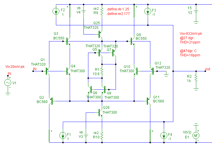

Okay, back to Natan Carter and his low distortion input circuit.
In post #19567 we saw a DIY version of this circuit based on two groups of 4 matched trannies (THAT300 and THAT320). The problem with this circuit is that the performance depends not only on the correct value of R1, but also on temperature and tail current.
If, for example, Tamb rises from 27 to 47 dgr.C, THD increases from 20ppm to 182ppm.
Apart from temperature compensation techniques, does this mean the circuit is useless?
Not really, as a more conventional input stage with comparable gm and current consumption (see below) still produces much more distortion: ~880ppm.
You should be able to re-optimise at 47C and give some variable a simple TC to get a first order compensation. PTAT currents are easy to make (a 1.25V reference impressed on a degenerated transistor is very close).
This would couple BTW to that differential VAS with no further major distortions, a PIM free op-amp.:)
Hi Scott,
That was precisely what I did a couple of hours ago. :)
and it did work with a ......1.25V reference. :D
edit: see pic below

Edmond,
I don't see how that circuit can work. I agree with Bear, I just see the output connected to two current sources between the rails. Or are the current sources a function of the strange looking rectangular bar with a + next to the top of it. This is beyond what I'm familiar with, could you explain the current sources?
Johnloudb said:
Edmond,
Exactly. It is such a virtual ideal CCCS made for simplicity of virtual reality simulations. It is very different from my SVCS that works in the physical reality, though is called similarly.
Humor me some more please - what real world implementation is a CCCS with a "- 1" (inverting?) that runs off the same rail as a "+1"? Am I to presume it reduces current with drive? :scratch2:
Or? Perhaps it takes a negative going input and makes it positive or vice-versa?
Don't think I've run across these CCCS thingies so far - a new one on me!
And, ok, I'm behind the curve - I admit it - is this whole circuit all current gain until the 1k output resistor? :dunno:

Bear:
If you lived in the world of spice sims these would be familiar (the symbols are always different-so much for standardization).
The current controlled current source is used here so that the impact of the rest of the circuit drops out. A cccs is a "perfect" amplifier, being just numbers. The real world implementation is (as they say) left to the reader.

bear said:
......I use LTSpice, but I guess that is somehow a "junior" version, and not the real thing? A little OT, but are there non-:$: versions with these sorts of things installed? Or do I have to go and find the "model" and grab it to put it in... oh so many questions!...........
No need for $$$
Your LT Spice can do that as well.
Just look out for a component (as NPN, NJF, ...etc. ) called "f"
F. Current Dependent Current Source
Symbol Name: F
Syntax: Fxxx n+ n- <Vnam> <gain>
This circuit element applies a current between nodes n+ and n-. The current applied is equal to the value of the gain times the current through the voltage source specified as <Vnam>.
It's just that we have to figure out which CCCS refers to which <Vnam> in Edmonds circuit.
