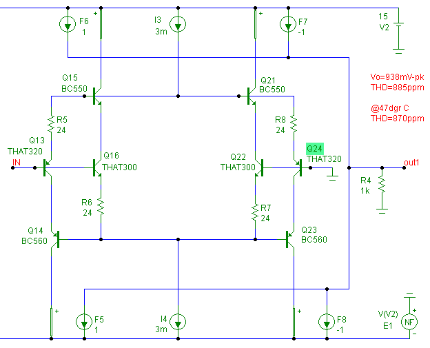

Okay, back to Natan Carter and his low distortion input circuit.
In post #19567 we saw a DIY version of this circuit based on two groups of 4 matched trannies (THAT300 and THAT320). The problem with this circuit is that the performance depends not only on the correct value of R1, but also on temperature and tail current.
If, for example, Tamb rises from 27 to 47 dgr.C, THD increases from 20ppm to 182ppm.
Apart from temperature compensation techniques, does this mean the circuit is useless?
Not really, as a more conventional input stage with comparable gm and current consumption (see below) still produces much more distortion: ~880ppm.
Re: multi tanh or beer?
Don't forget that things are going to be worse when you use real mirrors
