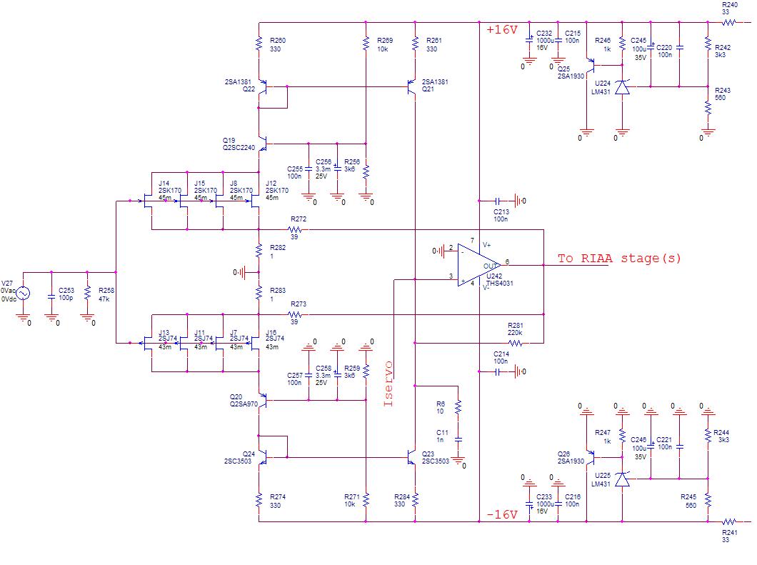

syn08 said:To summarize:
Gain: 60dB @1KHz
RIAA: +/-0.1dB
Noise: 0.25nV/rtHz
Max input: 1.8mVeff
Headroom: 40dB (0.5mVeff) 29dB (1.8mVeff)
Distortions: <0.01% (TBD)
I have experimented this version by cannibalizing a HPS3.0 PCB (simply not installing the RIAA correction in the input stage plus a few adjustments, including a SMD adapter instead of the AD797) and everything seems to be fine (input stage wise). I guess all the current concerns are now addressed. I'll wait for your input before running another PCB batch.
[/B]
Johnloudb said:Syn08, I was thinking ( a habit of mine ) and I was curious if you could parallel 2 of AD797 op amps to get more current
Actuallu you can parallell lownoise opamps, like AD797
to get even lower noise in an input..
syn08 has paralleled 4x 2SK170/SJ74 transistors in input.
The same is perfectly possible with op-amp inputs.
