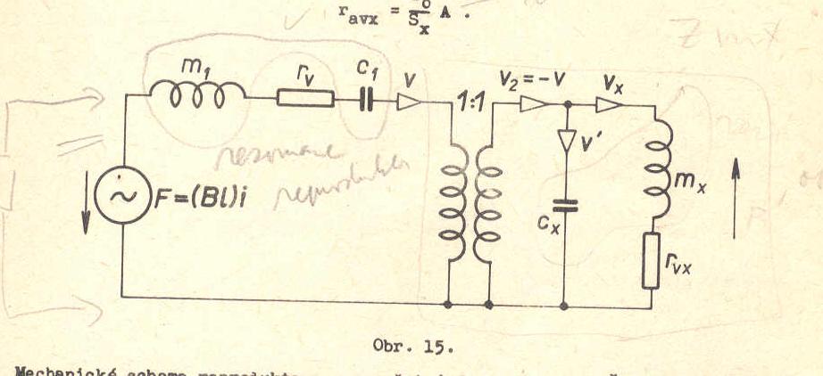

Popular misunderstanding of people out of the field. Electro-mechanical-acoustical elements are transformed to electrical side of the circuit as a parallel resonant circuit, that covers energy exchange.
How do you simulate such parallel resonant circuit that will conform with what actually goes on in real speakers?

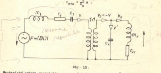

PMA said:Look Joshua, it is like this. But engineers graduated in electro-acoustics are not welcome in this thread. Electro-mechanical transformation. Mass to inductance, compliance to capacitance, friction to resistivity.
What speaker this circuit represents?
myhrrhleine said:The purpose of a speaker is to reproduce sound, not to 'play nice' with amplifiers
Sure! But torturing amps with 0.5 Ohm is unnecessary bad practice.
Electrodynamic speaker in a bass-reflex box (vented box). The values according actual speaker and box and vent.
Don't forget we speak mechanical right now.
It is really difficult to communicate this way.
Then, gyrator transfers to el. circuit like
http://sound.westhost.com/tsp.htm

PS: Any mechanical (resonant) system has an electrical analogue.
Pure delay, reflections, and other non-minimum phase behavior are harder to include. I'm with SY on the Klipsh
