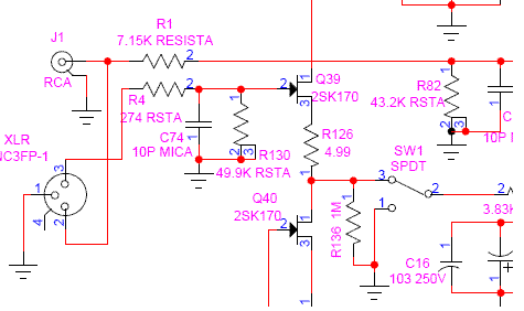

Back to JC's question. I saw this in Sony schematic. Diamond buffer closed in opamp's loop, like Walt Jung's line driver.

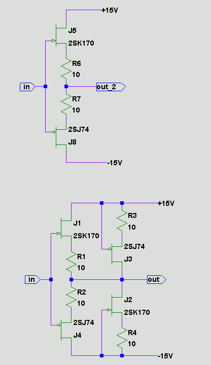

Edmond Stuart said:
As you see, I've adopted your jfet buffer idea, but made it complementary. Now THD is ten times lower.
Hmm, I've redrawn the "Edmond buffer", see attached picture, bottom.
To me it looks like our well known complementary buffer (above) with two current sources capable of adding more output juice?
Just by simulating, I don't see much advantage for the "Edmond Buffer" even at fairly low load resistors.
But it makes offset trimming easier, as there is no need to screw around with the source resistors.
Nice idea.
Tino
Nice idea.
Tino
Redrawn? 'Bad Science!'. You just spoiled it! That's why you don't see much advantage. Clearly, you don't understand my buffer (and your own crippled version).
Exactly, I was about to post the same thing. And if the N and P JFETs are identical (as they ideally should), the current sources do precisely nothing.
I agree, the servo is very nice.
Edit: I've just noticed Edmond's message above and I have to admit I'm even more confused now. I'm waiting for an explanation.
More edit: I got it, I confused the source resistors rs1 and rs2. Now it makes sense - my fault for not looking closer.
Even more edit: Yes but rs1=rs2 so again if the N and P are identical, the whole thing doesn't make sense.
