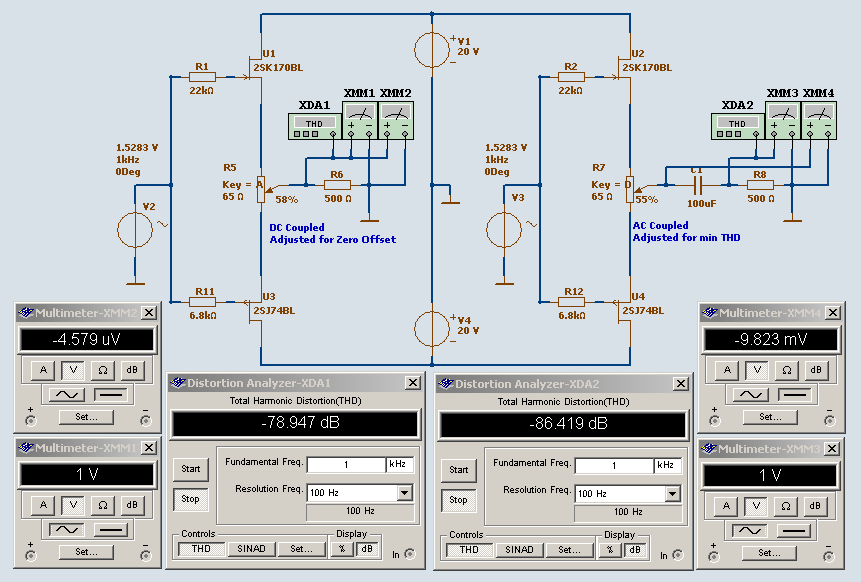

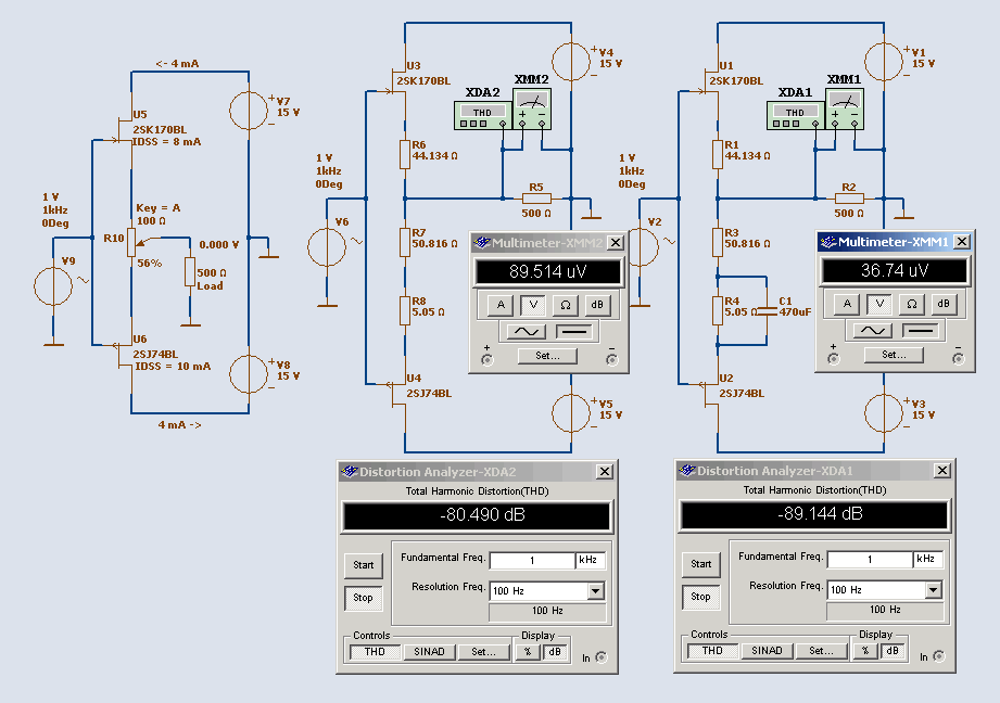

I like to get a G.Kleinschmidt, Scott Wurcer, John Curl or Bob Cordell comment on the following fenomena.
Complementary JFET input Stage.
I have found a trick to deal with it.
I call it Lineup JFET Cap compensation
I have found out .. on my own.
Because I do not read technical literature about transistors.
2SK170 + 2SJ74 are almost complementary.
At least there is a 'sweet spot' where they cancel even harmonics.
I have found this spot is Not at same VGS for the N-FET and P-FET.
More closer to when the N and P works at same current I-DS.
The practical choice of making Practically this means making both source resistors equal value.
And run this complementary at same current level.
This also means, that using a potentiometer as divider between such pair, in a 'wrong way',
can create even order distortion of considerable magnitude.
Three circuits to demonstrate this fenomena.
And the one to the right, is one solution I use, to compensate and make them N-JFET and P-JFET work in
Complementary Harmony.
I post some harmonics difference in next post.
Regars Lineup

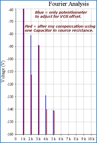

Here is my comparing FFT analys.
Before and after one such my Capacitor Compensation. As I call it.
In this case was a difference of -32 dB for 2nd order harmonics!.
But quite often there are improvements at like -10 to -20dB level.
These are very high magnitudes, People!
My CapComp Trick.
This allows for ZERO DC-offset adjustment and still cancels out even order distortion.
Making the 2SK170 / 2SJ74 Complementary input/pair work at as low distortion as possible.
A hookup is, that you probably need some distortion measurement device.
Unless there are some mathematical way, by just measuring VGS or whatever.

Here's a final image
to illustrate the case I am enquiering about.
Regarding Complementary JFET stage adjustment.
The difference is that The AC-Coupled version
runs at equal current, for both N-JFET and P-JFET.
This gives the lowest thd distortion level.
Reduces even order harmonics considerably.

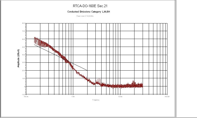

Terry Demol said:
What sort of spectrum did it transmit?
Here is the spectrum of the "buzzing relay" induced conducted emissions on the power line as measured by an RF current probe and EMI receiver, measurement band 150 kHz to 30 HMz. Vertical axis is dB above 1 uA.
Best, Chuck Hansen

lineup:
i am not one of the experts, but a question for you if i may:
did you build real prototypes and test those? i would be concerned that you are tweaking for spice models differences otherwise ...
mlloyd1
mlloyd1
lineup said:Here's a final image
