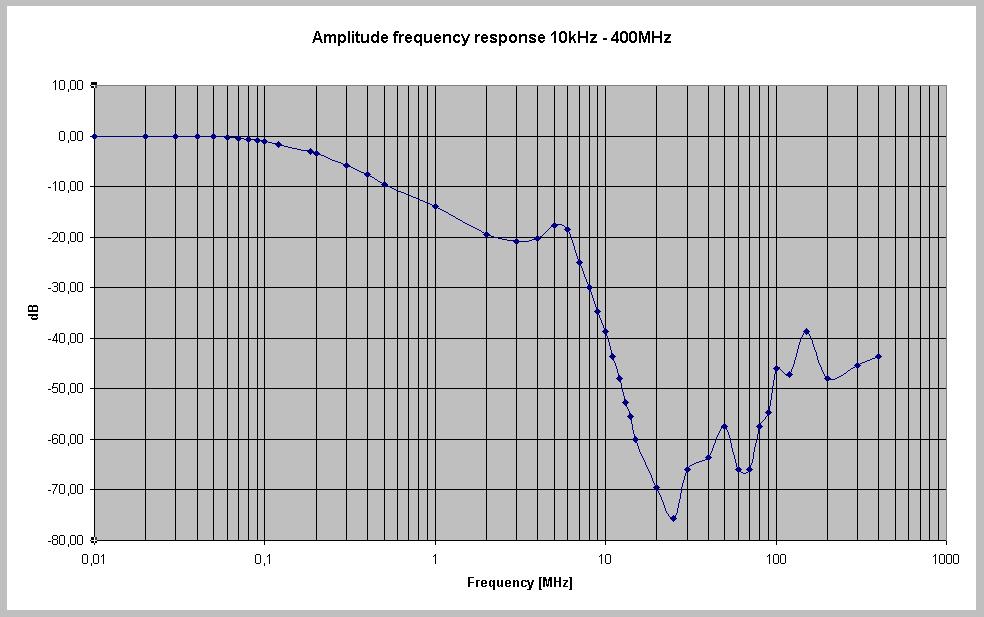

Should be stated that HF can bypass RC filters, and spread randomly thru system, depending on construction (wiring) and components parasitic impedances. Example of audio gear measurement:
This is absolutely right, and is the reason why the 49.9 ohm/100 pF combination should be placed right at the RCA jack. The use of a low-inductance capacitor is also important here. A 100 pF COG 0402 surface-mount capacitor would probably be best, but most of the time I use a miniature silver Mica.
