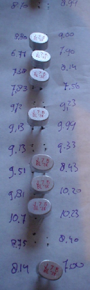

A stack of paper envelopes, standing upright in a box of the same size, keeps them tidy and easy to catch.
The Idss number is written on the envelope and they're closed with a paperclip.
Glueing a piece of xerox paper on anti-static foam of the same size keeps the parts safe in position, piccy=>

Hi Jacco,
I do the same thing that you do, except that I put them in drawers. Large amounts go in a bag together (one number to bag) and I sit down and sort some every now and again. Works for me.
