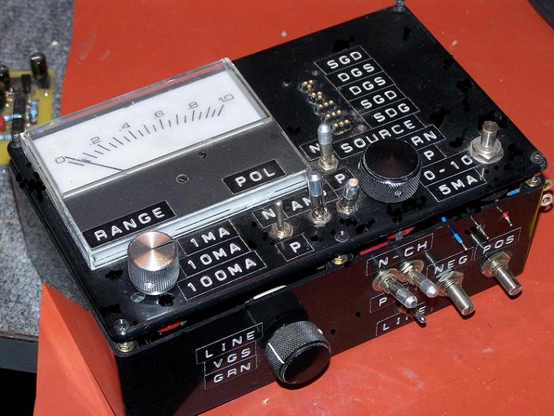

I've been waiting to see if there were any other comments on this. I do the same, I pretty much know what current I want to run and have a jig I built many years ago that lets me flip through and note IDSS, the pinch off IDSS and same at the the current I plan to run them.
I reason that this is important if I want the N and P-channels to respond in a similar manner.
Mike.

Good grief, Mike...you forgot the tone controls.
(Next time use a bigger project box. How the dickens do you get your fingers in there?)
